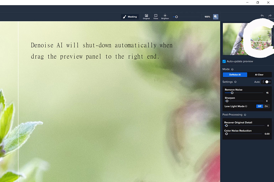

Denoise AI 2.2.9 will shut-down automatically when drag the preview panel to the right end side.

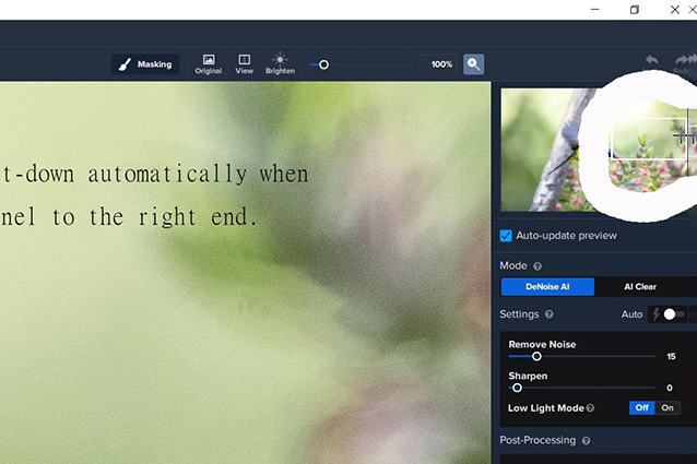

Actually on Windows it only happens when the app is maximized, try dropping it down by a couple of pixels on all edges like this and it will be OK until the fix comes:

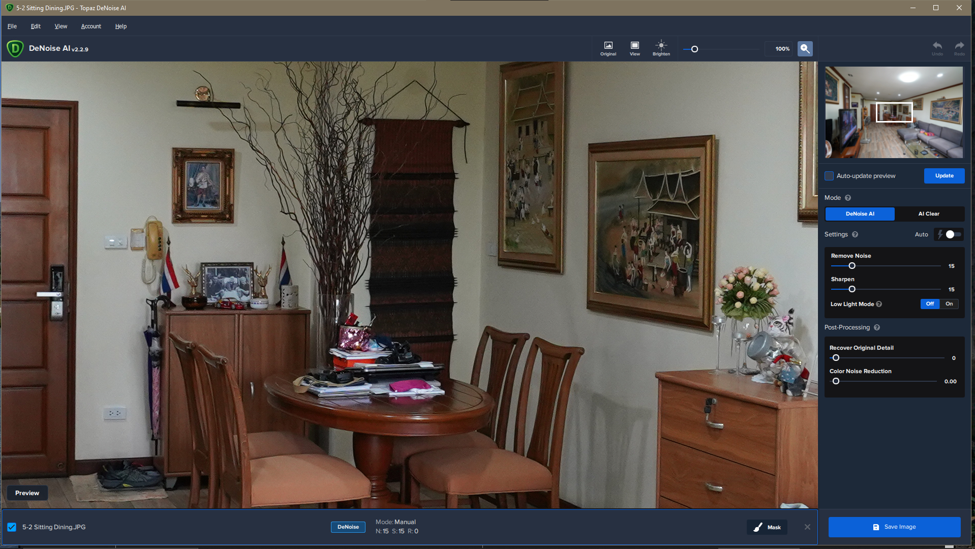

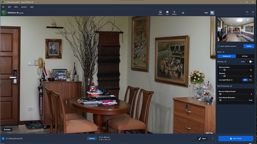

I just open Denoise AI as preset (100% preview), everything is okay if moving preview panel to left end, but it will shut-down when moving to right end only.
Confirmed on my system as well.
Can’t confirm as the problem is there regardless of the window size on my desktop.
