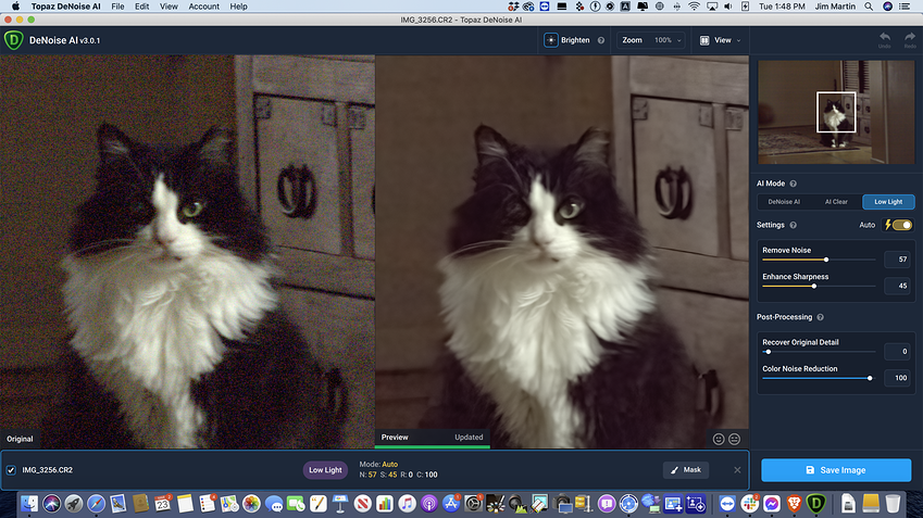

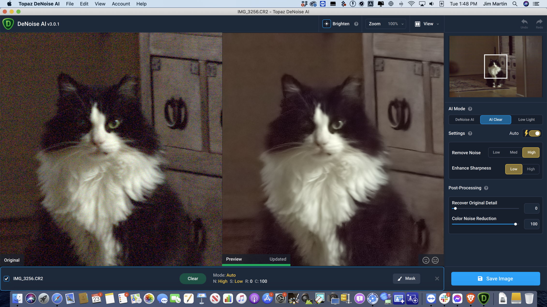

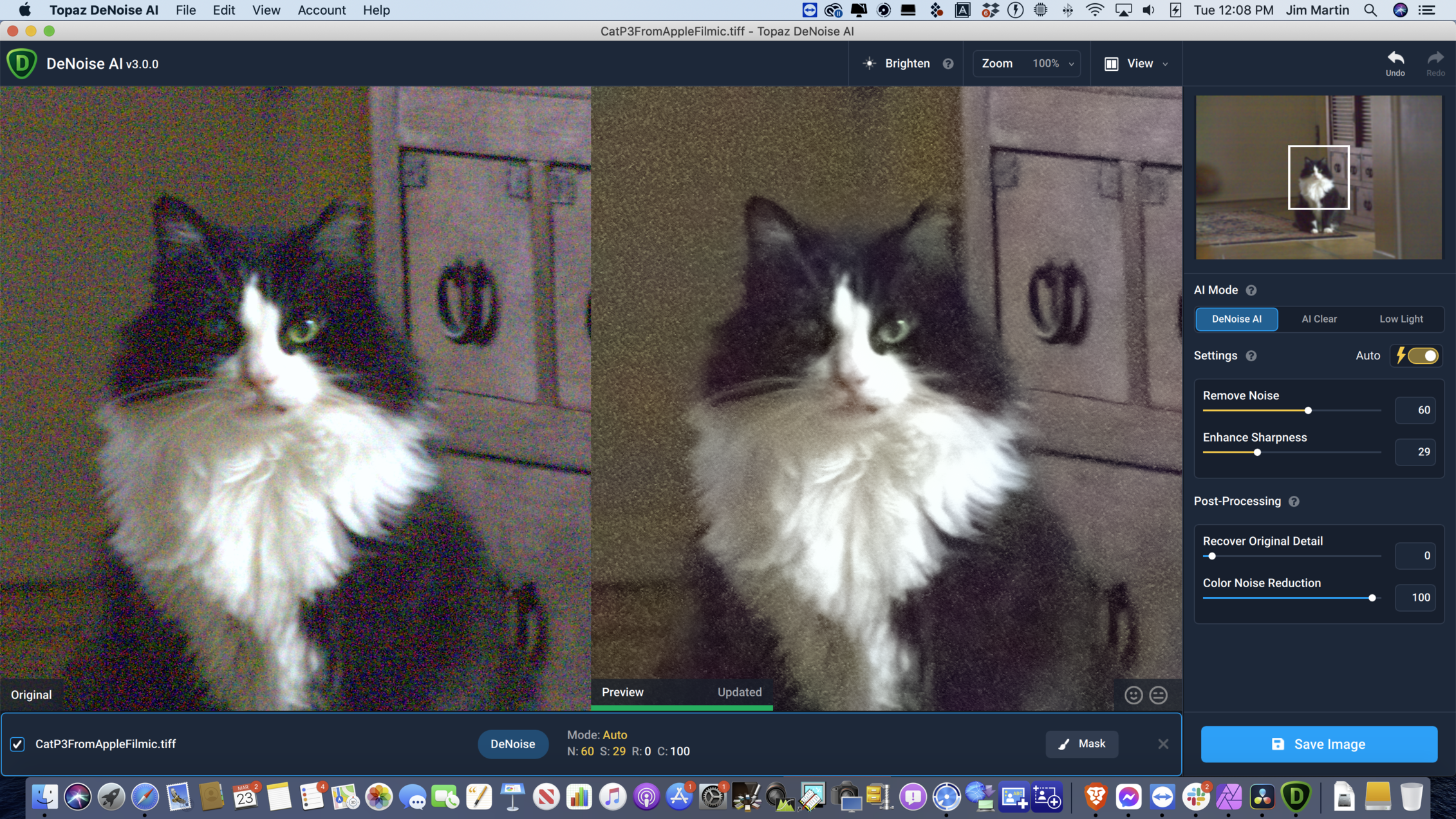

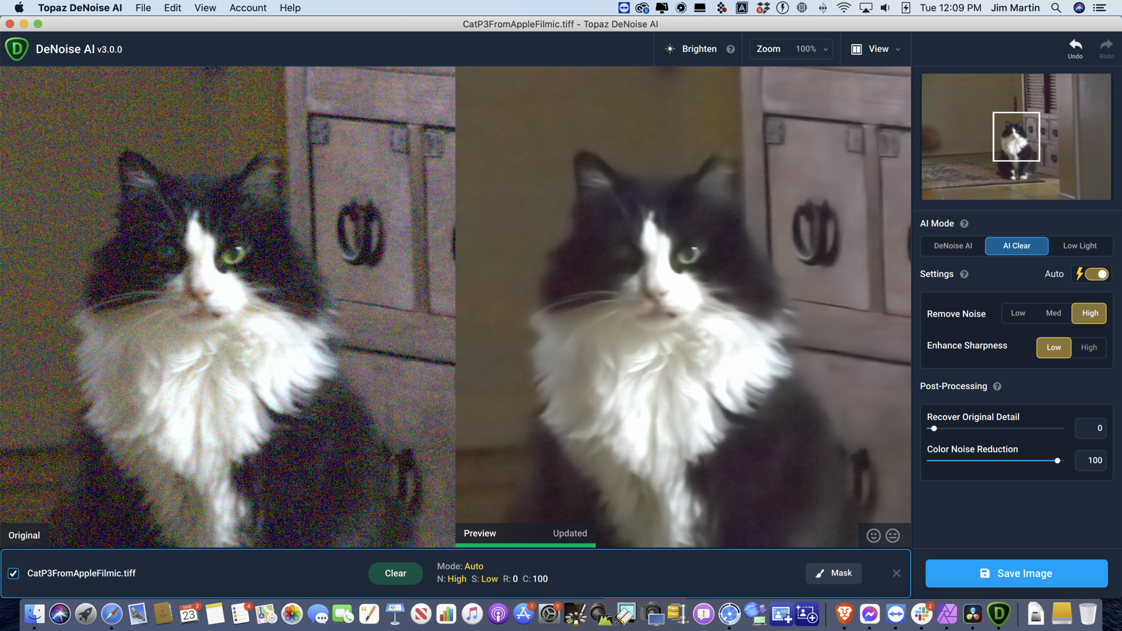

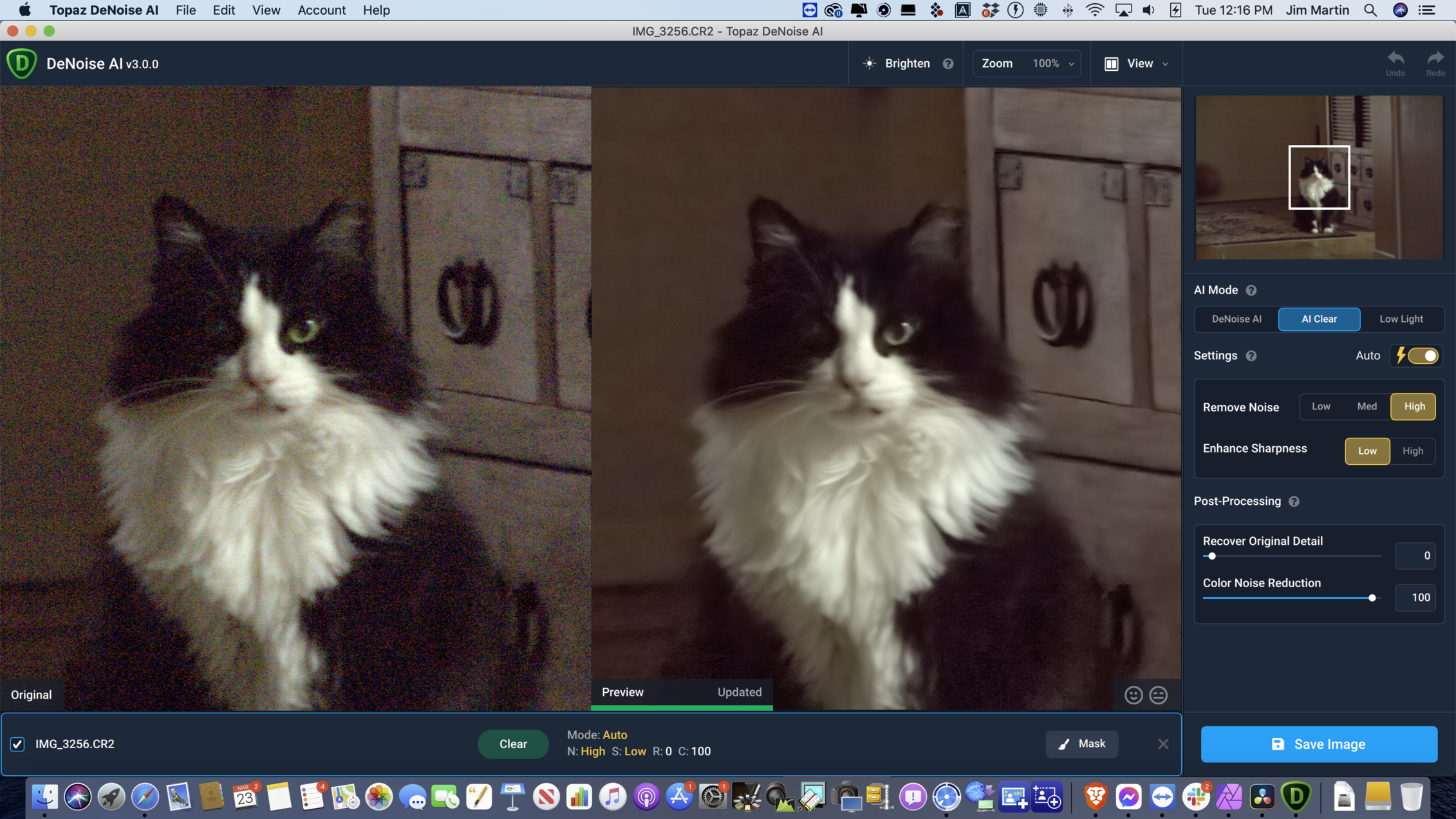

@amy.mae Photo Shows Difference Between AI Modes In Cat Picture From TIF.
Raw Camera Photo

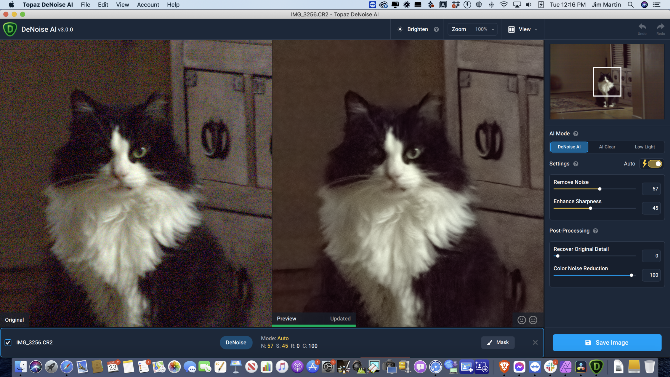

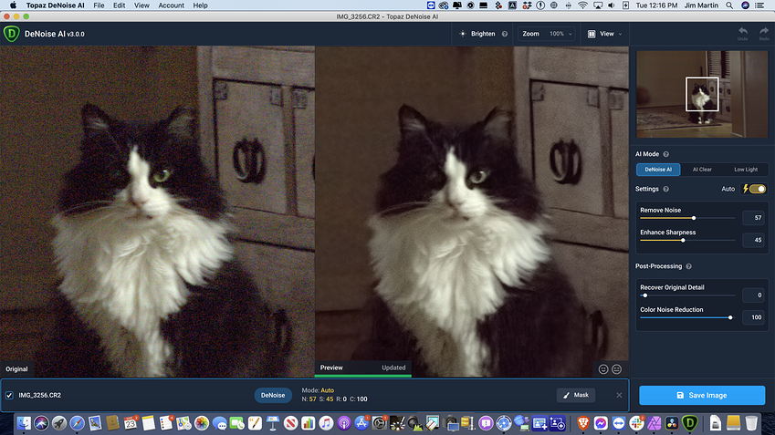

@amy.mae DenoiseMode Deems to have noise.
check your GPU driver.

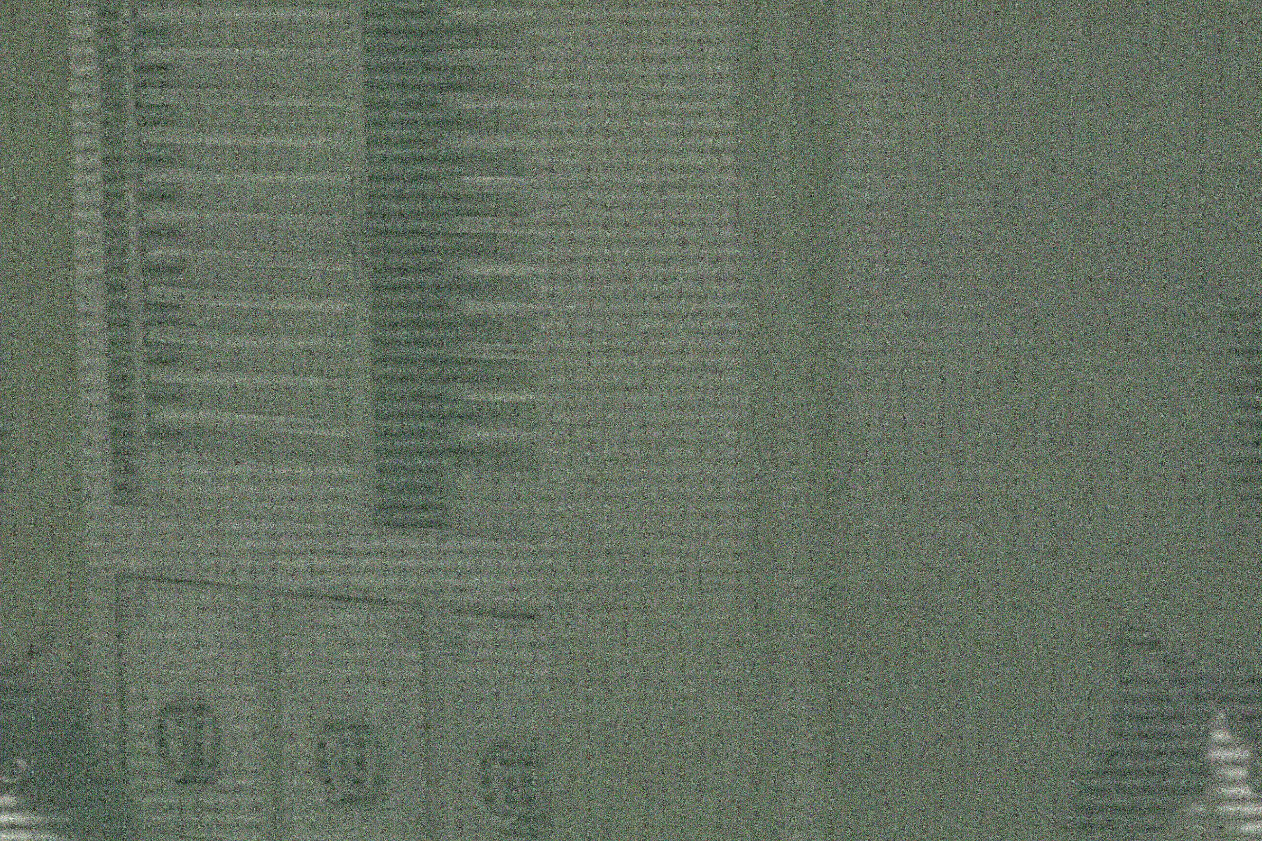

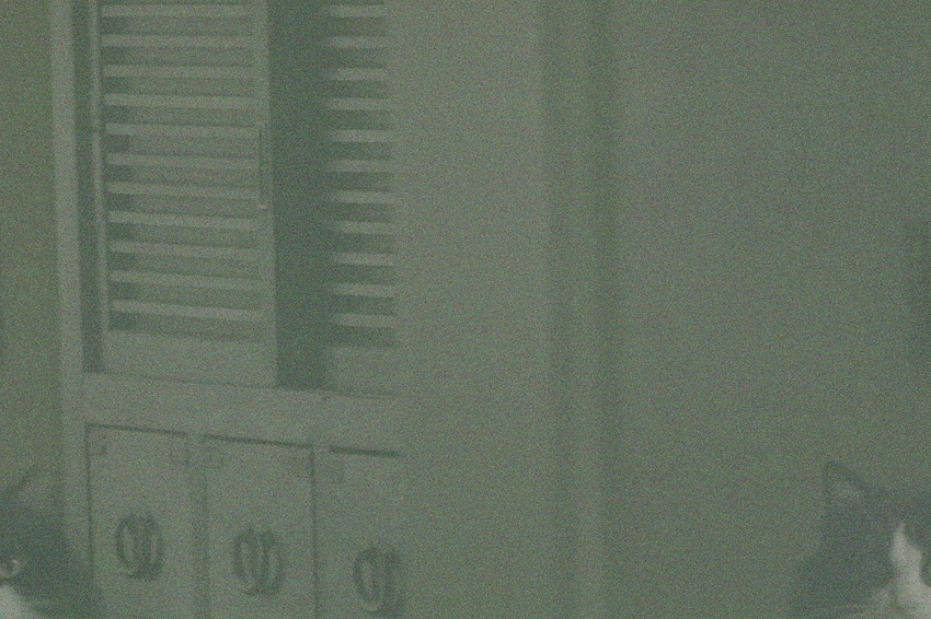

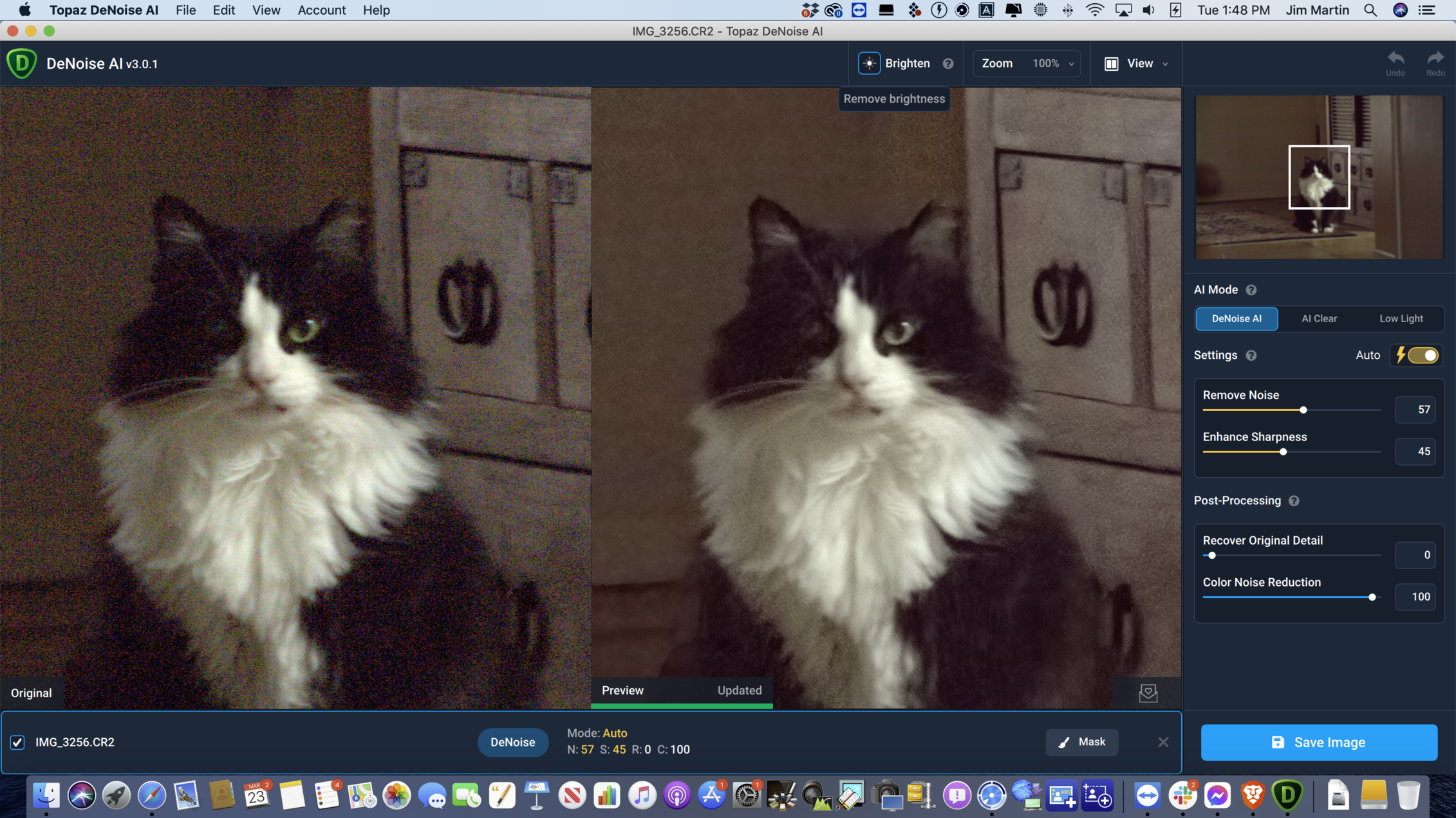

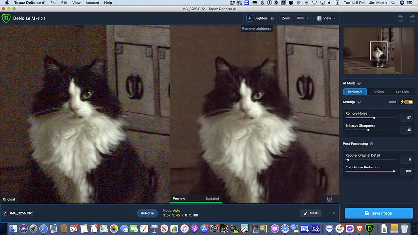

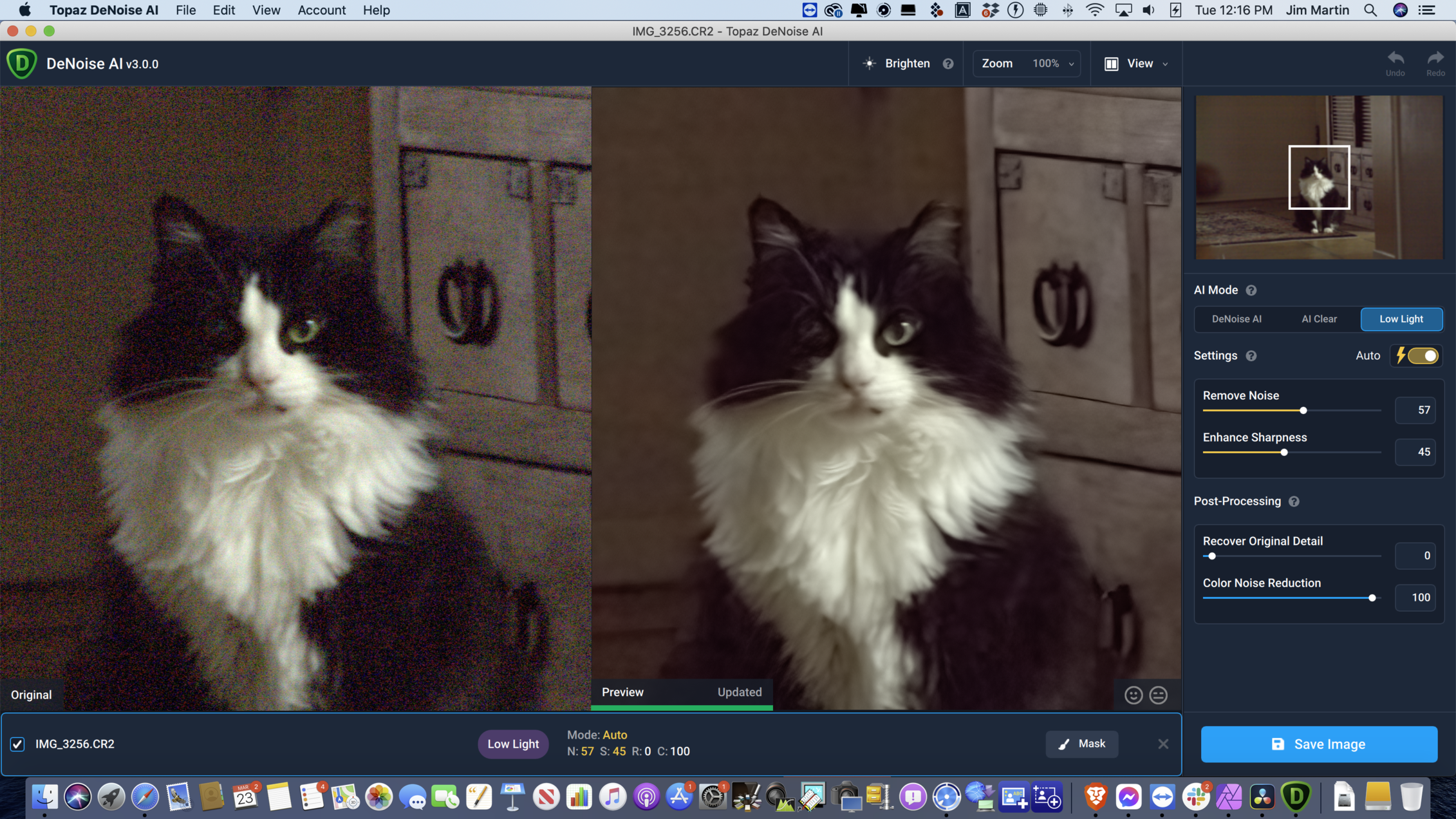

@amy.mae @brad.ito Denoise De Saturating And Miss Processing
Notice how Cat is Split.
@amy.mae @brad.ito IMG_3256 this link to the lib.
Unusable !!!
