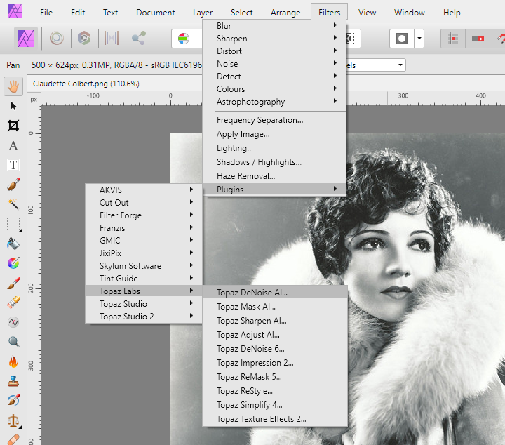

Yes, sometimes I use Topazlabs plugins with Affinity products (Denoise, Sharpen), but cannot use as plus layers, and Mask AI no generate mask layer to AP. :frowning:
Will photo shop plug-in work in Affinity?
Have Photoshop plugin, what can use under Affinity too (see my screenshot above).

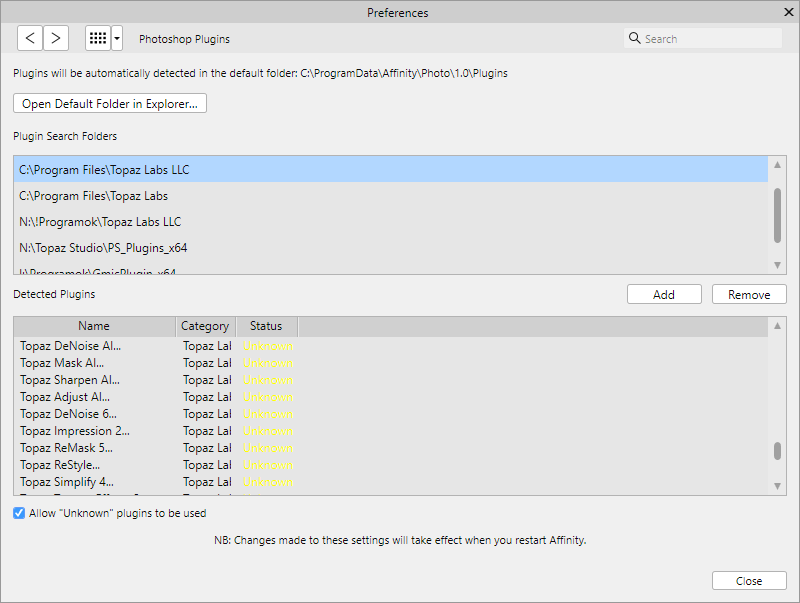

Add first and second paths to Photoshop plugins, and you get all Topaz plugins to AP, and test it:

I tested now with a DNG:
  • open a DNG with AP
  • develop this
  • after develop can use Denoise plugin and you see developed DNG file in Denoise, no original raw
