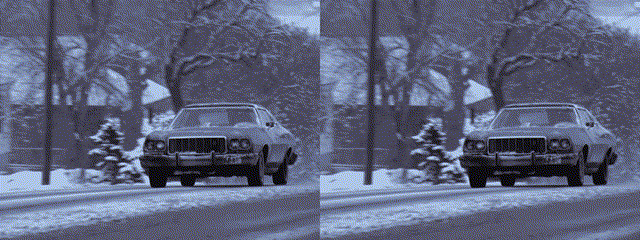

This was said to me not long ago, when talking about multiple in and out points:
I2_slomo_clippedD2_slomo_clipped
But the actual results are meh.
Did not saw your accurate returns
When used on documentaries, RIFE give me > results that Chronos/Apollo/Aion
Those last 3 have tend to generate horrible intra frames where as RIFE not but is slitghly more choppy
