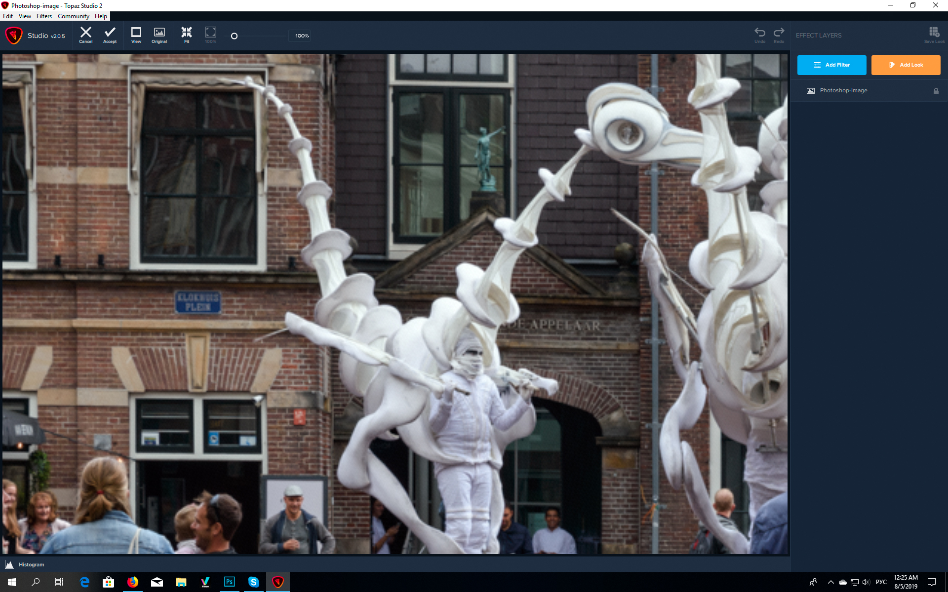

When I open any photo (16-bit tiff) in Topaz Studio 2 (plug-in of PS) on 100%, the image looks very blurry (before I use any filter):
Whereas the original photo in Photoshop looks very detailed:
It does not happen if I open the same photo in the standalone Topaz Studio 2 (or in old Classical Studio via Photoshop):

Same problem here. Topaz Studio 2 doesn’t work right as a plugin from Photoshop. Images are blurry and the adjustments don’t look like they should. When opening the same images with TS2 without Photoshop, everything looks fine. Using the same images, TS1 works fine both as a Photoshop plugin and as a standalone.

Same issue here, I can apply the identical settings in the Studio 1 and Studio 2 apps run as a plug-in and the Studio 1 version looks great, the Studio 2 version looks blurred. Looking at the files closely, there appears to be some sort of slight pixel shift going on resulting in the blurring. It looks like pixels are being translated upward by one pixel. If I enter Studio 2 and do absolutely nothing then no blurring occurs, but if I apply any filter, even with the settings set to zero (for example the curves tool without adjusting the curve) and then Apply to go back to Photoshop, the image is blurred. The blurring does not occur if Studio is run as a Stand Alone application.
