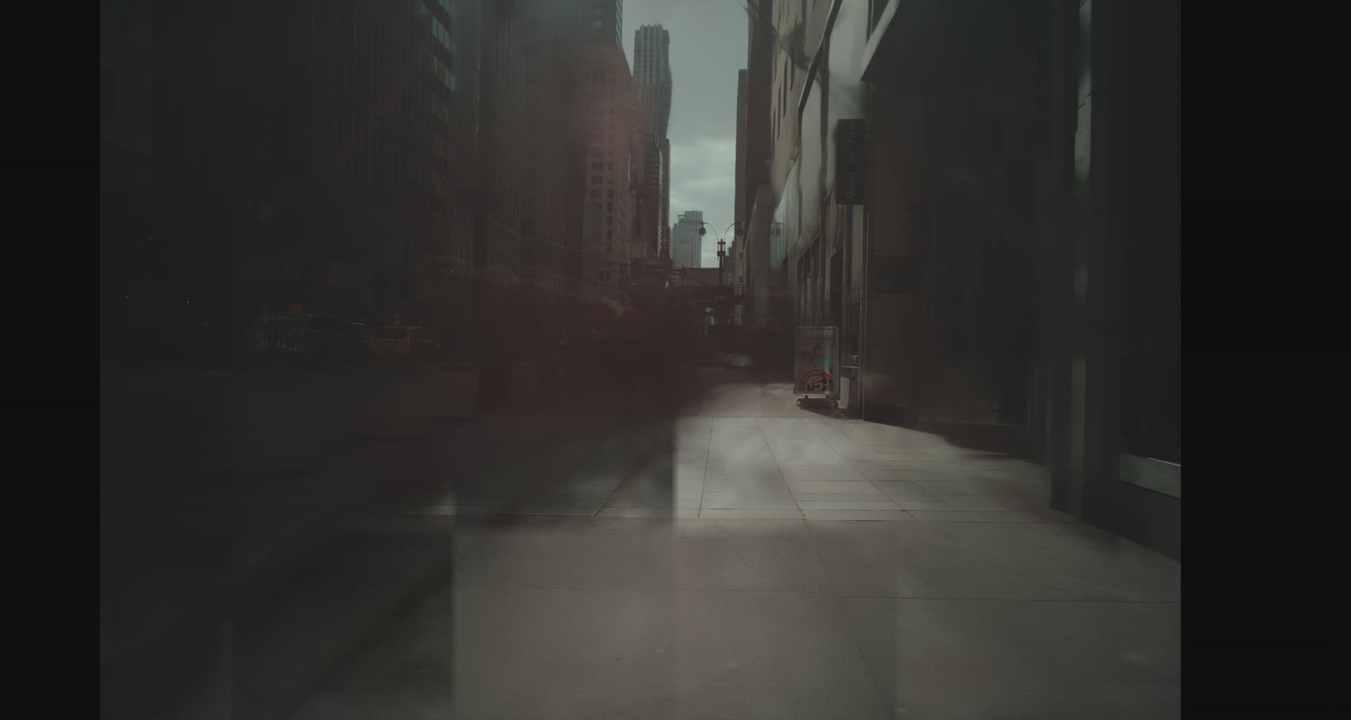

Whoa! Apollo (v. 3.1.9) suddenly starts to divide the scene up in odd squares at certain spots! It’s unsuable in this state.

I have the same issue with Apollo. Whenever there is different levels of brightness in an image, the image turns into blocks. I tried to flatten out the image in Resolve with a reversible gamma shift to see if that would solve the issue with Apollo, but it did not. Is there any sort of fix for this at the moment? Any tweaks I can do (in Topaz or ffmpeg)? The results would be exactly how I wanted if it weren’t for the blocks (all I need is a smooth transition from one “block” to another). BTW I do not see “Apollo Soft” as an option in v3.2.1 on Mac ARM nor when I tried v3.1.7.

In my test case the blocks only exist during transitions, not sure if it’s the same topic as this one. For my test case, I submitted twice.
