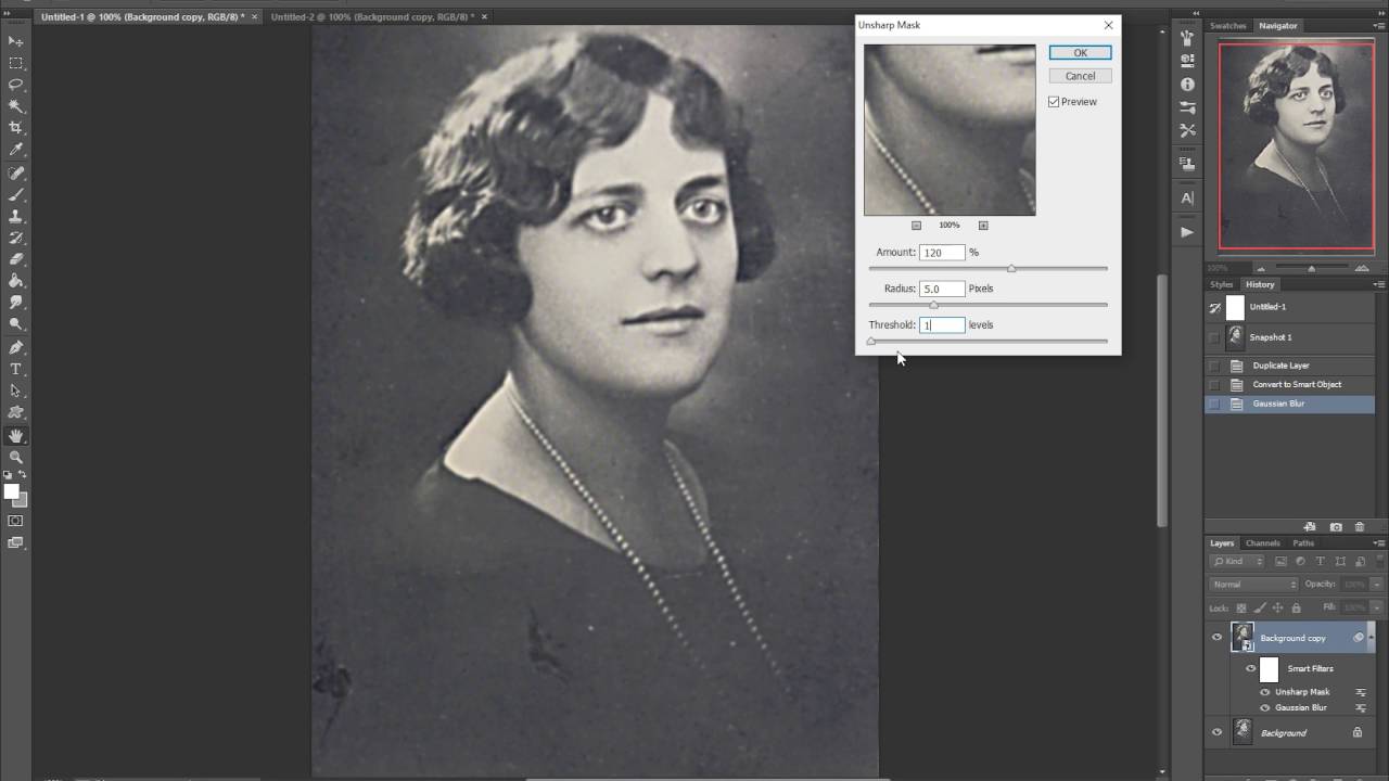

DeNoise AI did nothing to remove the halftone pattern.
I tried the approach in the video below, and it revealed that there is some large scale blotchiness from damage to the paper original. Unfortunately as you enlarge it with Gigiapixel the blotches becomes quite noticeable. Gigapixel also created some color variations that needed a desaturate to clear up.
Sharpen AI can be used once you’ve eliminated the screen patterns by blurring them, but it brings out the blotchiness even more.
aTest2
Thanks for taking the time Andy, it is really appreciated. Looks like this is going to be a difficult one.
