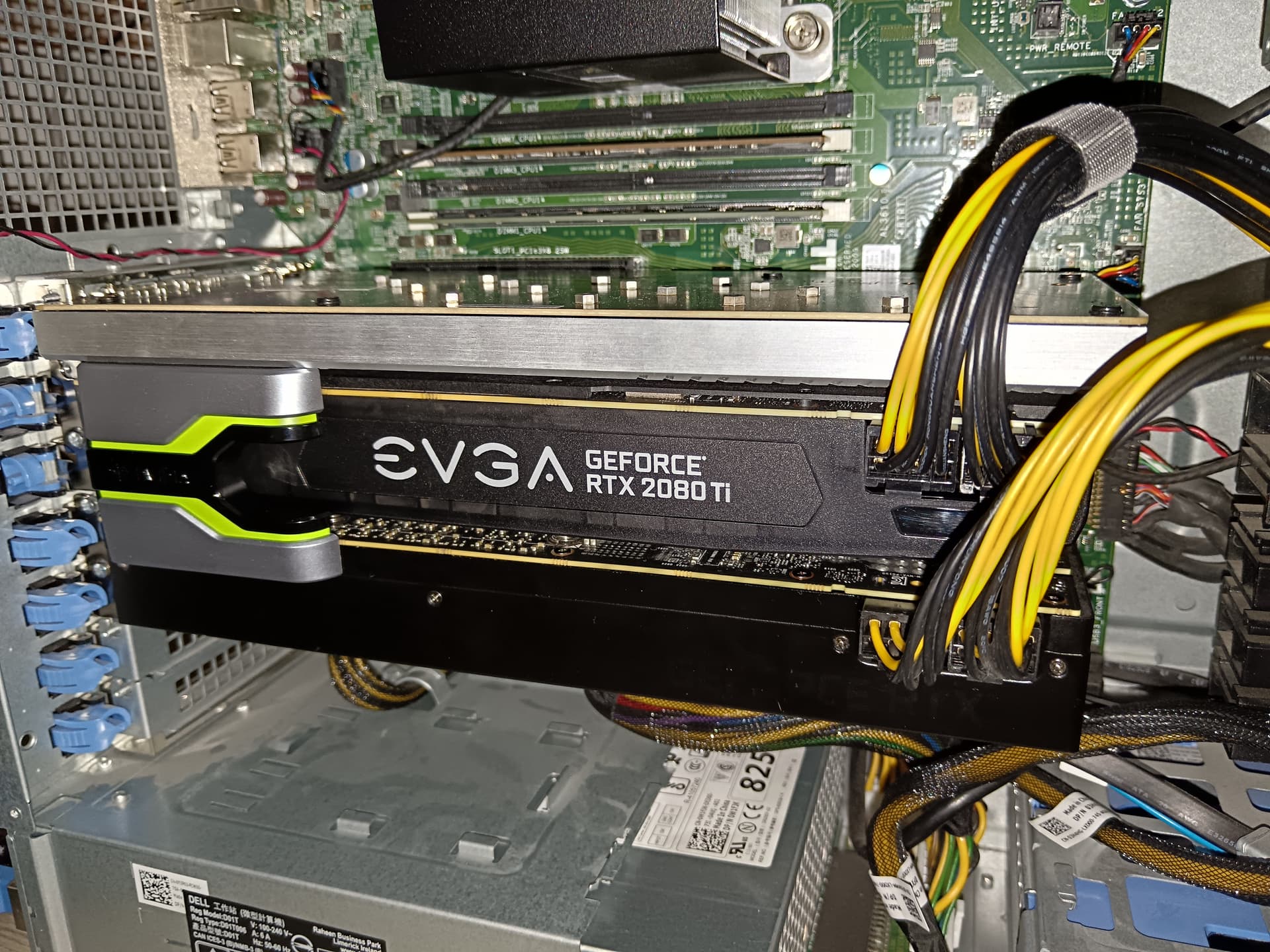

I have 2x2080Ti in nvlink with 70TFLOPS @ 320W (total) undervolt. One card for $220.
