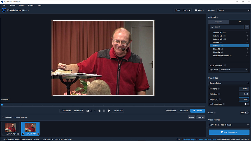

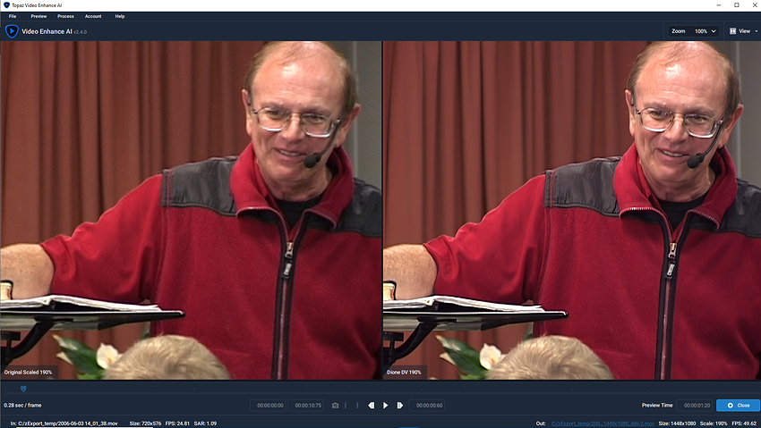

v2.4.0 crashes when I hit preview or start. edit: beta is doing it now too. Not sure why but it didn’t crash earlier.
Edit: I uninstalled, rebooted, reinstalled. Tried topaz ai with those settings with a different file and the preview worked. Then I loaded in one of the sample files I listed below and the app just crashes without warning. Could someone there try my sample file with the settings shown and message me when there is an update? Thanks.
edit: the bug has something to do with the way the pixel aspect ratio for PAL DV pixels is calculated. Because I took this video in handbrake and converted it to an mp4. and when I brought it back in it correctly cropped at 1440x1080 and then it didn’t crash. So the 1500x1080 I think is out of bounds somehow, even though the white cropping frame at 1440 and the .mov PAL file would crop off content.
edit: yep - I can process the original mov and it won’t crash if i set the output to 1448 x 1080 but at 1500 x 1080 it will crash and give no warnings nor errors. Note that setting the output to 1448x1080 so it won’t crash is not a good work around as I am cropping content that I’d rather not lose!
Dione DV / Bottom First
video: 576x720 PAL DV → 1500 x 1080 (scale 190%)
grain off
mov prores 4444xxq slow (but this doesn’t matter if I can it to reg. prores - still crashes)
here’s a link to two very short test file: (1.9 MB and 9+ MB):

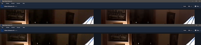

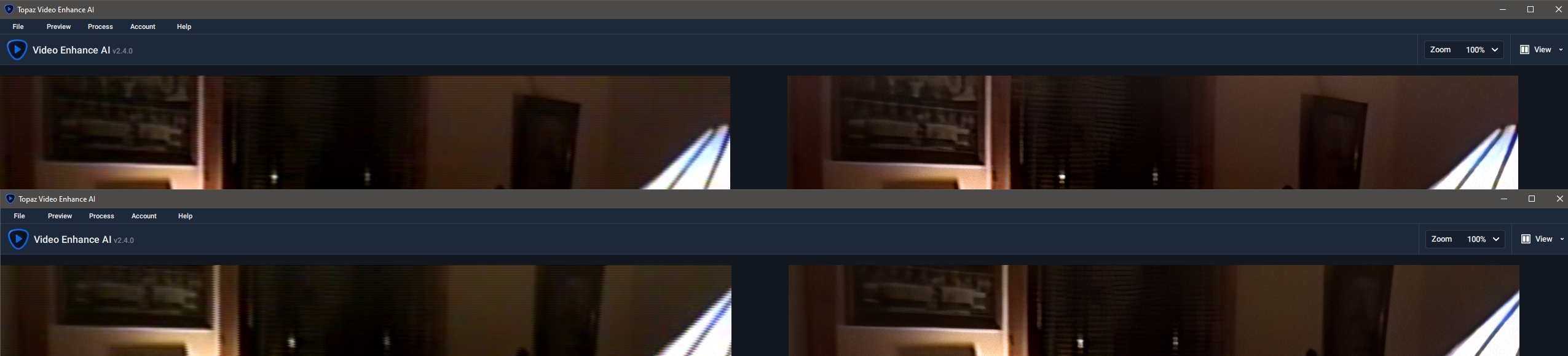

@taylor.bishop Been afk for a bit and have not had time to go through the beta/regular forum to see if it has been mentioned but I am noticing increased light flickering when processing low light video with multiple light sources. .
If you zoom in full screen and look at the two images at once; the top image on the right side has a natural warm sandy hue while the image on the lower right has a more washed out green hue. There is a minor flickering in the video however vaei seems to increase that flickering atleast 3x -4x. Thoughts? Dione TV V3.0. Otherwise loving the progress guys
