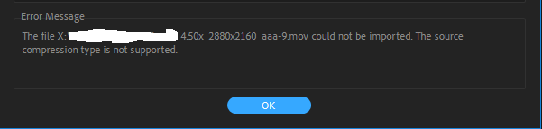

Anyone has this issue? I got more of this issue with Adobe since v.2.2.0 (sometimes) and v.2.3.0 (frequently).

Maybe the sound ? AAC in a ProRes MOV file is not standard and unusual.

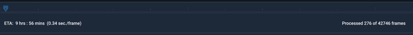

The ETA when using Proteus is way off and doesn’t make sense.
42746 frames times 0.34 sec/frame is a little over 4 hours. No idea why it says close to 10 hours. And before you ask the sec/frame number was only fluctuating by .02-.04
