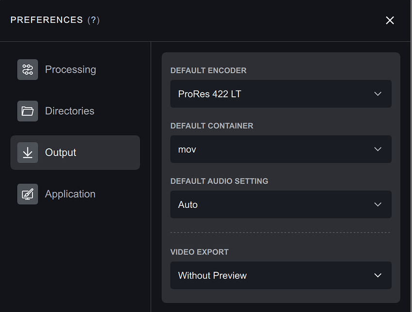

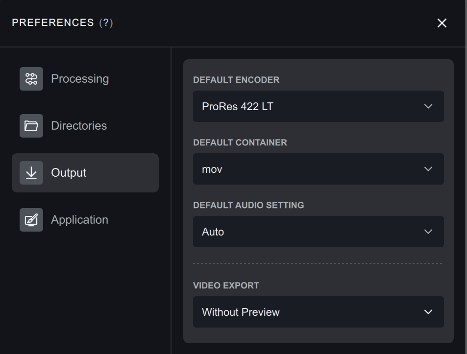

I turned off the export preview in “settings” and it did not solve my issue of dropping a frame or two at the end of the ProPres source.

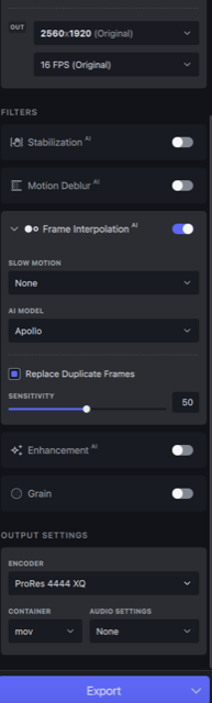

I’m guessing you’re asking what settings or parameters I use when processing and outputting stabilised clips from TL’ Video AI?
Please see below a screen grab of a scanned 8mm clip output at 2.5K. I also work in FHD/ 25fps, 2K/ 25fps, 4K/ 25fps.
As with TL’ Video AI, when in After Effects and Premier Pro my editor and I work with ProRes 4444 files, unless circumstances require compressed versions of these files.
I hope this helps.

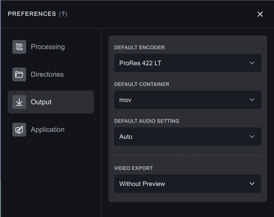

Turning off the Preview doesn’t resolve the issue. Currently the only way to avoid loss of frames is to add handles to a clip, then process in Video AI.
