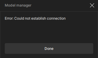

Ok, after rebooting my machine, I was able to download the models I needed. Except for the one for video stabilization. Every time I get the same error message after downloading 8/15 of the files for this modele.
This is very similar to the bug that another user had when downloading model files for stabilization.
Starlight mini downloads this time. At the time of writing, it is currently at 23% download.
