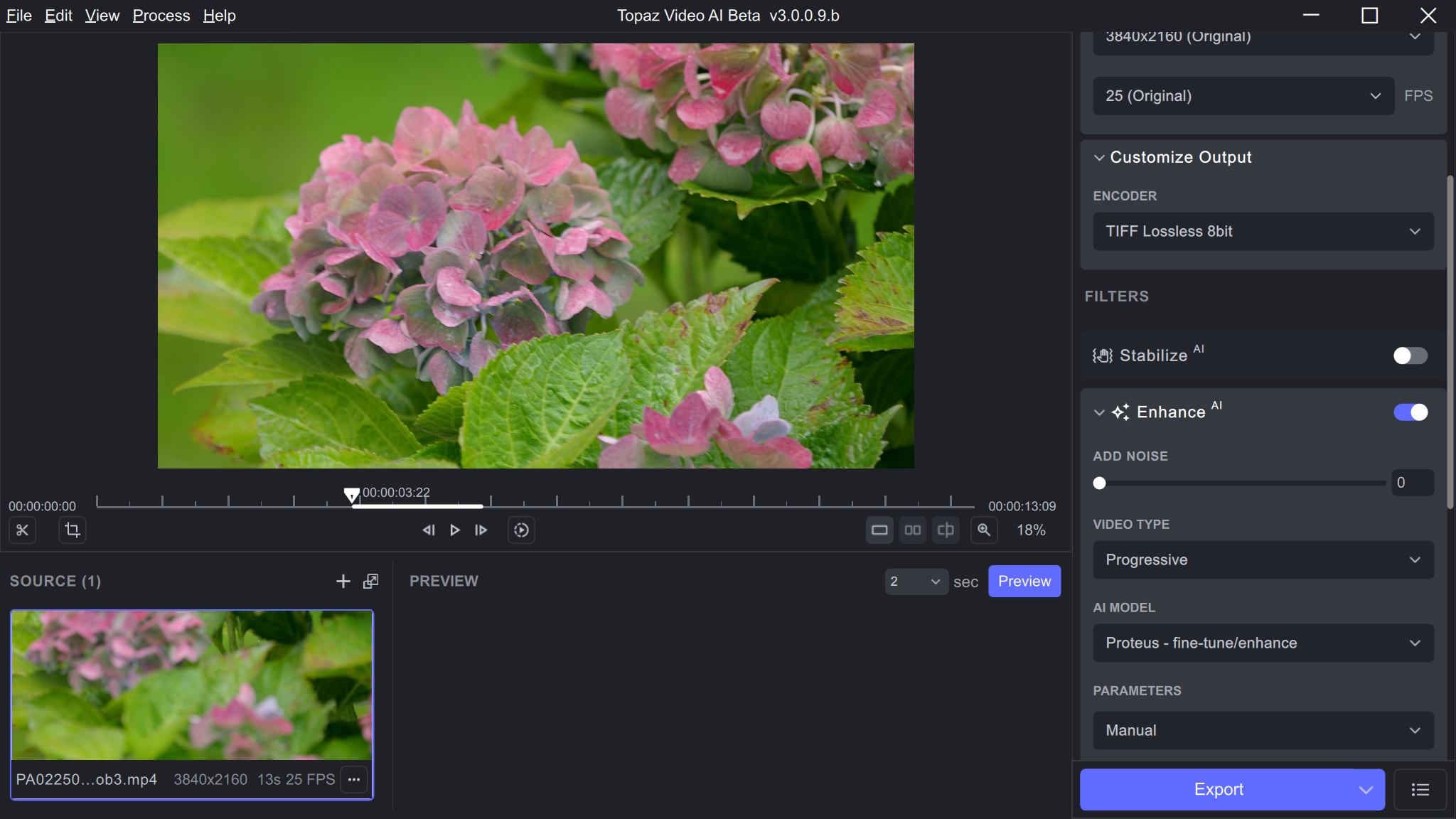

3-9b does not export TIFF or PNG, only empty folders are produced

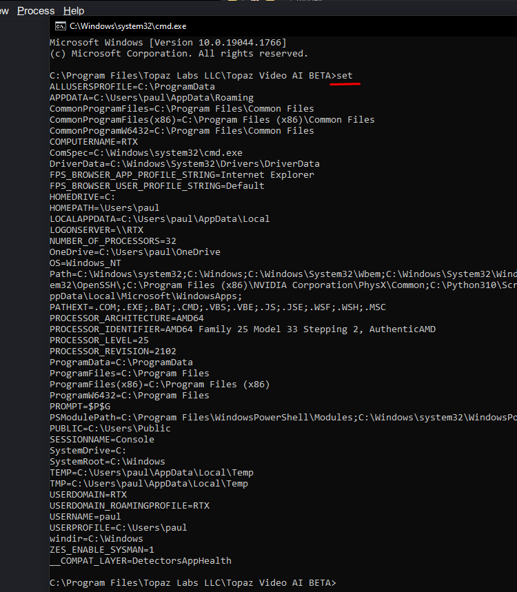

Shouldn’t it be
VEAI_MODEL_DIR=“C:\ProgramData\Topaz Labs LLC\Topaz Video AI BETA\models”
And check if the json files are there.
I tried with \models, it is not helps. JSON files exists. Same error.
Hi, could you try opening the CLI using the button in the Process menu? That option should automatically set both VEAI_MODEL_DIR and VEAI_MODEL_DATA_DIR correctly.
I was opened CMD from “Process → Open Command Prompt”. Window is appear. But env variables VEAI_MODEL_DIR and VEAI_MODEL_DATA_DIR is not defined here.
