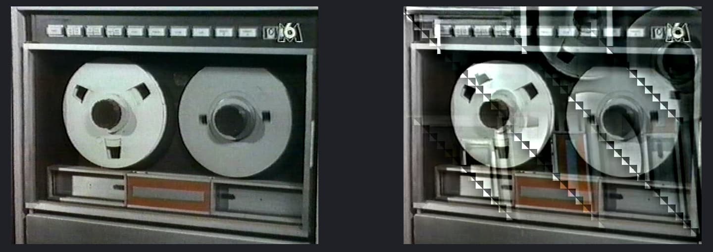

This is an old .avi file, just trying to use Proteus with default settings to clean it up, no change in size
Edit: files uploaded: L’Homme Invisible - E01 Rien Ne Va Plus
Edit2: I don’t see this issue when I set resize = 200%
