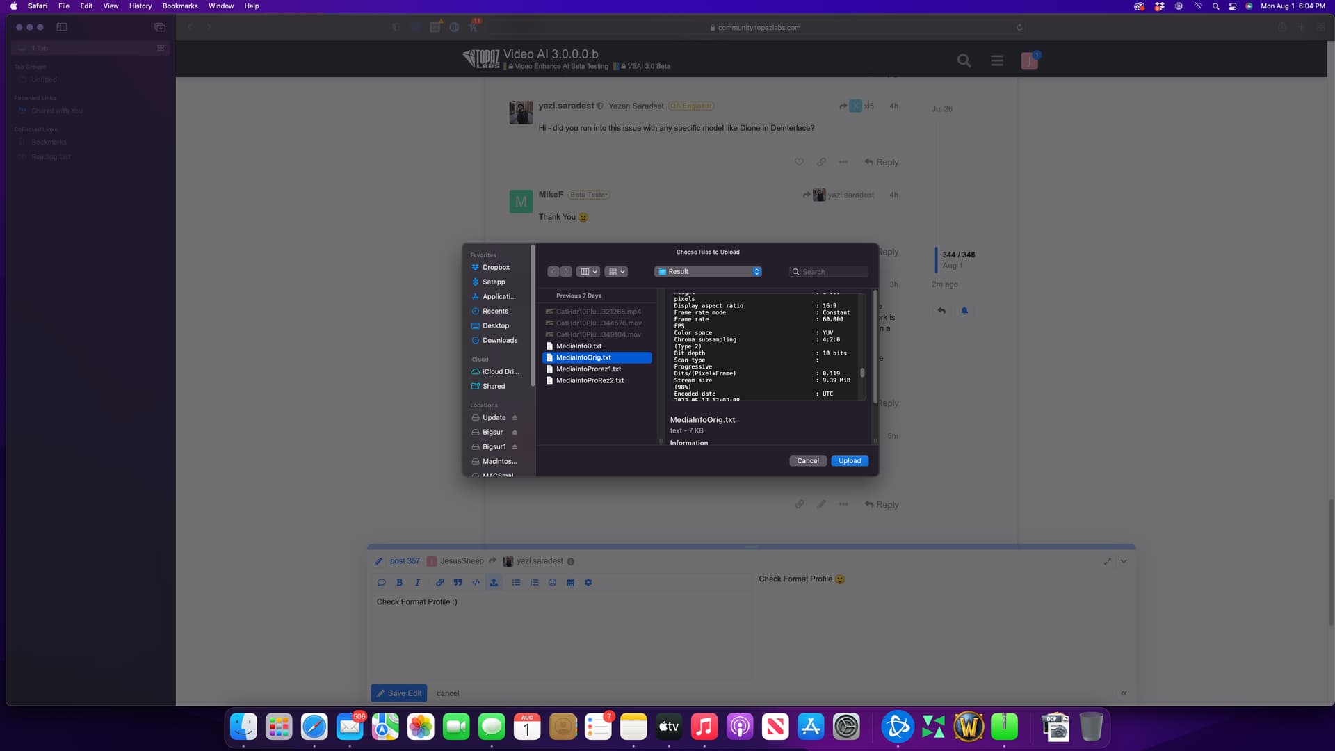

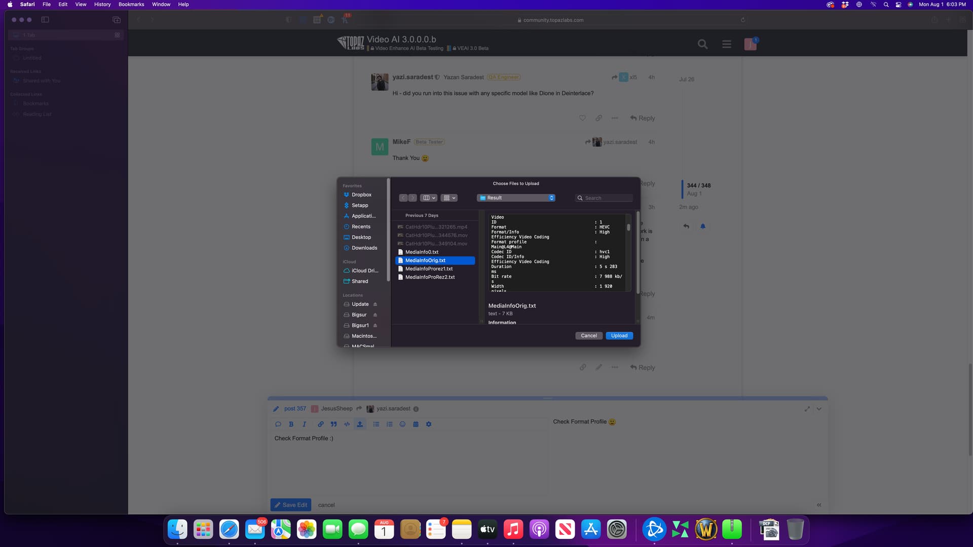

Check Format Profile :slight_smile:
Think you mat be showing Rec 709 10 bit.
