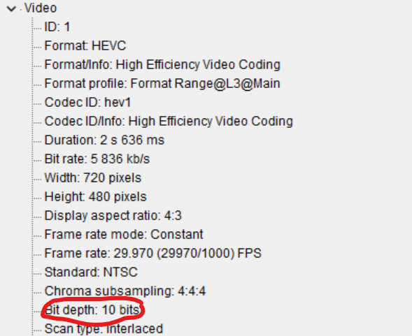

image (14)
Hi! Based on your logs and our tests it should be saving with H265 MAIN 10. Could you verify that in MediaInfo in Bit Depth via View > Tree?
