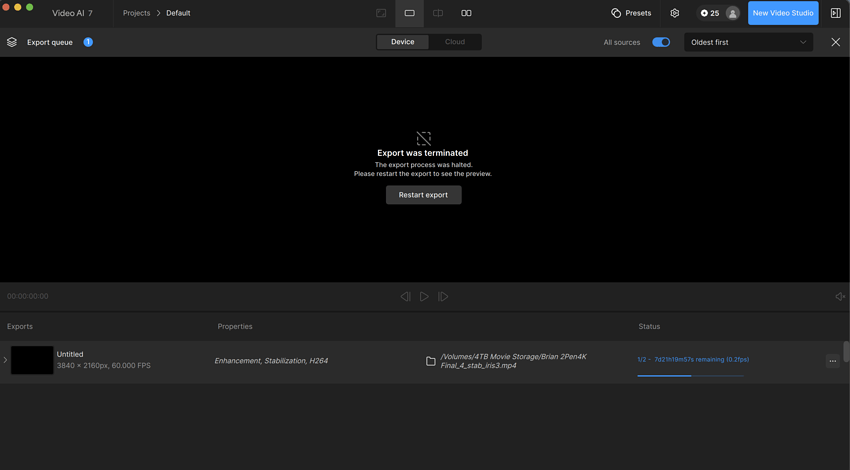

Topaz VEAI has been running very slow for a couple of versions now and processing my videos is taking just way too long 5 to 6 days, 0.3 frames per second. What can I do to fix. I am processing 4K 60fps but HD is slow also text will be hidden

Logs are showing you are running two models (Stabilization, and Iris) with the Focus Fix feature set to strong. That means the app is downscaling the file by a factor of 4x and then upscaling to 4k while running both of those models and your system has only 16GB of RAM. This will produce a slow processing speeds as that is a very heavy task.
At times in the logs, the processing speed is around 40fps, but then it dramatically slows down for the stabilization as it goes through every frame of the 48 minute long file.
Thank you Kyle. Very useful info. I will reduce the load as you suggest and see what that does.
