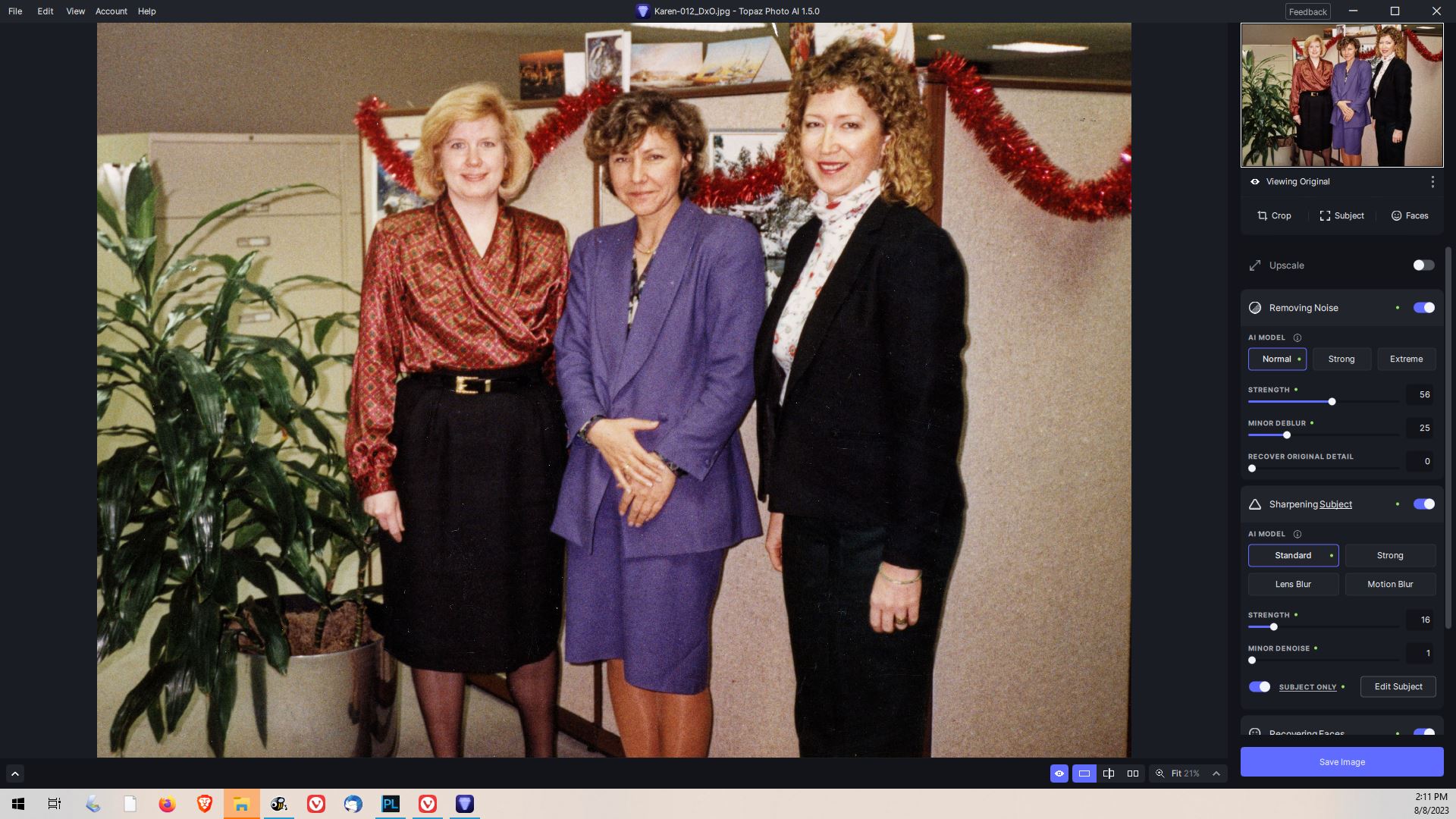

Attached is the before and after using TPAI 1.5.0 under Win10 - the problem white specks present in the black areas of the women’s clothing. Trying to boost noise reduction makes no difference. The problem is isn’t apparent when the background color isn’t black.
Processed
Original:

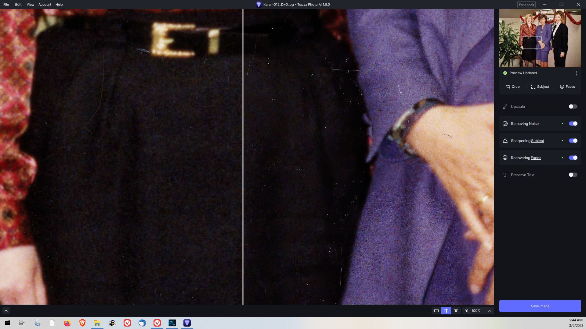

The problem is TPAI is enhancing them, IMHO, far beyond the expected result. The problem arises only on a black background.
If push comes to shove, I’d use PhotoLab to repair the spots. The scans were processed through PL 6 for contrast, color, and cropping before going to TPAI.
Yes use PhotoLab to get rid of the spots first. Note that Photo AI has never been trained on scans, only digital images, so it won’t see those spots as anything but details so noise reduction will not clear them.
My point is the TPAI response is out of proportion to the input, and there appears to be no way to dial it back. Whether the JPEG image source is a JPEG file from a scanner or a JPEG file directly from a camera should be immaterial.
100% scale comparison:

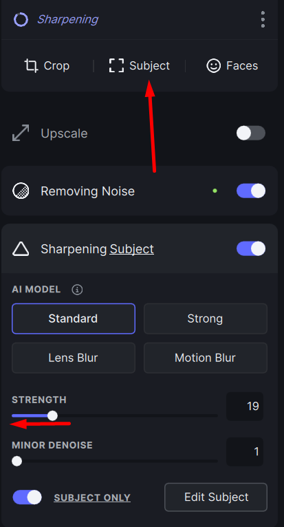

Try reducing the Sharpening strength. It looks like Topaz Photo AI is sharpening some white spots which exist in the original image and are standing out significantly against the black background.
You can also change the subject mask to exclude those specific areas from the processing.
Let me know if that helps you get a better result.
TPAI 1.5.0 defaulted to Subject Removing the black skirt, and black suit (using the subtract brush) made little difference. Reducing the strength to 1 was effective, but the specks were still more prominent than in the original image.
