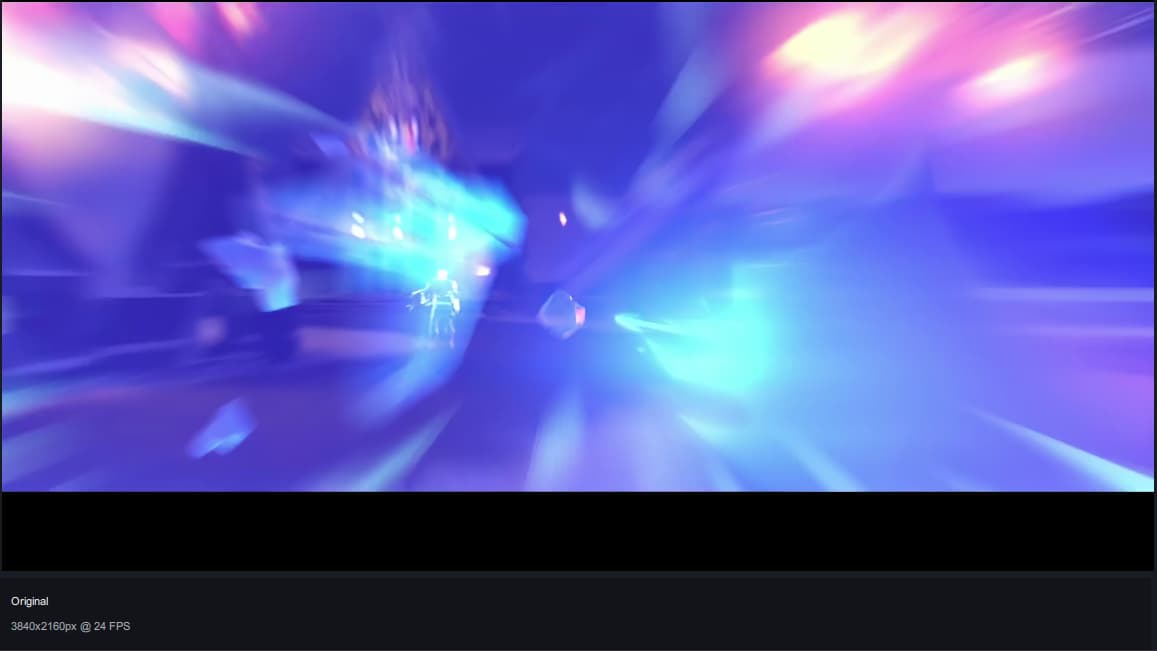

So latest version installed just fine for me. I again tried the same video from last version increasing FPS from 24 to 50 via Apollo v8.
Original:

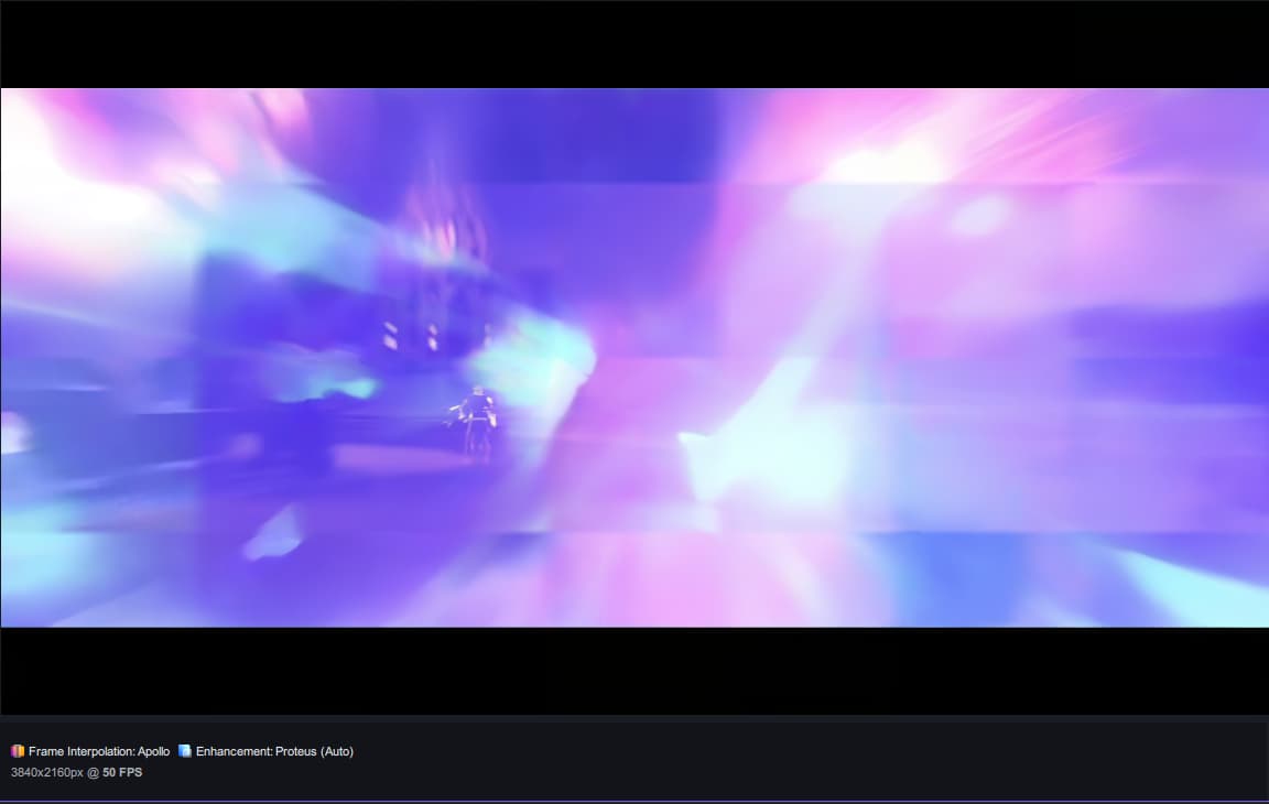

And here is the processed preview:
The massive blocks are present if I do not do proteus as well. (which was just auto for testing)

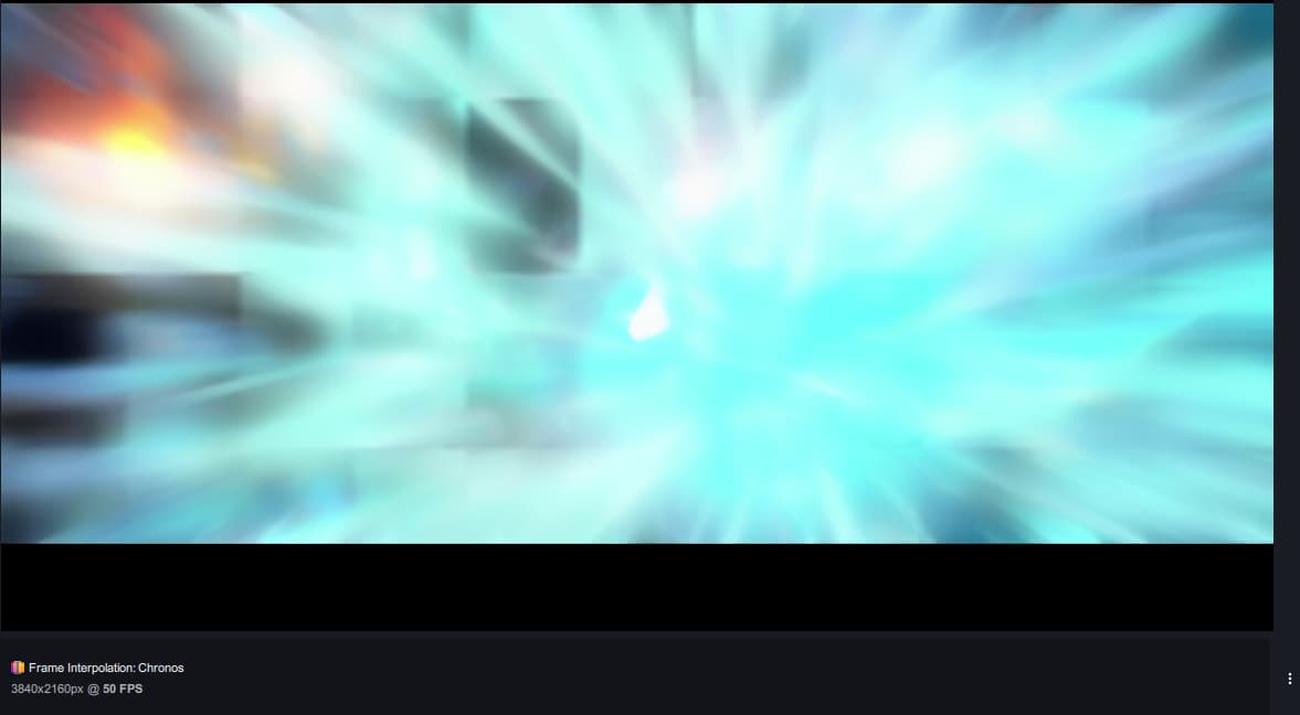

Same issues in Chronos v2.
