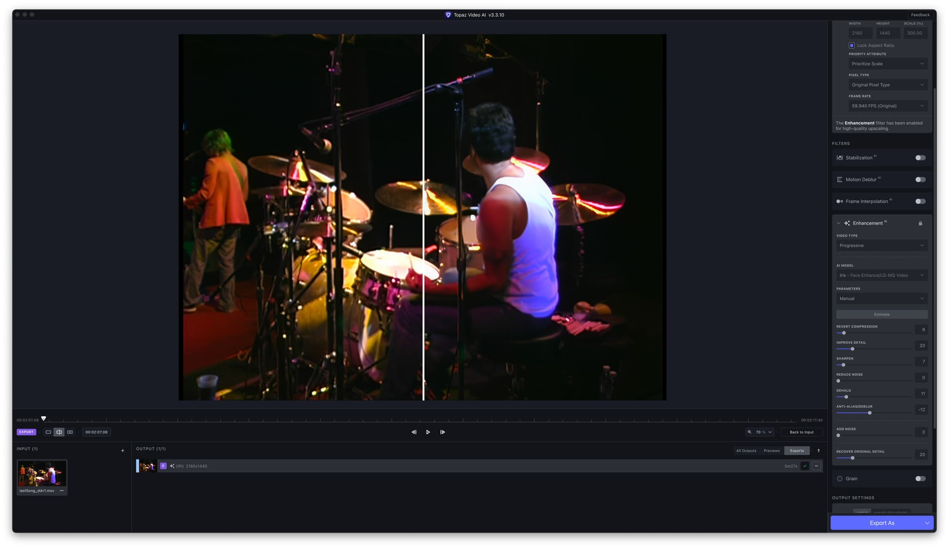

I have the exact same hardware specs. And I just previewed and exported a file just fine. Not saying what happened to your exports didn’t happen, at all. I’m sure it did. I’m just saying there may be other factors than Topaz in your case. I’ve attached a jpeg of my export settings. Thanks!

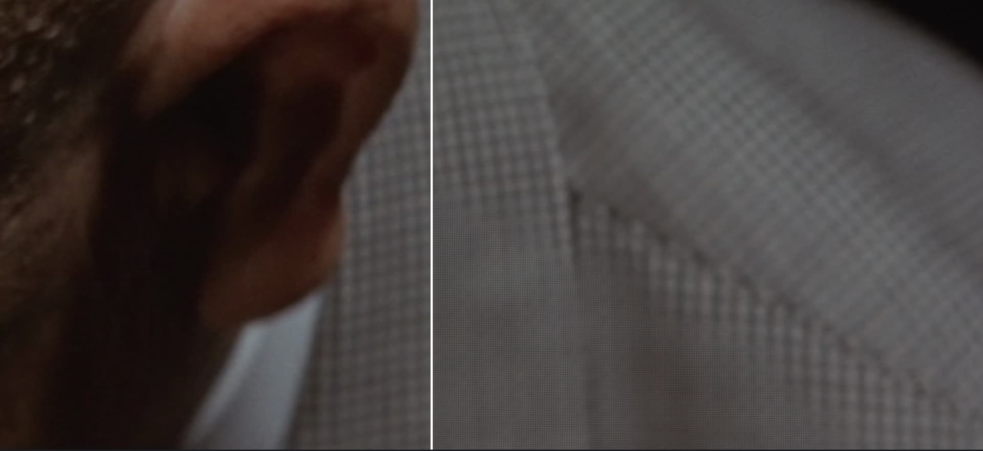

Are there plans for further development of the Gaia model?
It has always had problems with this type of texture.

Gaia is a ‘legacy’ model, so as much as I would like to see it updated, I’m guessing it won’t be.
Such abandonment of this model is a bit incomprehensible.
When the film is cleaned up properly, or even when you directly throw in a high bitrate DVD film, it achieves better results than the Proteus. The effect looks more natural and is much more detailed.
