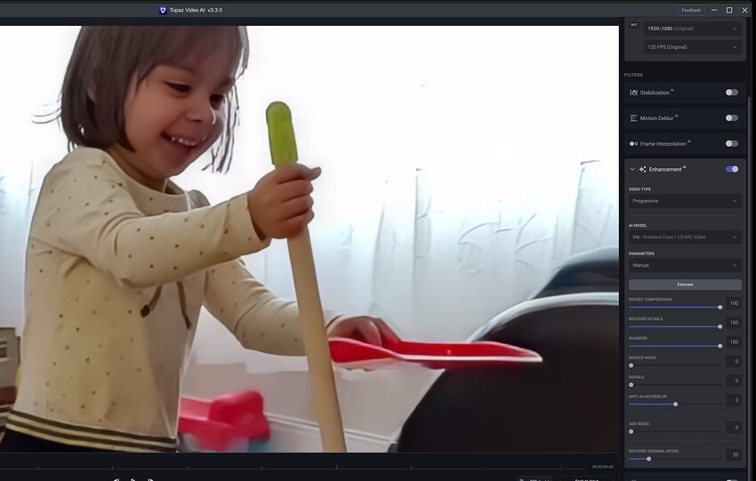

I’m trying multiple video edit with the new IRIS model. I can admit that the output is very good for low quality video around 480p or 720p.
However, the only slider doing a significant difference in the output is ANTI-ALIAS/DEBLUR and RECOVER ORIGINAL DETAIL. All other slider make a VERY slightly difference.
I’m I doing something wrong?
I see you have fps set to 120. Every time I try this the video starts off at normal speed, then slow motion. Not sure why that is.
That’s not the problem, the 120fps is the original frame rate for this video. But i’ve tryed around 20 videos already, all get this minimum amount of change when using the slider in manual or relative to auto mode.
