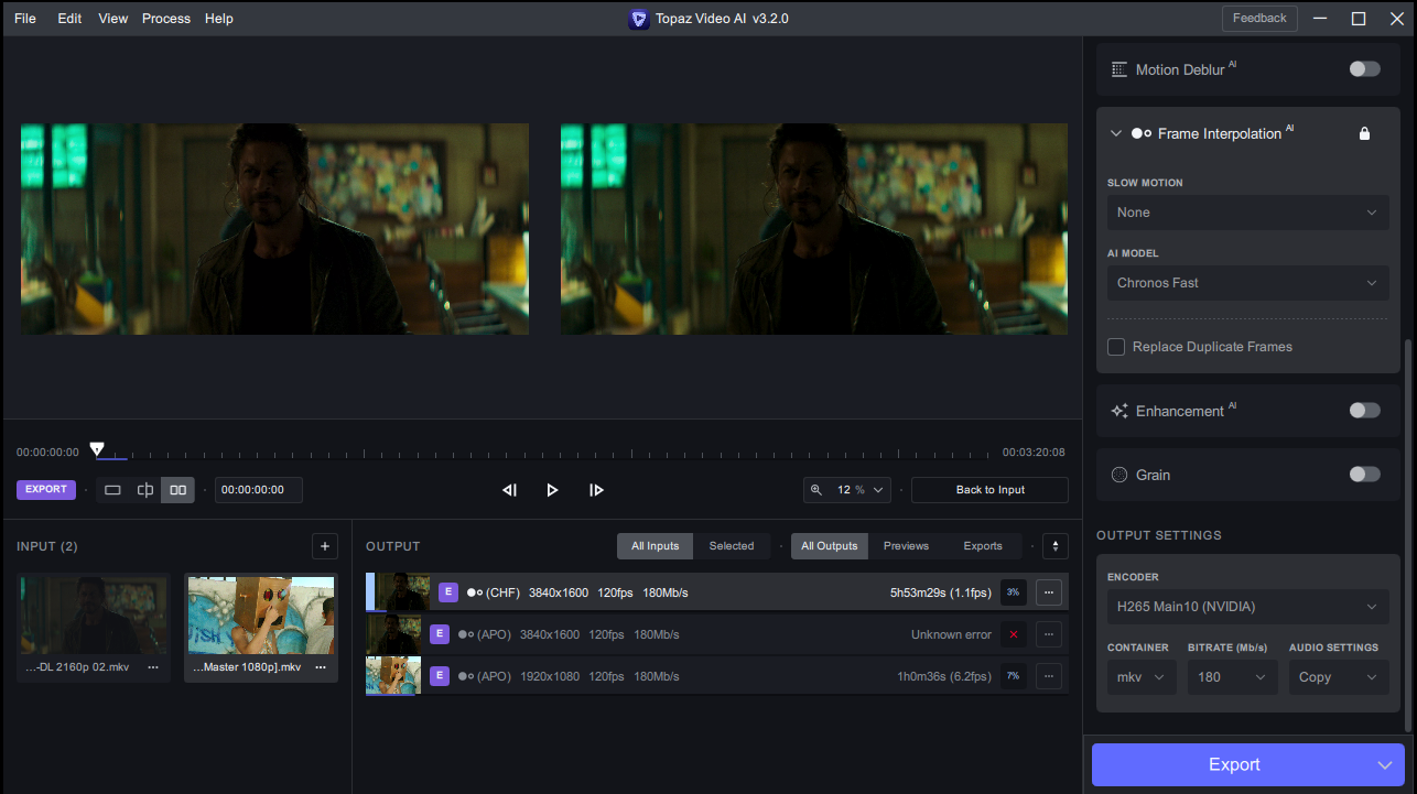

Reinstalled version 3,2,0. But I noticed that Apollo cannot increase fps in 4K video, although it increases it in 1080p.
I understand that it takes time to see how it works. But I have only one request. Just make the balance darker so that the video is not a little lighter on dark frames, so that it is like on the previous firmware. And remove excess noise (gain) when 1080p and 4K video is processed. Noise can be useful when processing low-quality video to mask processing distortion.
P.S. Apollo stopped increasing the FPS on video in 4K. Gives an error. On 1080p works!
I got Apollo to interpolate to 120 fps with a video upscaled to 3840x1600 (the same res it shows yours at).
You could try using the option to open the log folder and when you’ve finished your current work in the app, close it so it closes the log and open the last log and see if it shows what the errors were that caused the ā€œunknown errorā€ to be shown in it. You could also click on the 3 dots next to ā€œunknown errorā€ to see if it shows a shortened bit of info about what the problem was there.
Uninstalled the program. Reinstalled. Everything works!
