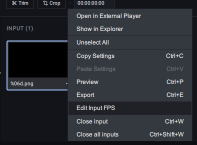

Not sure if this have been reported yet, but the source is a tiff sequence, the input frame rate cannot be changed.
I realize I’m doing PNG here, but it should be the same for tiff…
I’ve talked about Apollo’s problems, and I’ve talked about Chronos Fast’s. You keep emphasizing the problems with Chronos Fast, but the problems are substantially all there, and what you choose is ultimately a personal choice.
Thanks. Perhaps I wrongly expressed the issue. What I meant is that when you change the fps, the change is not shown in the GUI until you load another clip or close the software and start it again.
You seem to be replying to the wrong person.
