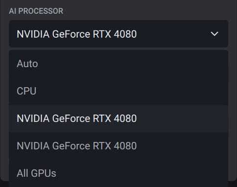

Also, anyone see this, duplicate GPU (I only have one 4080)…

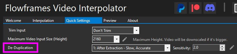

Remove duplicate frames can be done easily with FlowFrames.
It is a free AI Video Interpolation software with built-in Frame De-Duplication, speed compensation and scene change detection.
2023-02-11_112101
It can detect & remove duplicated frame automatically and regenerate those frame with AI interpolation such as RIFE (Real-Time Intermediate Flow Estimation). You can also adjust the sensitivity for Duplicate Frame detection.
