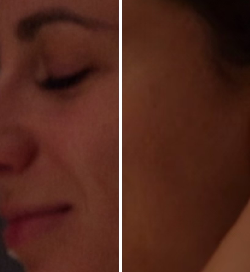

can you test the deblur model specifically. i Just re-ran a test using proteus and the colors were more or less the same. Id call it margin of error on my end for the color difference, being that the denoise can mush colors together somewhat.
But running deblur on that same section of my clip causing the colors to get a green tint.
notice the differences here. Its more apparent at full screen and wiping back and forth compared to looking at these stills. But its def there and it looks bad.
