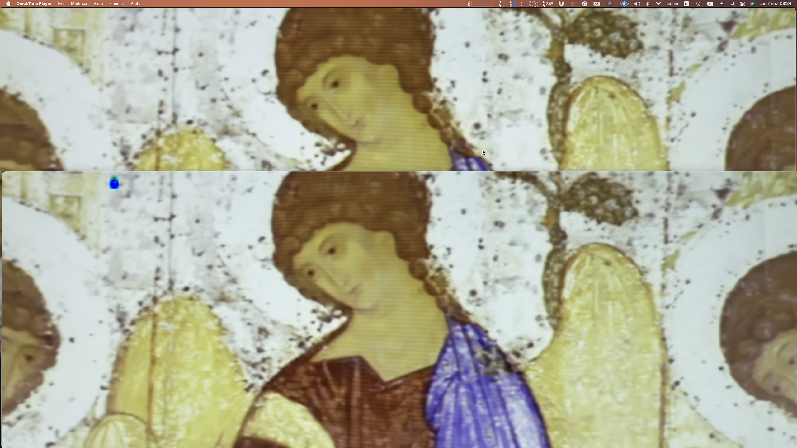

Of course, the quality of the input material is always a factor, but since they are now giving faces ‘special’ treatment, this makes for a different situation. The problems with ‘enhancing’ faces is usually at its worst when the source image is low resolution, and the faces are small within the context of the image.
Closeups or large images of faces tend to look good; or at least as good a pre-facial enhancement faces looked. - The problem comes with small faces. It appears that the enhancement algorithm finds little, indistinct faces and overdoes the enhancement, which tends to create speckles and blobs where the facial features should be.
As I mentioned in a previous post, I’d appreciate it if they would provide a way to turn face enhancement on or off, OR provide a slider to control the face enhancement sensitivity level.

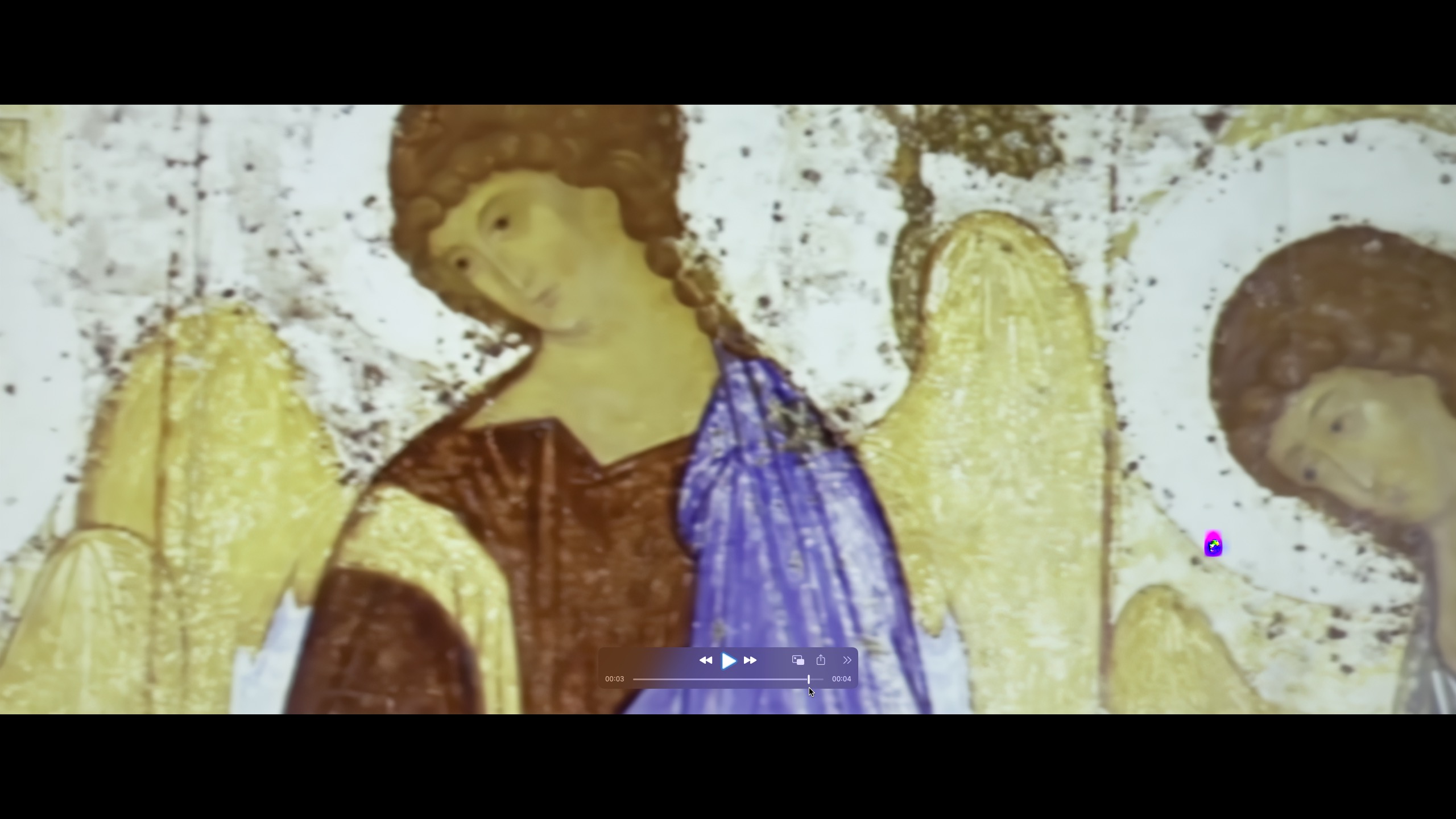

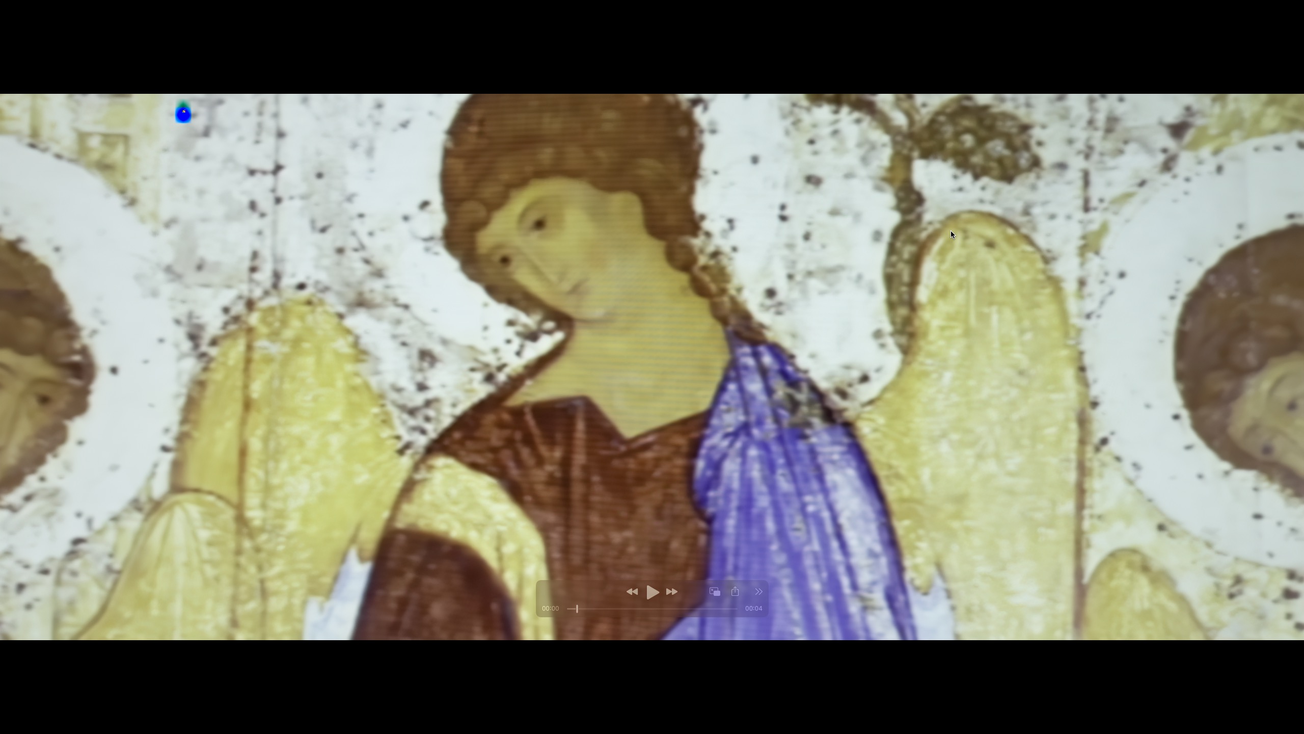

“… Closeups or large images of faces tend to look good; or at least as good a pre-facial enhancement faces looked. - The problem comes with small faces. …”
That is exactly what I try to document with my examples shown.
The videos I’m actually processing are originally produced by professionals for TV but squeezed by whatever (270,000 frames into 1,800,000 kB) into progressive 1280x720 format, and mp4 container. Off course it’s a challenge to rebuild original resolution and enlarge again, even more challenging when speed matters (0.3 spf mean up to 22 hours).
TOPAZ has proven AI competence in their photo section where subject detection and face refinement can be done successfully. Well, single image processing @ 11sec/image cannot be applied 1 by 1, but at least TVAI should avoid to invent speckles and blobs when it detects small faces.
