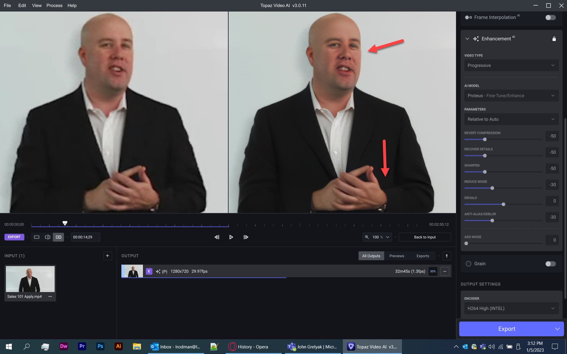

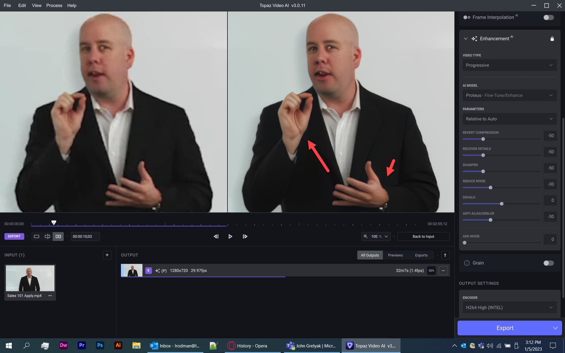

Hello, I am new here. I would love some help with settings.
I’m upsizing some 640x320 videos and getting some weird face artifacts around the eyes - usually due to compression - and some weird, plastick-y looking hands.
Still, an improvement.
Lower ‘revert compression’ and ‘reduce noise’ should reduce the plastic-y look, but I’m not sure if anything can improve the eyes.
