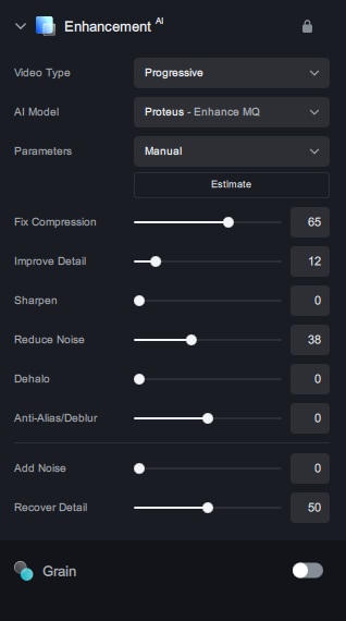

The parameters are all set to 0 for both Prob-3 and Prob-4.

Parameters are all 0.

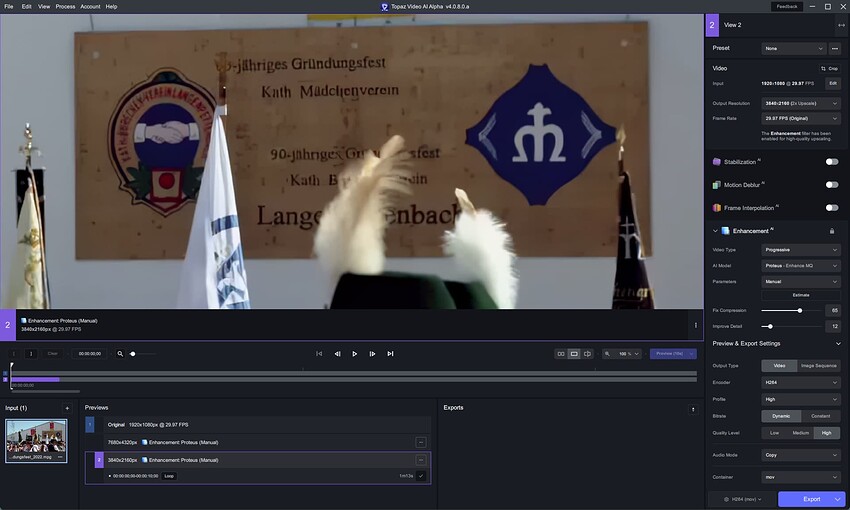

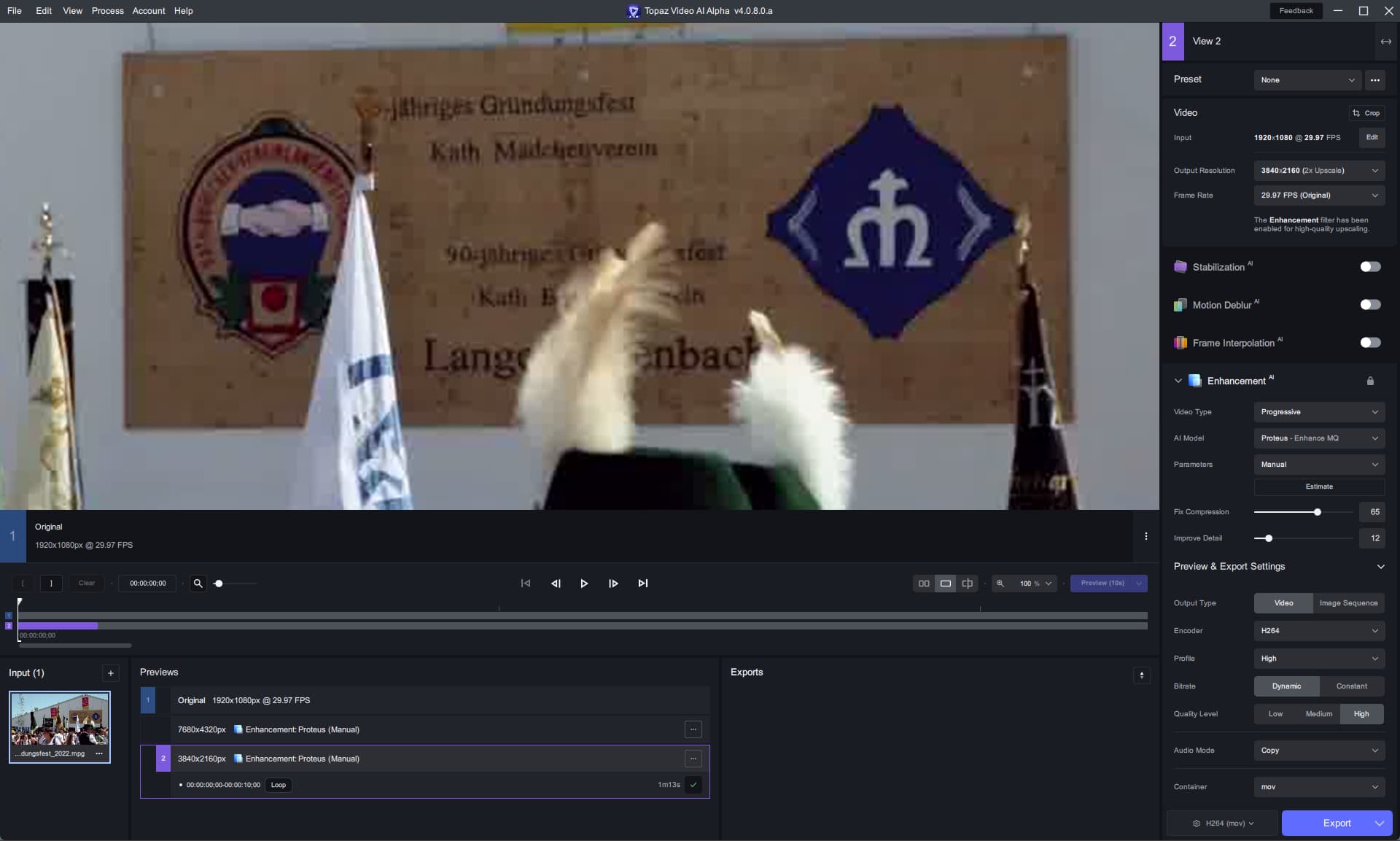

Screenshot 2023-12-13 093650
Update:
To me it seems like the model is made for the native video res, not for increase in res.
It has problems in seperating fore and background.
This statement supports mine, because in small videos recorded with small sensors, such as with Go Pro or old cameras, there is no strong separation (blur) as with modern cameras in S35 or FF format.
Even if there is a lot of compression in videos or images, the models may no longer be able to separate the foreground and background.
I have a video to test that I can’t believe someone spent money on in 2022, to someone who calls himself a professional filmmaker.
This is compressed material that was edited afterwards and then compressed again.
