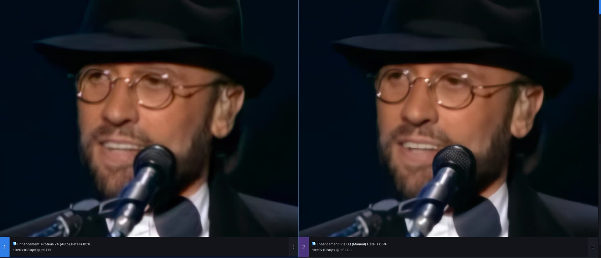

Proteus V4 vs. IrisLQ (with manual settings):
This is what it mostly looks like with my sources. Little difference but 'I still would give IrisLQ a slight edge. Microphone is where it’s the most obvious, also teeth.

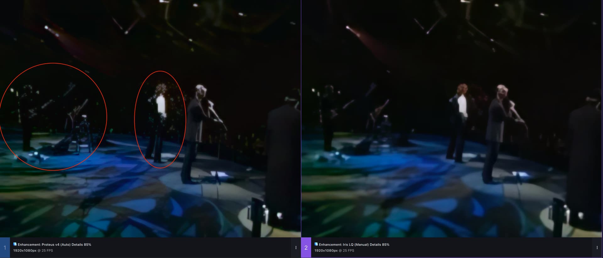

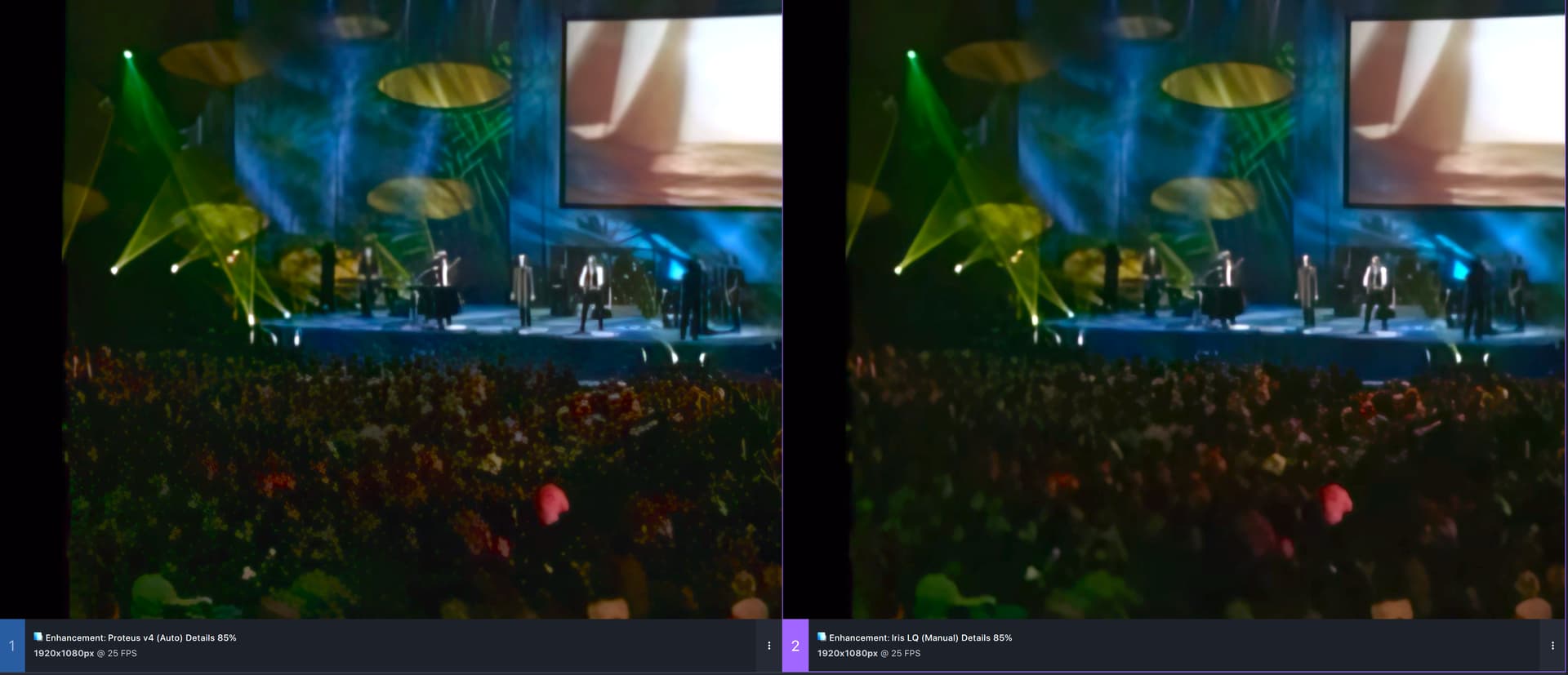

But then with ProteusV4 you also randomly get such:
Look at the crowd :flushed:
