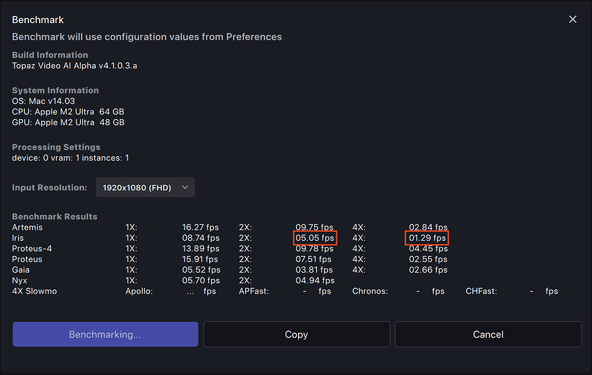

OK, Iris 2x is about 2 times faster now yes - that’s good.
BUT: It’s still not quite at the speed it could be / formerly was; and overall performance is still quite uneven on Apple Silicon.
What happened to Iris 4x upscale being dramatically slow now? And the speed gain is only there for Iris LQ and not for IrisLQ V2?
Also there are still quite big fluctuations in speed between having RAM set to 10% or 100% where 10% is much faster for SD upscales but slower for HD upscaling.
This is V4.0.8:
And here the 4.1.0.3.a with Iris 2x much faster but also 4x much slower:
P.S.: The benchmark in this alpha doesn’t run through but stops at the Apollo benches.

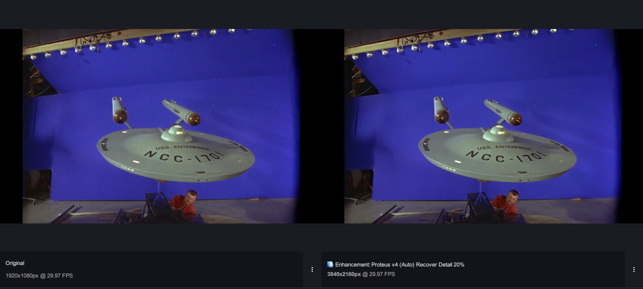

Trying to compare Iris MQ and Proteus v4 on x2. My source file is 1080p, 44min in length
  1. Proteus v4 was faster to execute, ~5+fps vs. ~4fps for Iris MQ on Mac Studio M1 Max.
  2. Output size 8.1GB for Proteus, 10.7 GB for Iris MQ (output is H265 high Quality Level)
  3. I still find Proteus a little softer on skin details, but it’s only noticeable when comparing frames. Casual viewing experience is almost similar
I am attaching 4 pair
Babylon 5 - 3x01 - Matters of Honor screenshots.zip (30.2 MB)
frames you can download and compare
I am now thinking the extra time and space taken by Iris MQ might not be worth the effort. I would of course welcome your feedback!
Thanks

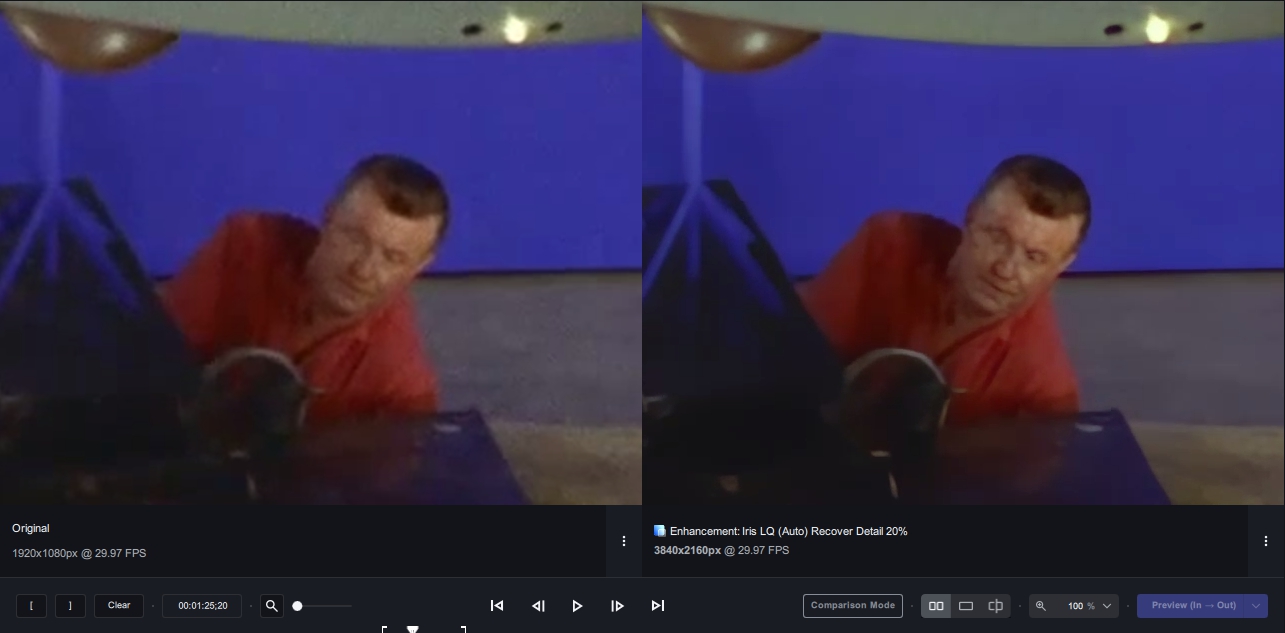

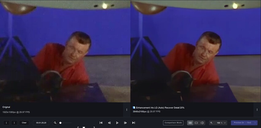

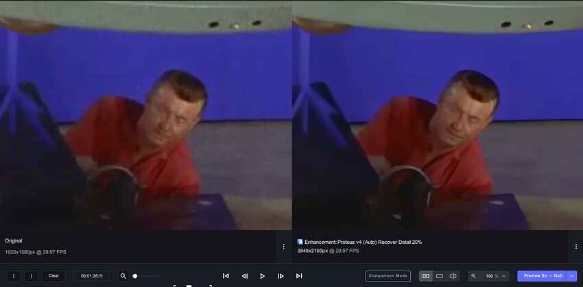

I’m not seeing very much difference in faces that are large on screen, so I thought I’d see what happens with faces that are much smaller.
1920x1080 x 2. Proteus is about 20% faster. Iris seems to do better on both the face and the background, but whether anyone would notice from a normal viewing distance is questionable.
