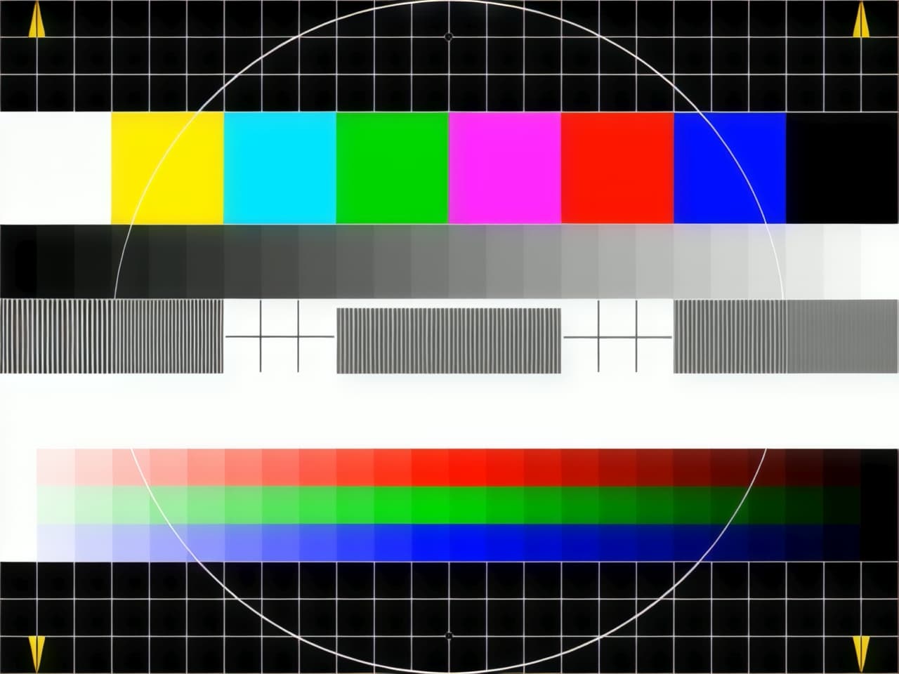

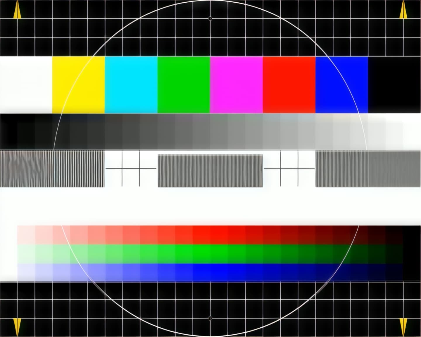

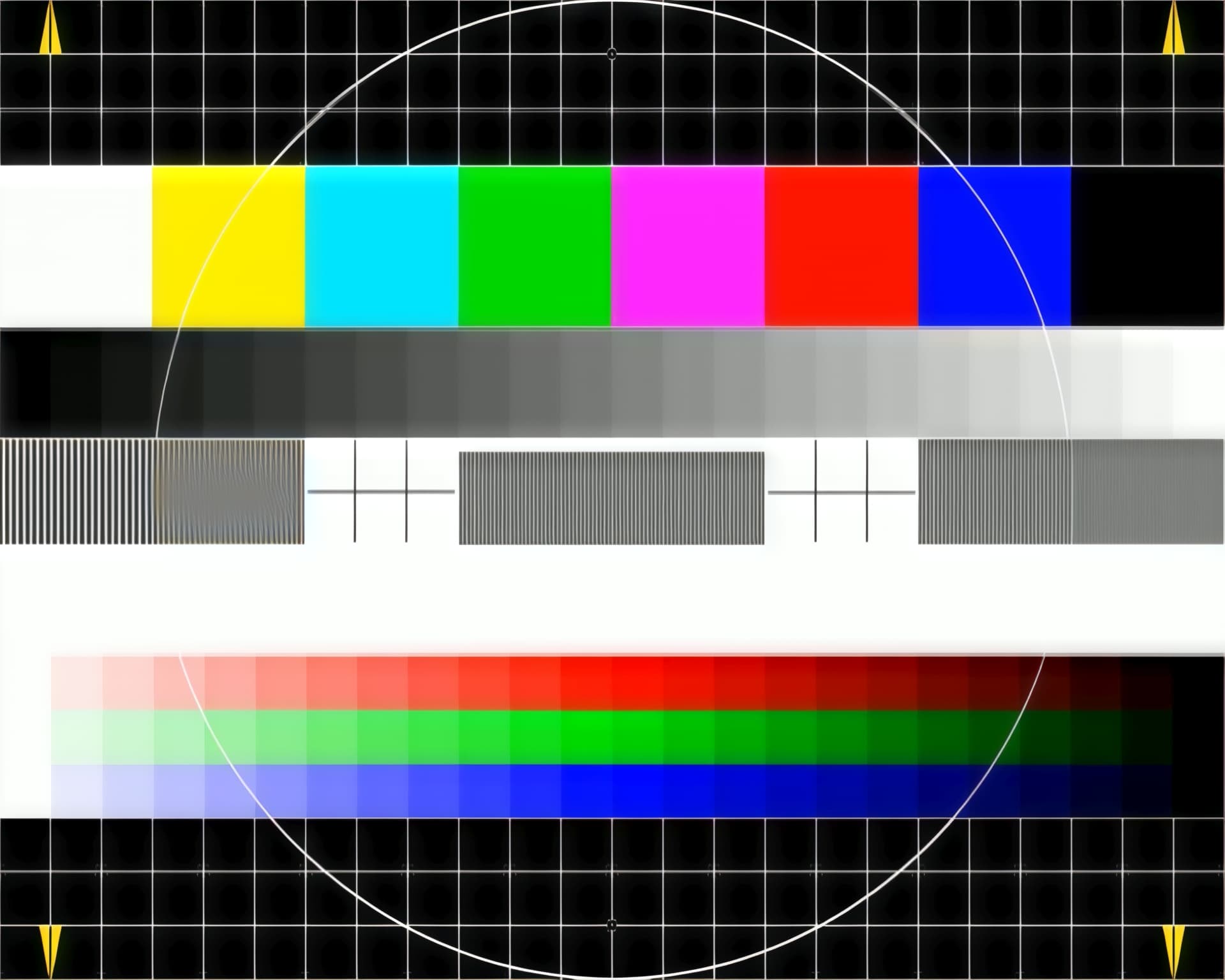

Example (320x240):
I scaled this test image video from 320x240 to 1280x960 with Starlight:
The video was first upscaled to 1280x960 with a simple bicubic filter and then “treated” with Starlight (original size):
=> The result looks the same.

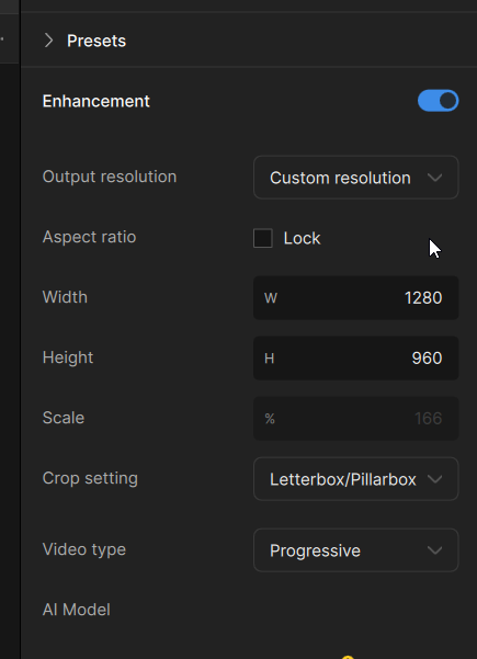

  • Any size can be selected as the input resolution, even “odd” resolutions.
    Example:
    Input: 567x425 (strange numbers!)
Output: 1280x960.

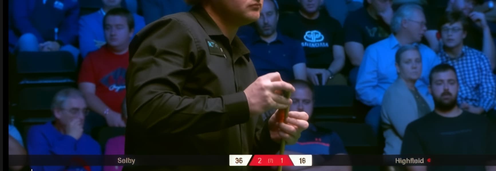

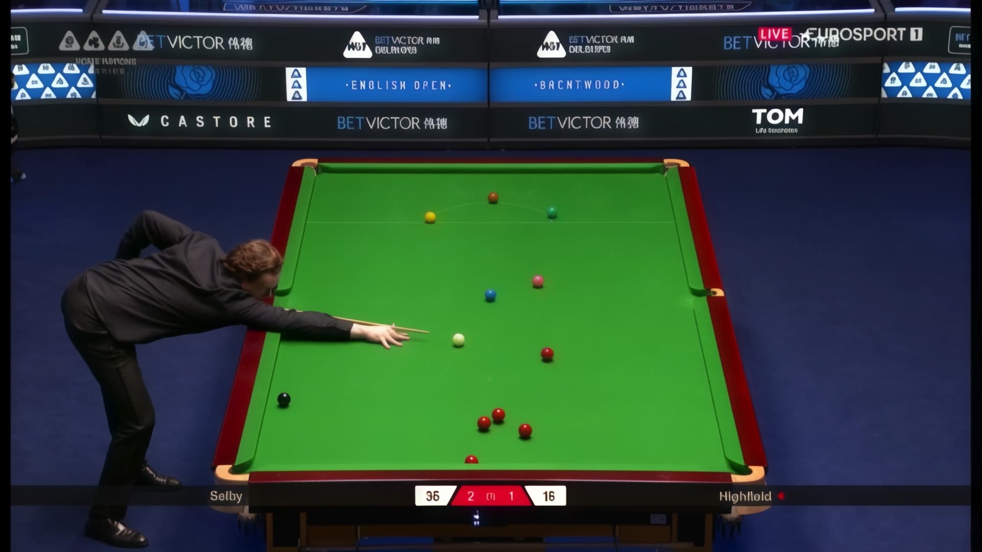

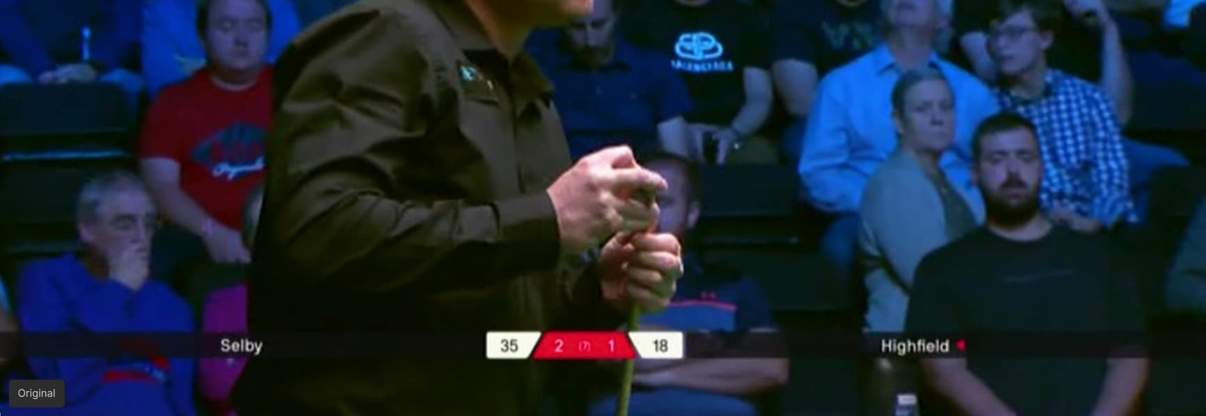

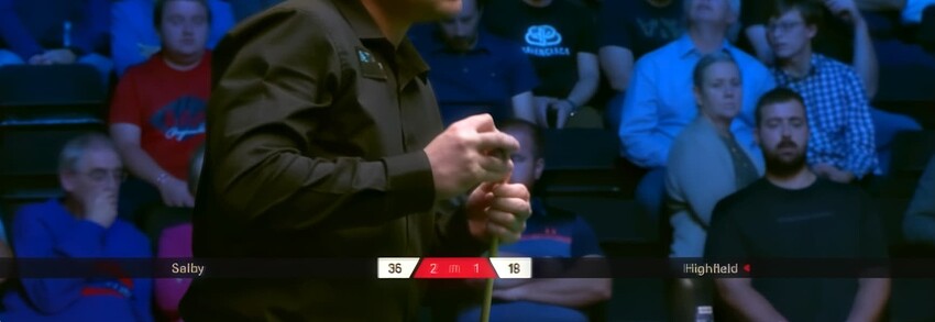

Here’s an example:
1: Original 720x576 (16:9 aspect ratio), 2x upscale (square pixels), results in 2048x1152:
2: The same with a manually selected resolution: 1920x1080:
An example (1152 pixel height) (click the picture and move with left/right to compare the difference and the “wobbling” effect:
1080 pixel height:
So:

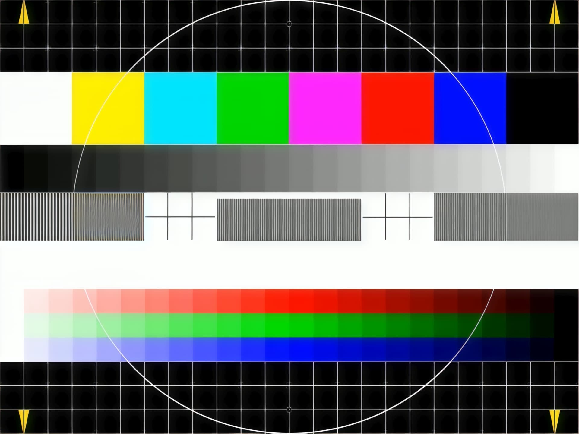

1920x1440:
1280x960:
1440x1080 (I use this for PAL-DVD instead of simple “2x”):

(Letterbox/Pillarbox does nothing here, nothing get’s cropped, it strictly scales to the selected resolution)

Thanks for the throrough testing. This aligns with what I said about the “tile stitching” issues.
Indeed, the wobbling that you mention, when alternating between the two snooker images, are the tiles that the input image is divided into, then upscaled and then the separate tiles are stitched again into a full image, which often goes wrong.
This must be FIXED, once and for all. Glad that you found out the ouput resolutions for which it does not occur, so we can work around it, that is, if for Blackwell (5090, 6000 pro, etc.), the program does not error out with OpenCV errors for ROIs that are out of bounds (in the logs that I shared), something which does not occur with your 4090. On top of that the beta is 60% faster for you, and 50% slower for us poor Blackwellers.
