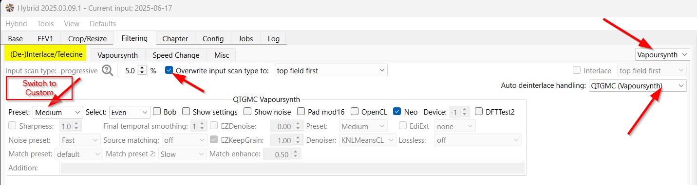

I tried using your approach but for some reason all the options under De-interlace tabs are disable (greyed out). Is there anything else that you need to do under other settings of Hybrid? Maybe a full tutorial would be useful for some people (like me) if anybody wants to take the time to put it together.
If Hybrid isn’t working for you then Staxrip is another option you could try.

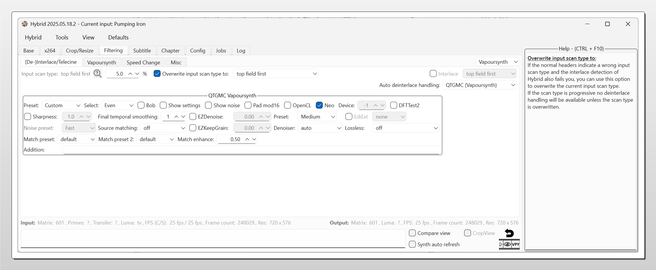

Is everything greyed out? Did you switch to preset “Custom”, when not it’s greyed out
I did. Apparently I forgot to add the screenshot before. See below.
Its a bit confusing, this are different function lines, you must select something one line some other fields not gets greyed out
set “Source Matching” and checkbox" EZKeep Grain" value 1 and also set “Denoiser” and “Lossless” fields, they are not greyed out in your screenshot, just do all like in my screenshot
