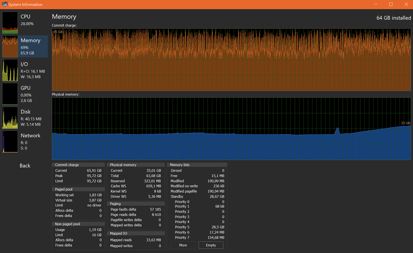

EDIT: I’ll have to re-check this WITHOUT SD-AI working in the background… Commit charge went to the sky for some reason, while RAM wasn’t even fully utilized… :sweat_smile:
…and yes, it was the choked memory commit charge, which caused these crashes. Now I’m still running the TVAI v6 without the hitch, while testing previews extensively.

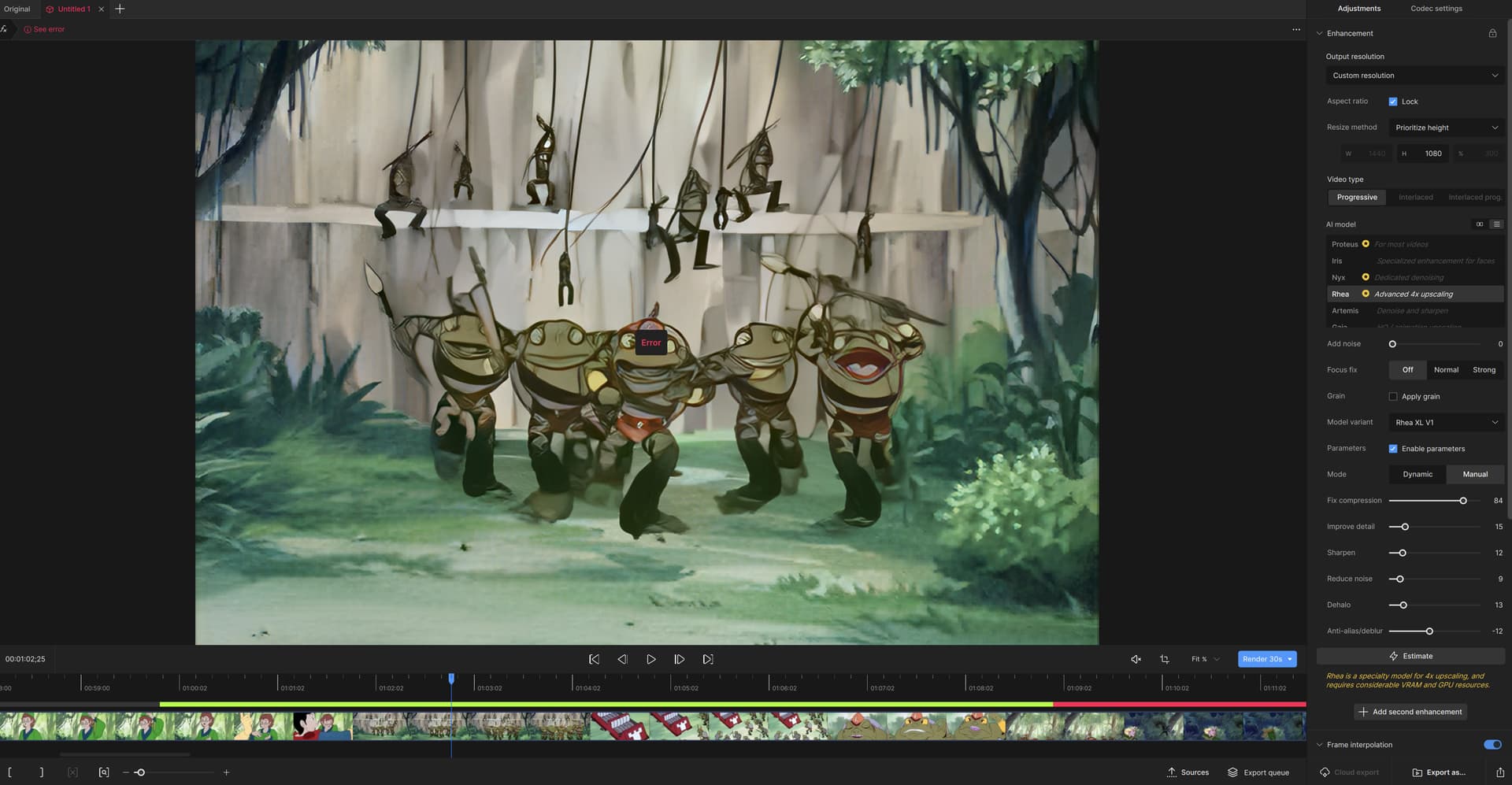

First impression of version 6.0.
Hurray, a long list of presets works. Okay, I’ve set some preset and… where the hell is the IVTC option for the source file? Okay, I’ve set it up, time for a test preview. I click preview and guess what? Crash! My first TVAI crash.

After an export, if I return from the Export queue to Adjustments with the intent to fine tune my adjustments further, I find that all my parameters (Enable Parameters) in Adjustments have reset to their defaults. That’s a problem. It seems that if I hadn’t saved my Preset immediately before I ran my last Export (which granted is best-practice) so that I can reload my Preset, I’ve simply lost my latest parameter adjustments.
(It also seems that there is no longer a way to update/resave a Preset as one fine tunes it? Have to resave it as another Preset… and another… and another?)
Second observation is that the split-screen preview doesn’t align the two images over each other correctly if the original is SD and the output is HD.
