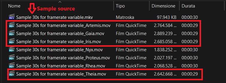

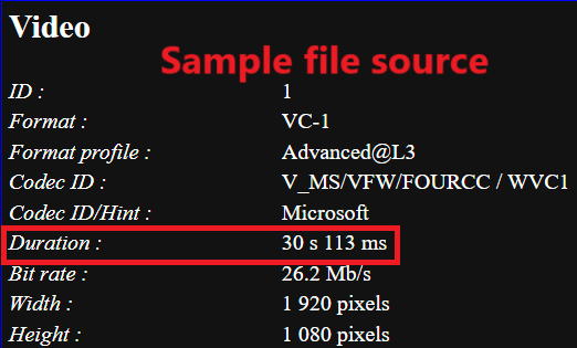

I had fun with version 5.3.6 and found problems with the duration (I think lost frames) in the various models
Again using a sample source file of 30 seconds duration
(1 fps@23,976= 41,7 mS)

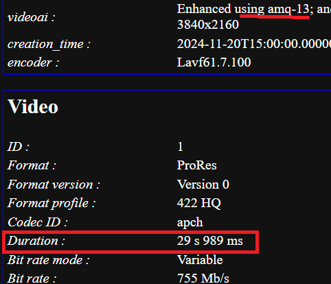

Artemis= -124 mS (-3fps)
Gaia = -124 mS (-3fps)
Iris = -124 mS (-3fps)
Nyx = -83 mS (-2fps)
Proteus= -83 mS (-2fps)
Rhea = -83 mS (-2fps)
Theia = -124 mS (-3fps)

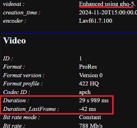

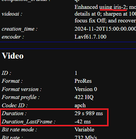

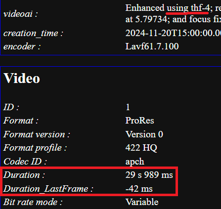

What I don’t understand is “Duration last frame” on some models (Gaia, Iris and Theia -42 mS), this does not appear on release 4.2.2
Immagine 2025-01-15 155057
Source
Artemis
Gaia
Iris
Nyx
Proteus
Rhea
Theia

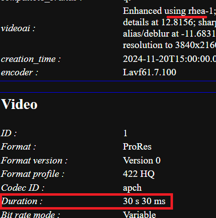

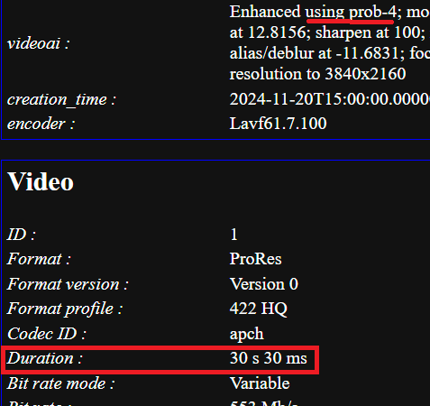

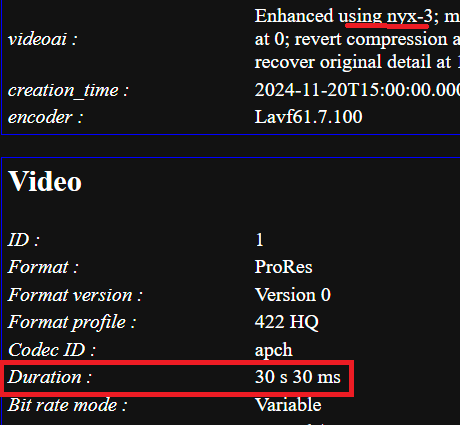

Interesting, what I can say is with 5.3.6 Iris and Rhea generates frame accurate outputs. If that weren’t the case, I would have noticed it long ago, as I often put iris tracks over rhea in my video editing software and then every frame has to match exactly.
What I notice is that at the beginning and end the encodes are sometimes not exactly the same length, one or two frames are missing, so I just cut this flush away.
So it’s no VFR problem here (V5.3.6), but TVAI has problems with first and last frames
