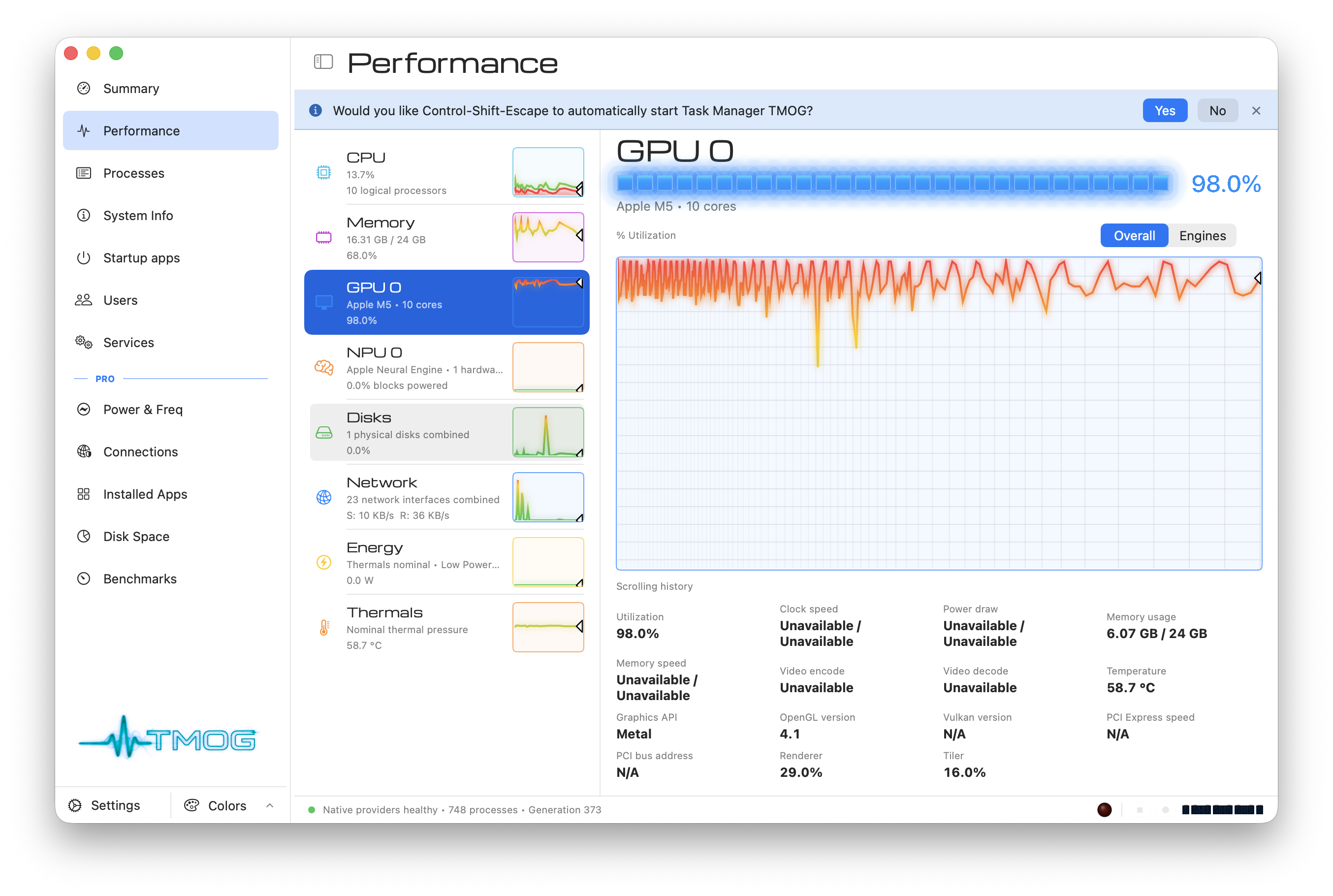

Found nice little Task Manager for macOS from Dave Plummer, who originally wrote the Task Manager on Windows while he was working at Microsoft…
Here is a screenshot on my MacBook, while running SLP on Video AI (of course!)
