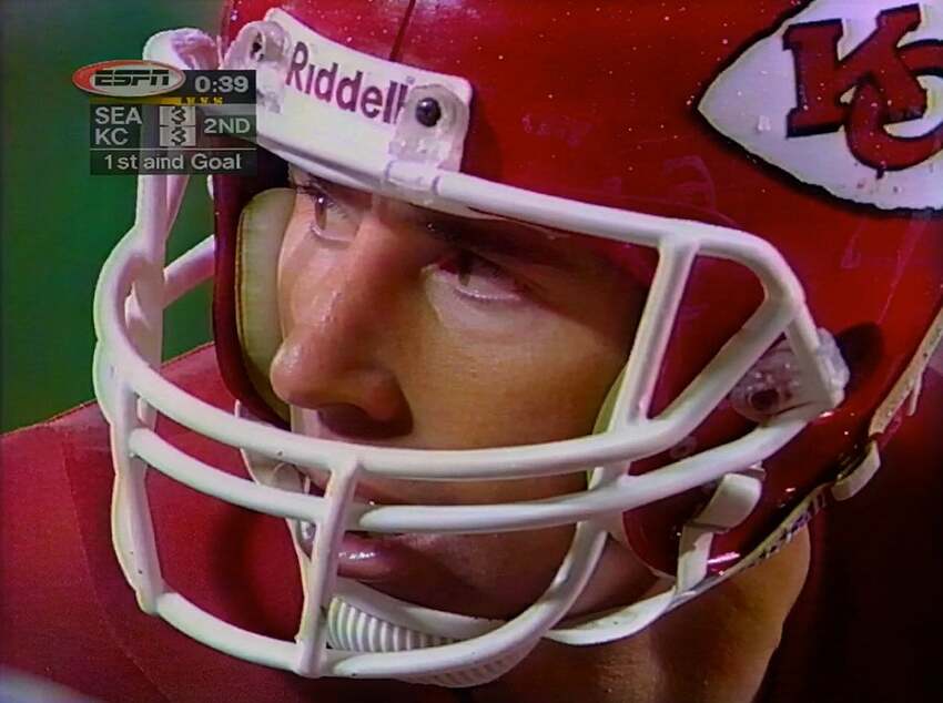

Precision 2.5 works really good ..
My test:
320x160 → SeedVR2.5 → 1920x960 → Precision 2.5 → 3840x1920p
looks very nice
does it really works on 3090 ?. As per requirements, it needs cuda compatibility 8.9
jop its working by me. I have Nvidia Studio Driver 591.86
Just the absolute clarity of this is something to behold.
What resolution did you start with and what resolution did you upscale to?
540p-960p
I like how it isn’t super high resolution, but it still looks very clear. You don’t need to go to 4k or something crazy.

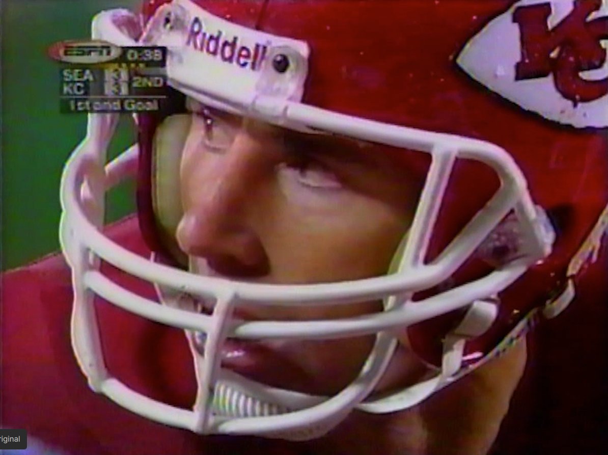

Yeah I’ll be running some 4k tests but by and large I think it’s hard to get the detail you want out of the kind of VHS tapes I’m dealing with. I think going to 960p and then maybe a proteus pass to 1080p or 1440p is the best result. Or even just rendering 960p source at 1080p.
Now I have some 1080p VHS captures (the VCR I have has some rudimentary upscaling technology in it) I’m going to try rendering in SLP at 1x and we’ll see how that does. Will try 2x also.
