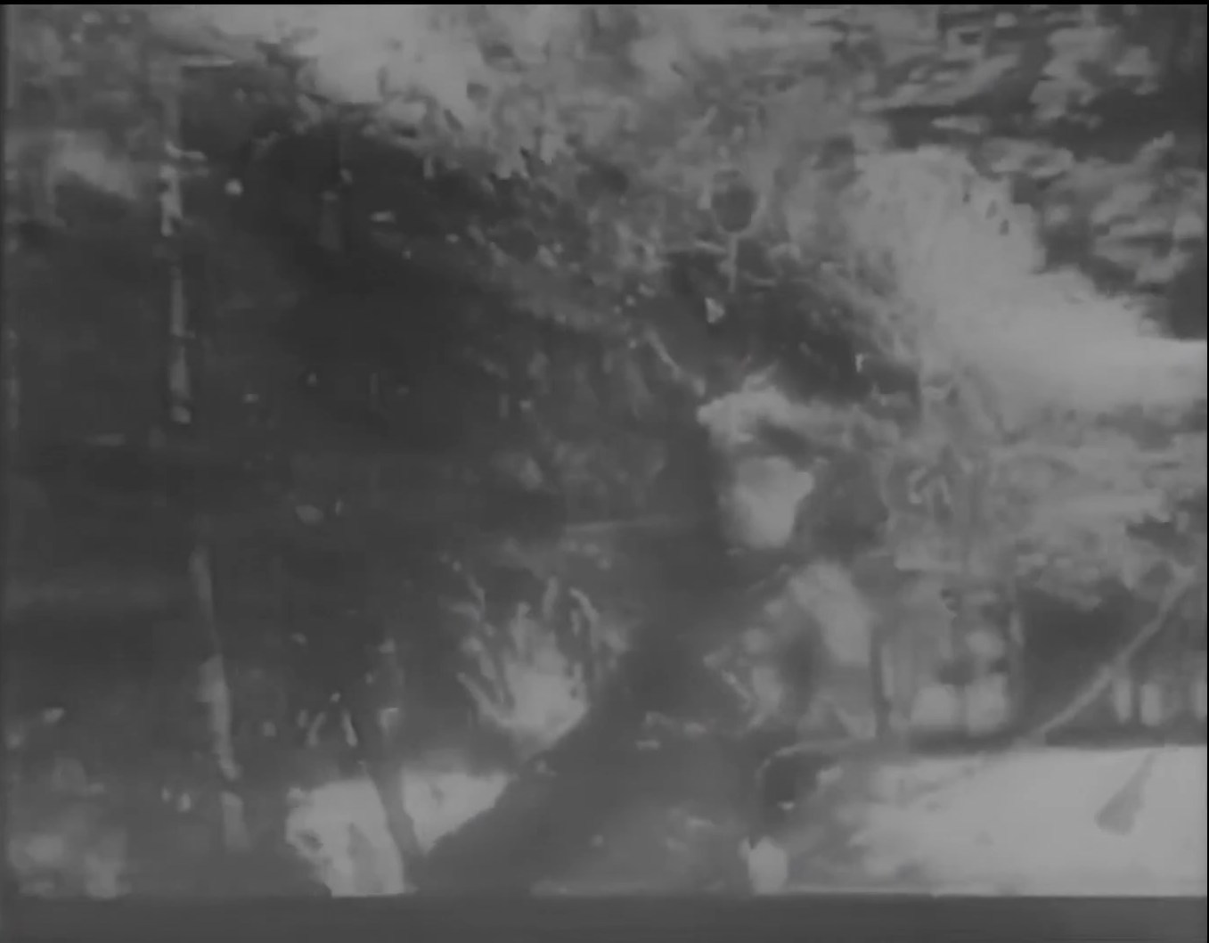

This time the input is just horrible. Old footage badly upscaled to 1920x1080.
This is what I’m working with.

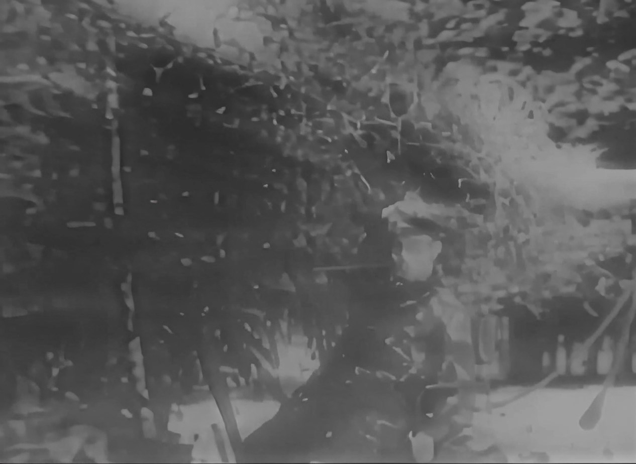

First things first, downscale to 422x308 and upscale with SeedVR2:
Not much, but a ground for Starlight.

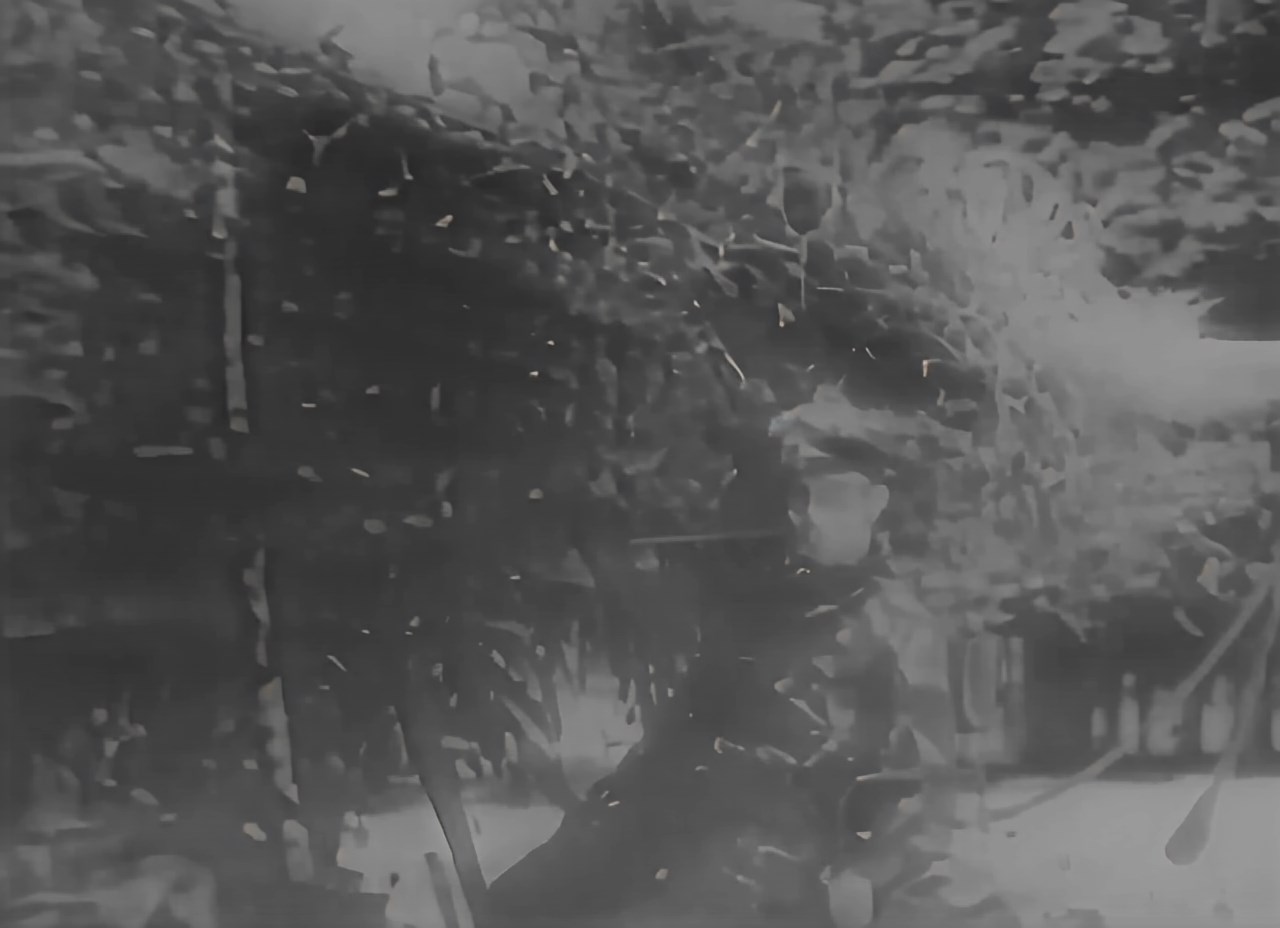

Starlight HQ:
Not so much gained.

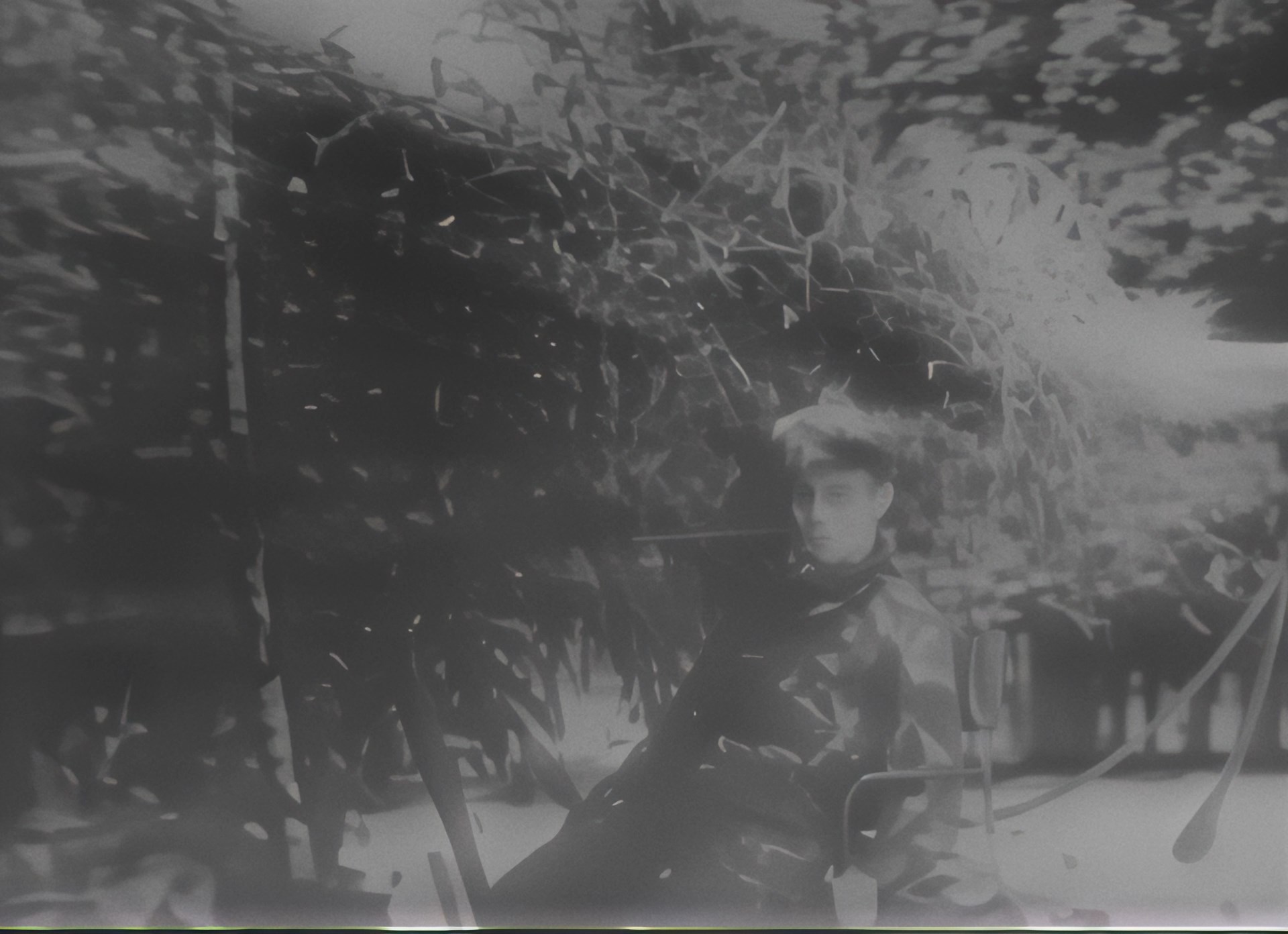

Starlight Mini:
Oh, a face!
Now let’s add Iris on top and some grain to mask flat surfaces.

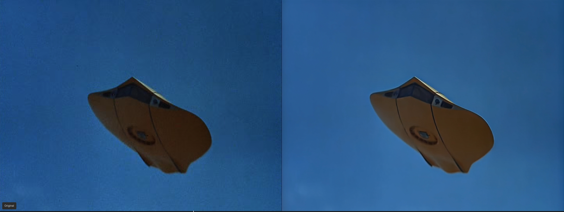

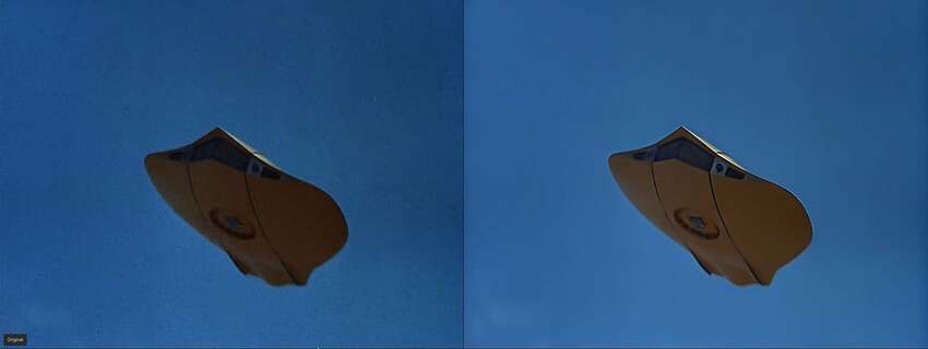

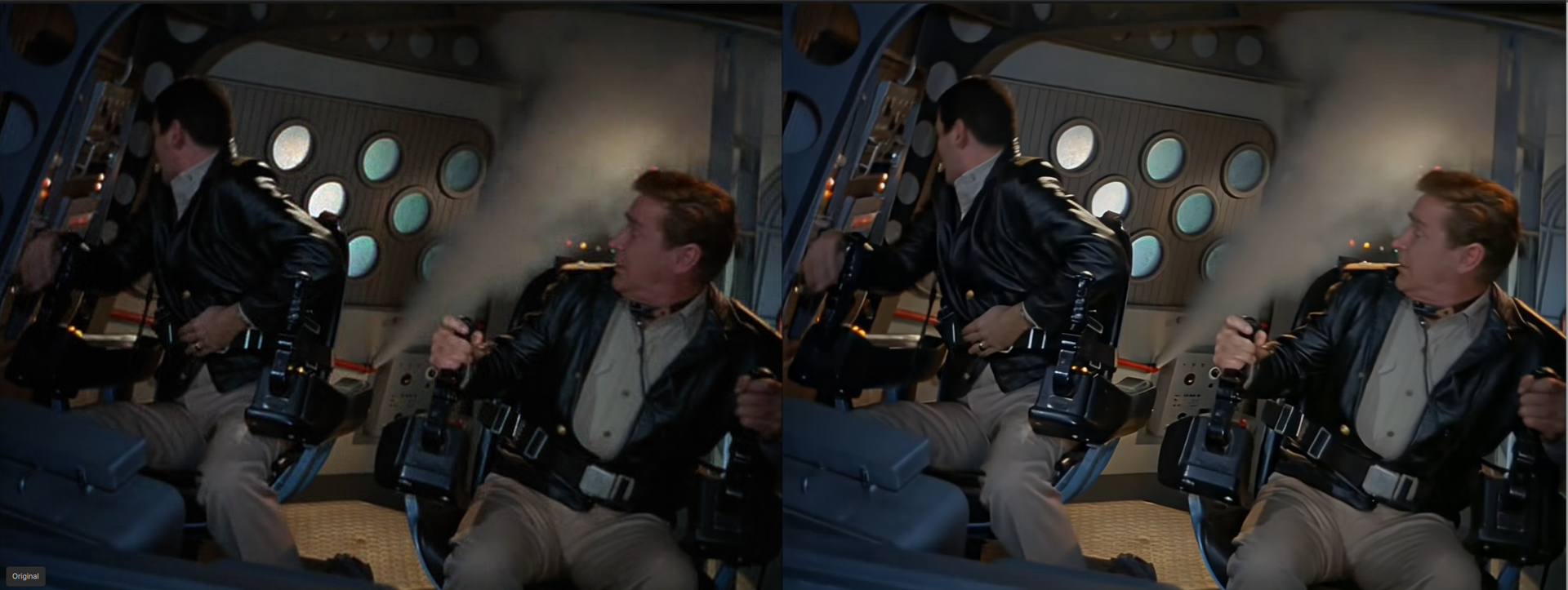

The Starlight HQ model can be used on other files with good results as well. Case in point screenshots from an older file in 768x576 resolution. While it was trained and designed for certain types of videos and not as ideal for lower resolution file, it can still produce very usable results when doing upscales to 1080.
Also to clarify this was on upscaled to the minimal factor.

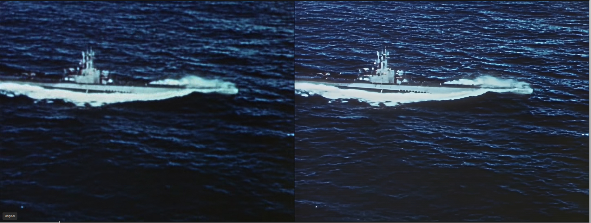

The visible blockiness in the foreground of the ship output is pretty much what I was getting in my tests with sub-HD material. The model seems to struggle with low-res scenes that are dark and compressed (always the hardest scenes to fix, of course). I’d be interested to know what kind of material it was trained on if you don’t mind sharing.
