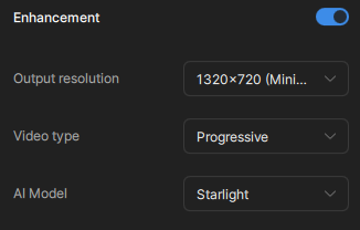

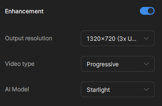

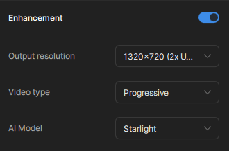

For me minimum, 2x and 3x show different resolutions, although 4x shows the same as 3x.

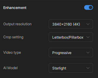

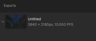

You really have to double check the real resolution of the output video file,with Starlight though. This often deviates from what is stated in the GUI.
Earrlier you could easily tell by that if SL really did 2x, 3x or 4x.
But, at least on the MAC, with this last 1.0.3 version SL it seems to always do 1x and then “cheat” by doing a simple bucubic/lanczos upscale of that file to the resolution that you’re told in the GUI, maybe to trick some users into thinking it’d work.
But, if you look at the now abysmal quality of those SL (again, at least on AppleSilicon, NVIDIA tests will follow) you definitely notice that this is NOT the 3x or 4x model, likely even only 1x. You can also tell this by the rendering speed.
