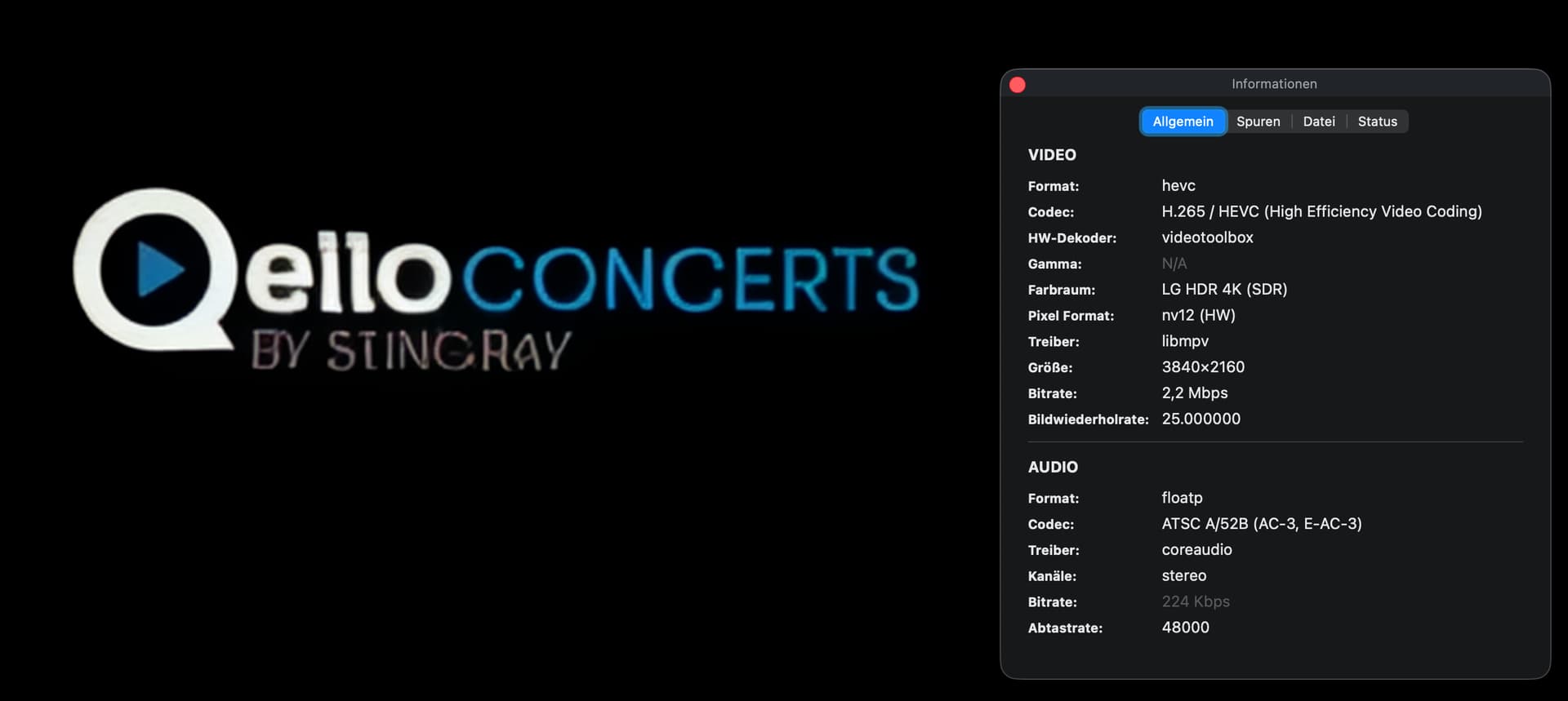

Tested it shortly on the Mac: quite disillusioning, really.
Still NO 3x upscale:
Add to this that 4x still obviously only does 2x. And that now on the Mac which didn’t exhibit this issue in previous versions- also quality seems to have gone down (again)!

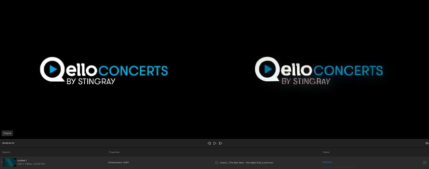

Original on the left, SL 2x on the right (yes, it’s really that way):
You can’t really call that an improved image quality… :face_with_head_bandage:

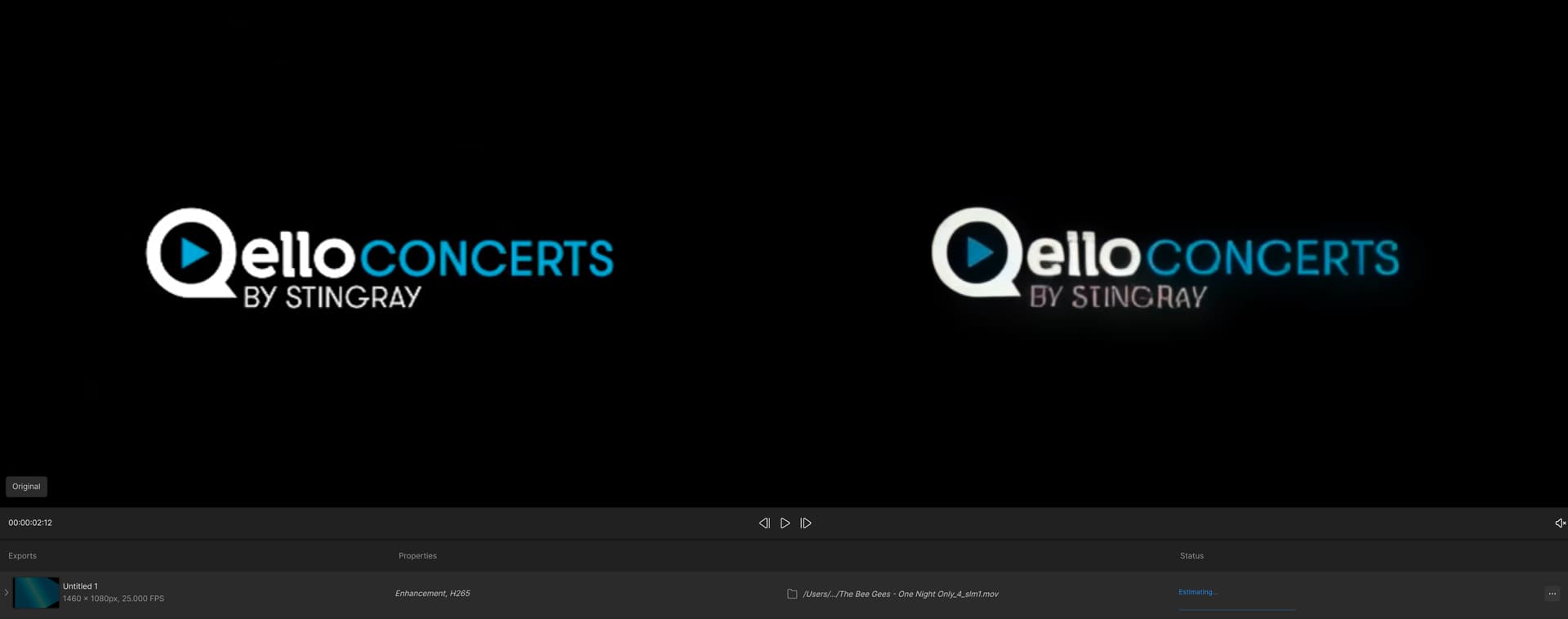

the alleged 4x upscale:
This is worse than ever!!

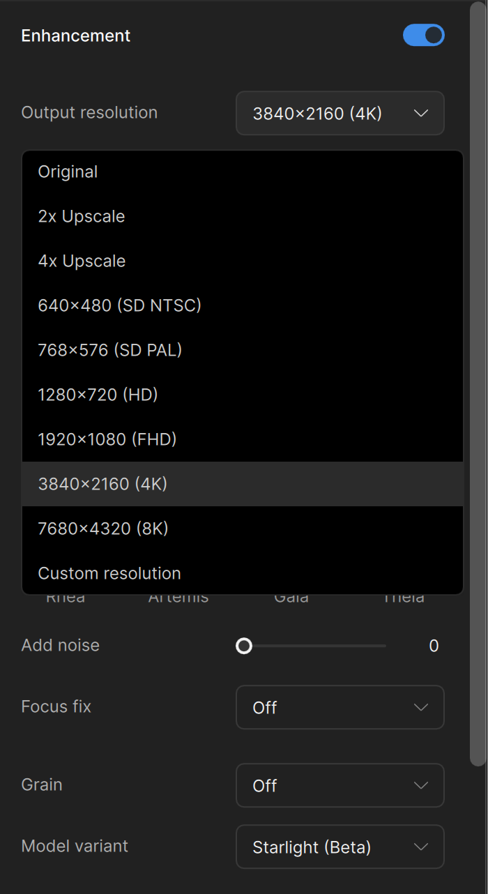

It gets worse: Now, even setting 4k resolution on this file doesn’t do 4x, just the BAD 2x quality (and also at 2x speed). Contrary to previous SL versions the output file does have the 4x resolution, though. A bit as if they want to fool users..

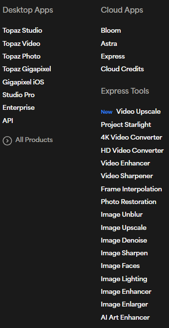

Most of their effort is going towards the cloud and ‘express’ apps, the desktop products are being treated like an afterthought now. Just look at how many web apps they are churning out:

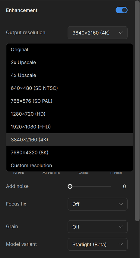

And now you guys broke Starlight with that. Thanks a lot.
With the previous version, I could render straight to nearest 4K resolution from my original file and now it just automatically sets it to 720 no matter if I choose 2x, 3x or 4x.
