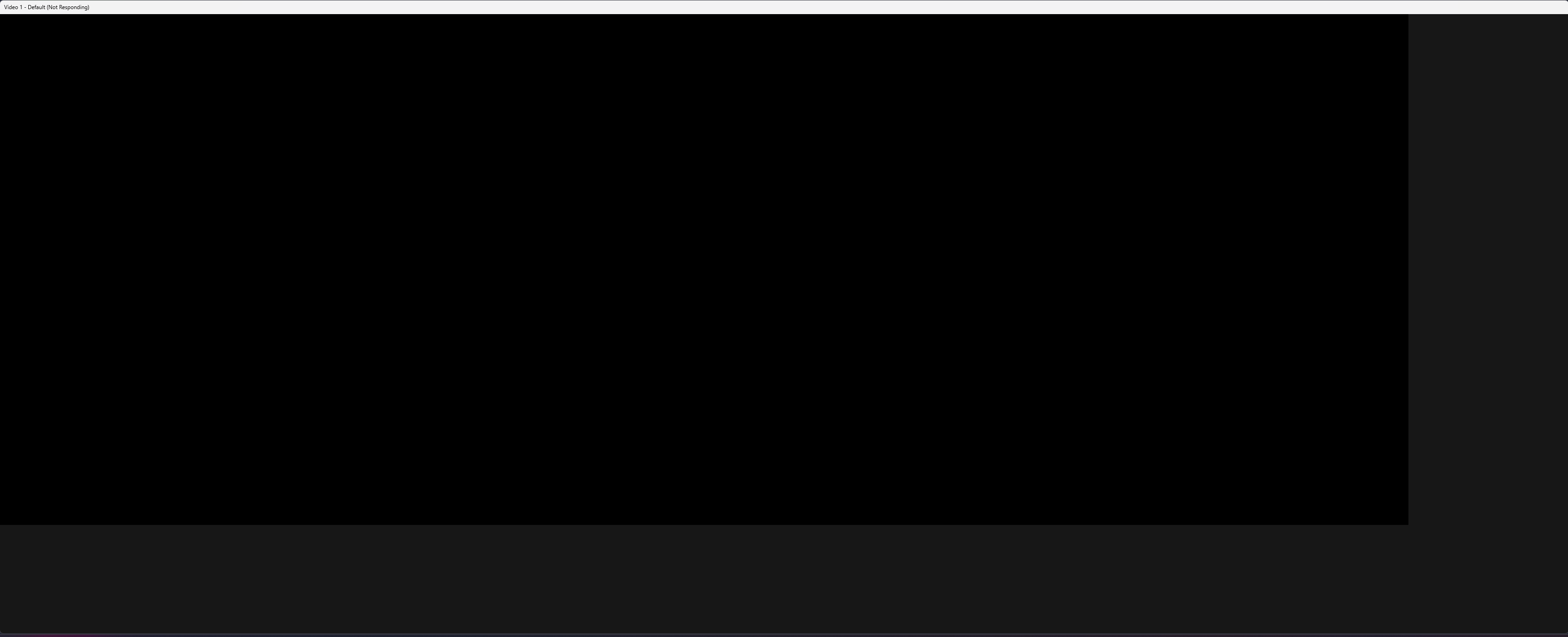

The application no longer closes properly after processing a video and attempting to exit, as if there is still something running in the background. Screenshot attached.
