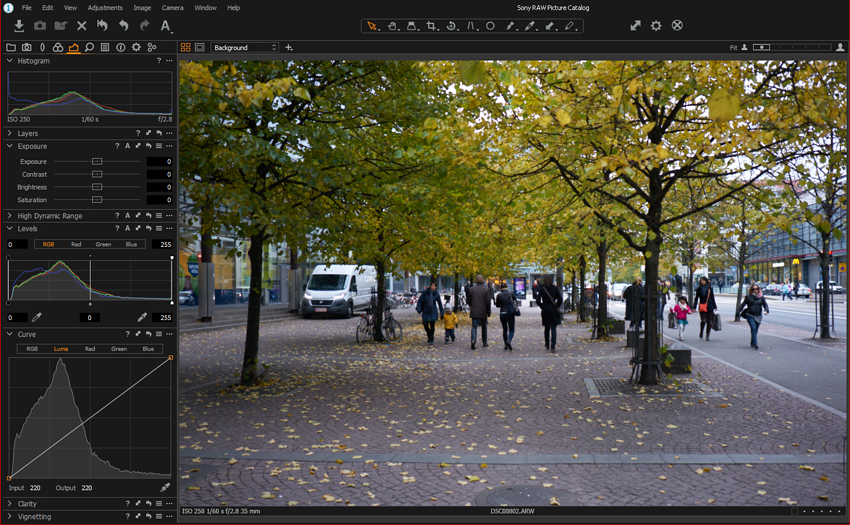

When importing Sony a7RM2 or Sony a7S RAW files into Topaz Studio, the result image is muted, dull, and way too dark. How ever I adjust the image, it does not get any better. I’ts like the picture lacks all the dynamic range.
I love Topaz Studio, but this seems to be a total show stopper.
Thanks, Arthur
P.S. I loaded two sample images: one is Topaz Studio and the other is CaptureOne. Both with default settings.

I did some tests and there still are some serious issues with Sony RAW import:
1) Dullness and darkness that is very hard to adjust right.
I upload images where the same picture is in Photoshop, CaptureOne, DxO PhotoLab, ACDSeePro, Corel AfterShot, Luminar and Topaz Studio. All with no-adjustments -settings.
2) Unfixable blue-color oversaturation in dark images.
This is quite bad, since you cannot fix it with any adjustments.
I hope these issues will be fixed soon.
Thanks, Art

Hi Arthur, What you are missing is that any photo processor is applying settings that are in the meta data of a raw image. An example of this is the color temperature setting which can affect the cast of the photo. Even though you see no adjustment in ACR (or some other editor), it is applying these settings just like your camera would if saving it to a Jpeg.
These settings are not being applied in Studio so you get the raw image as it really is, since the meta data is separate. You should be able to adjust it to look correct but since you don’t know where to start it is much harder. Topaz could apply the settings, which would give a correct starting point, and maybe they will but Studio seems really designed to apply effects to a generally corrected picture. That is why developing the raw photo in ACR (or other) first then going to Studio is normally the best solution for now. As Don said, photographers reasonably expect the starting point to have the camera settings applied.
Thanks for the comment, I just want you to understand what is happening behind the scenes.
This is true but topaz is not getting the right stuff I’m not sure if this what you said that Topaz is importing with out 0 correction. If you see my sample the histogram look different between Topaz and Camera Raw. So Topaz is not doing what other software are.
But to me Topaz don’t have a lot adjustments so I’m not using for correcting my pictures but using for other stuff.
