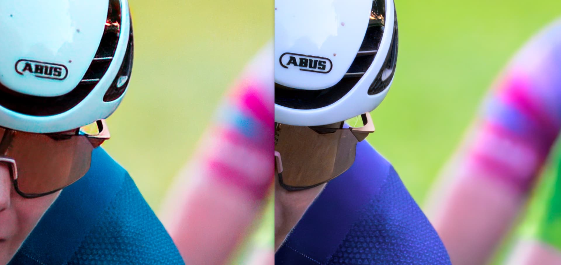

Fixed Color Shift with the Nikon Z8
The Nikon Z8 is in the top 10 most popular cameras used with Topaz Photo AI.
If you are importing RAW files from the Nikon Z8, you should now see dramatically improved results with more consistent color and exposure settings in Photo AI.
In this update, we fixed color rendering for this camera in Topaz Photo AI so the preview will be faithful to the output from the camera.
Here is a comparison of the color before the fix (left) and the more accurate color in the beta (right).

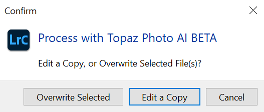

DNG Files in Lightroom Classic
As a part of this update we have also fixed a problem with a common workflow when calling Photo AI through Lightroom Classic for editing DNG files.
Previously, DNG files were overwritten with changes. Now when using File > Plug-in Extras > Process with Topaz Photo AI you will be asked whether you’d to “Edit a Copy” or “Overwrite Selected” so that your DNG files are no longer overwritten by default.

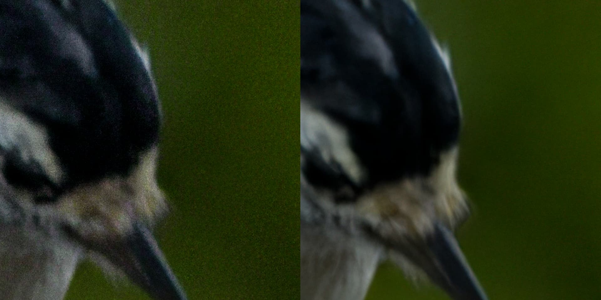

RAW Denoise Improvements in Autopilot
We have updated the default strength settings for RAW Denoise (Normal and Strong), leading to more consistent and improved results when Autopilot runs on your images.
Above (right) updated RAW Denoise Autopilot values compared to (left) original
Autopilot should tend to select stronger RAW Denoise models depending on the ISO setting by default, but the associated strengths settings have also been adjusted and tuned to optimize for this change.
Please let us know if these adjustments improve your Autopilot results on RAW files.
Note: certain cameras may be more affected by this change than others. If you notice an over-aggressive strength setting for your images, please let us know which camera model and ISO setting you are using and the auto-set strength value vs your preferred value.

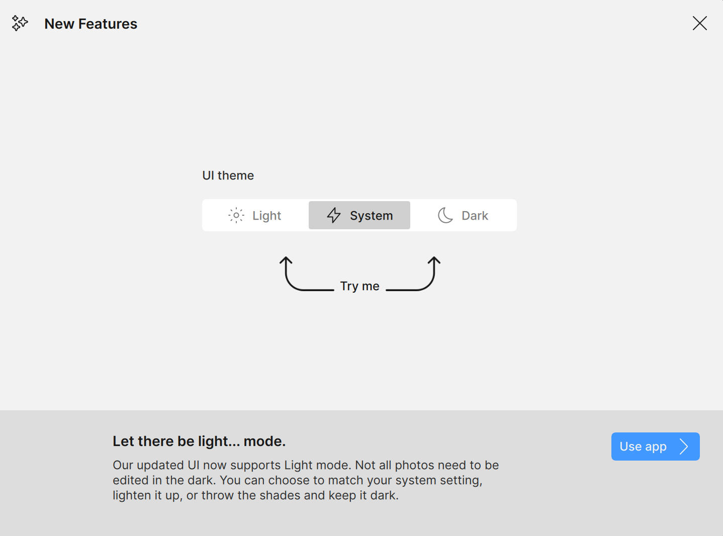

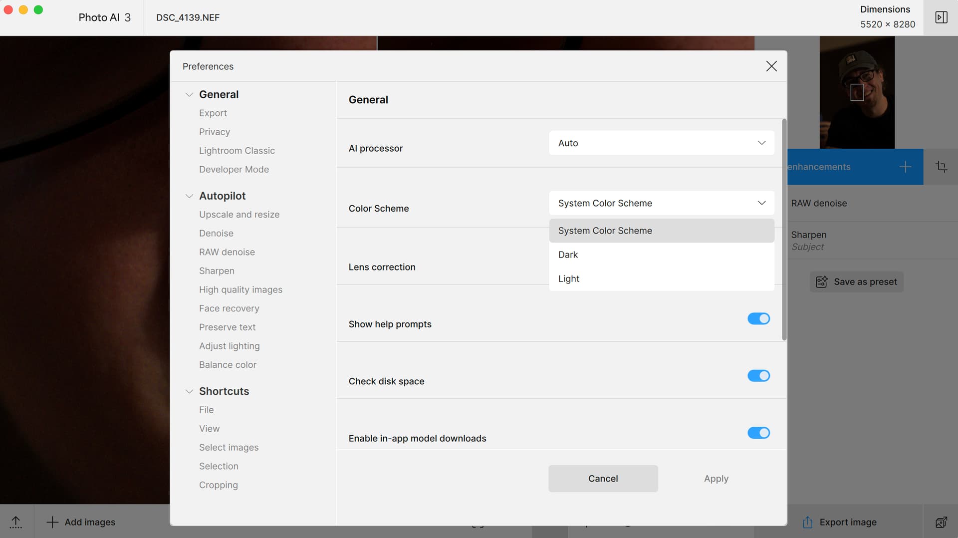

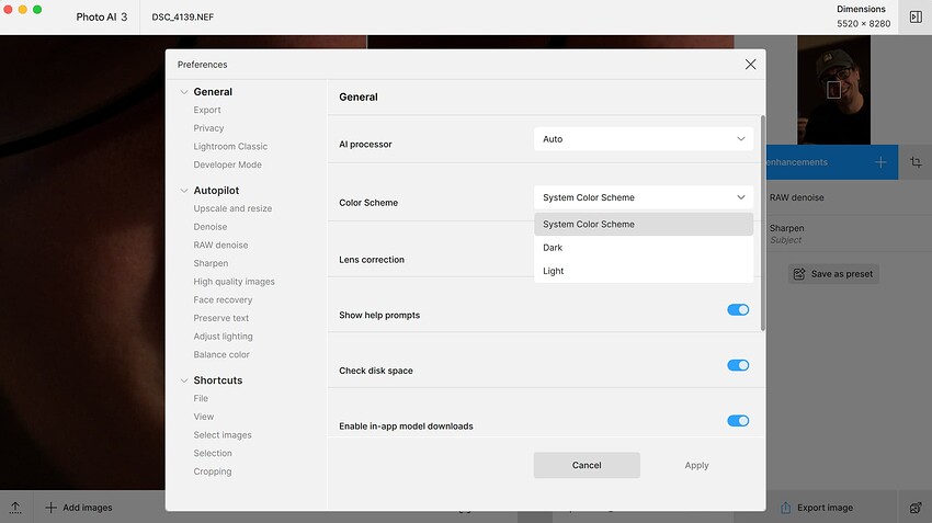

Dynamic Light and Dark Modes
Many of our users prefer light or dark backgrounds depending on the type of photo they are editing. In this release, we have added the ability for Photo AI to dynamically toggle between light mode and dark mode based on your system settings.
You can also configurable your preferred mode using preferences:

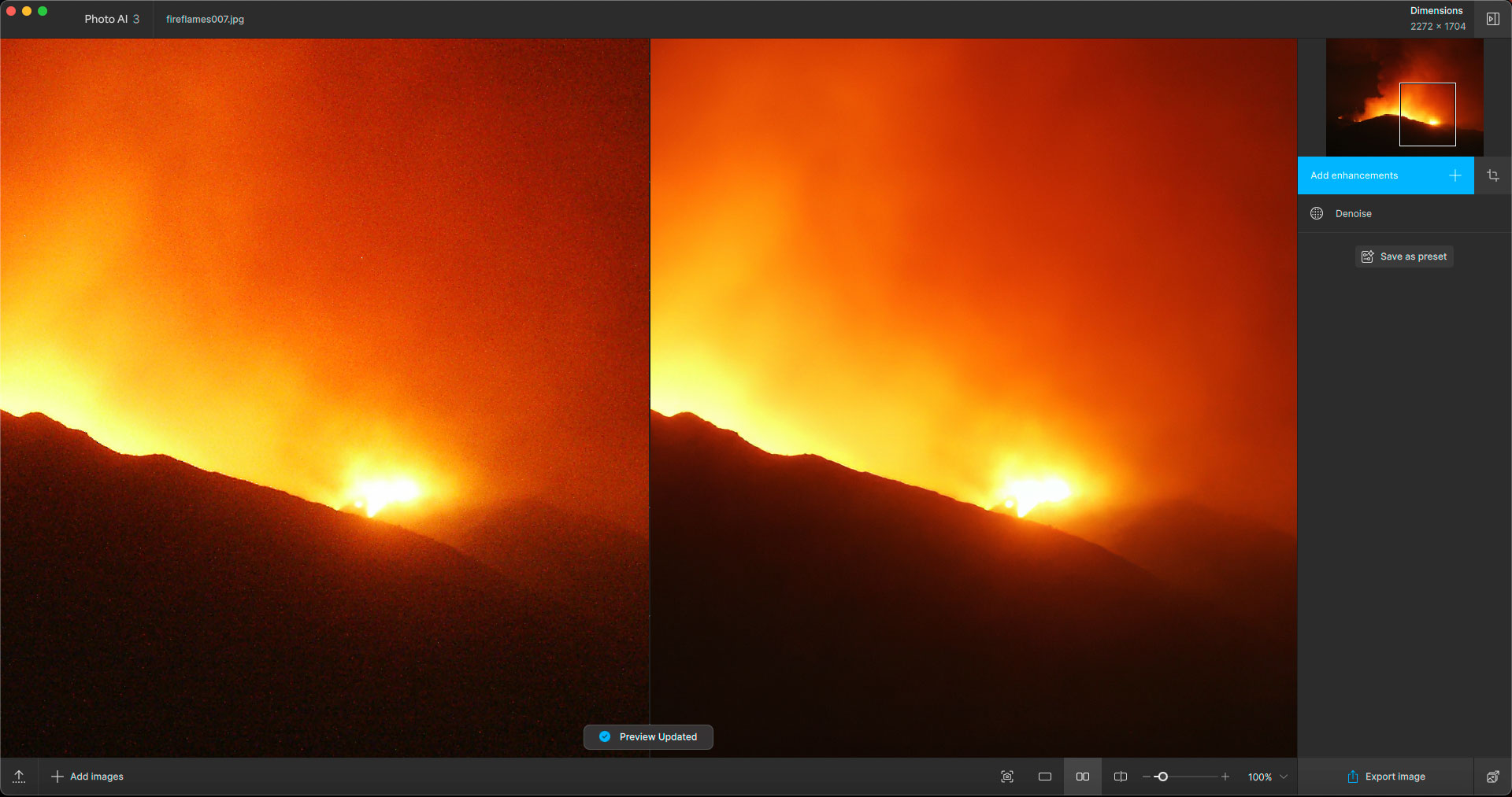

Quick noise removal test on a 20-year old digital image (manual override). It even removed the dead pixels :wink:

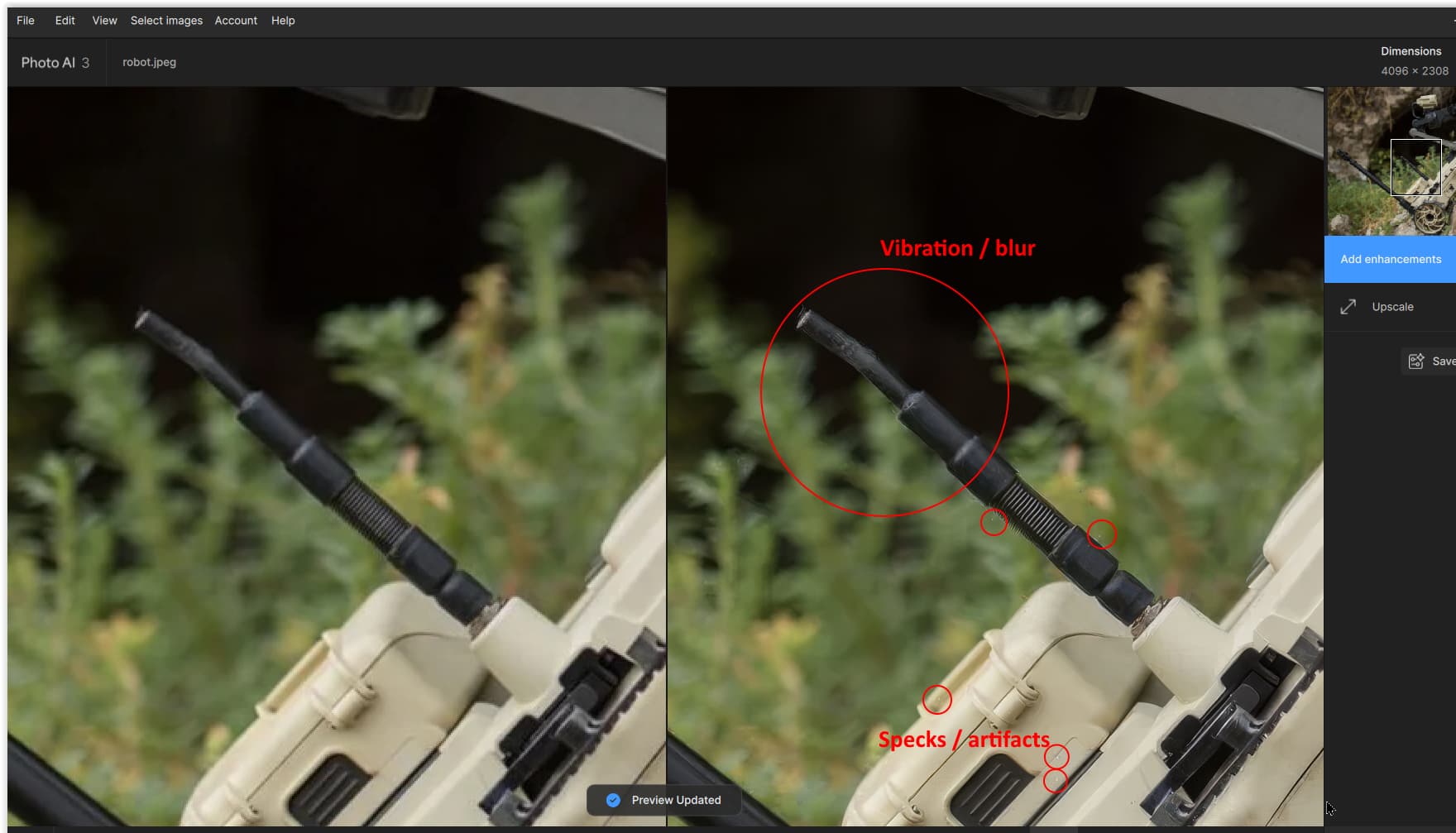

Some motion blur and bright specks appear on the Standard v2 model at 2x enlargement without any other enhancements. (Basically, the auto-defaulted mode, just set 2x enlargement).
I’m not sure how you guys test your product. Why don’t you take 500 random images and run them through Topaz AI, highlight the differences in Before and After, and have a human review them? You can find all these bugs in 10 minutes of human labor
