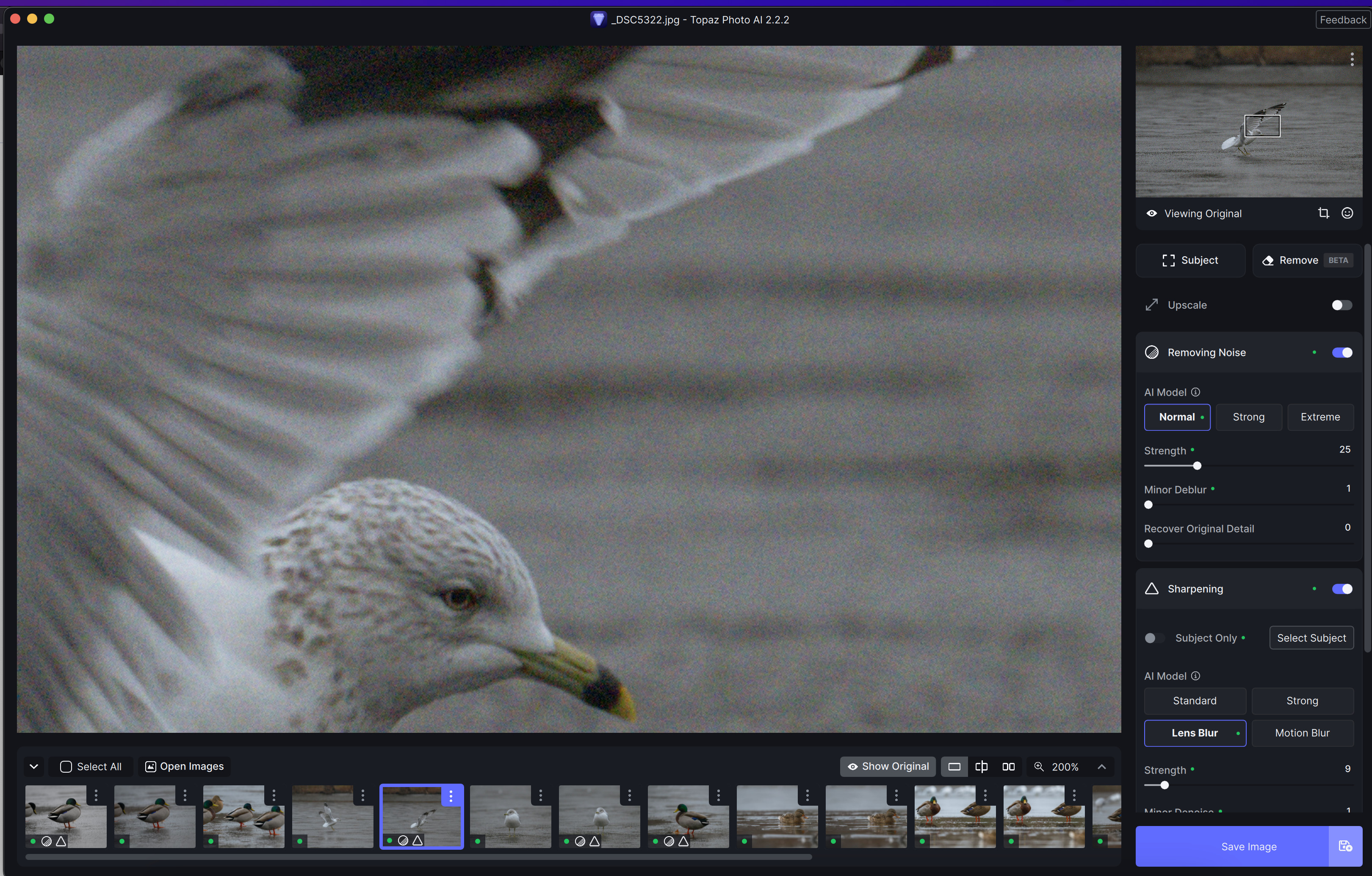

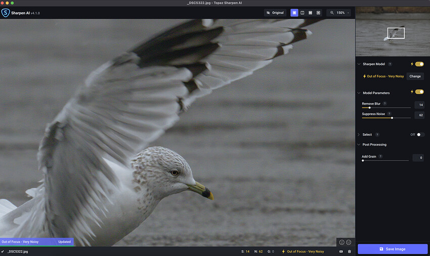

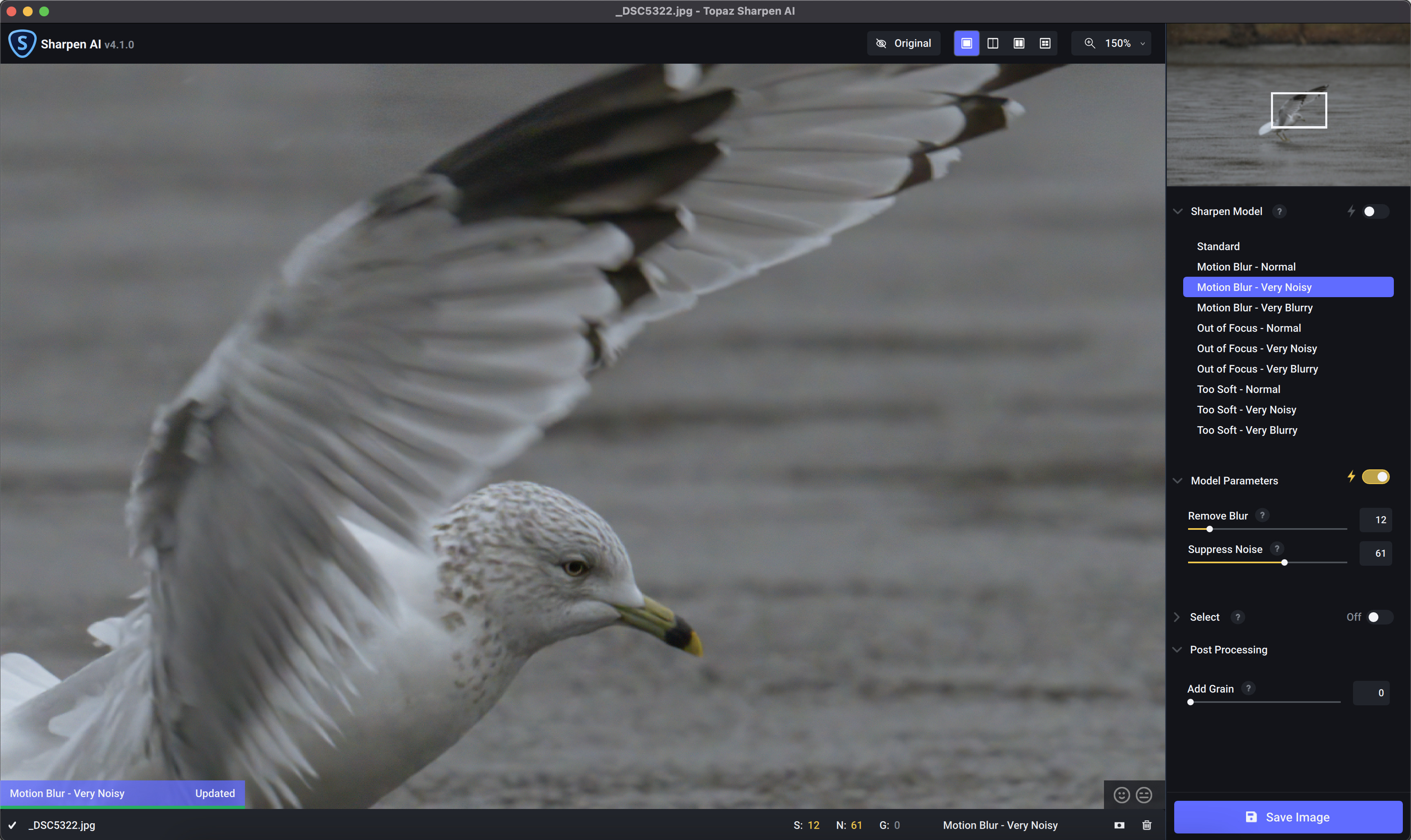

When TPAI was introduced to replace Sharpen, Denoise and Giga AI, the main advertised objective was the strength of its autopilot. Years later, the autopilot and TAPI cannot be trusted. I can never ever run a batch and have confidence that results are artifact free.
Here is example, autopilot settings:
initial image:
and this is Auto Settings in Sharpen AI:
Setting to Motion correction also does not introduce the artifact in the water under the wing:
Please fix this, please give us functional software that can be trusted.

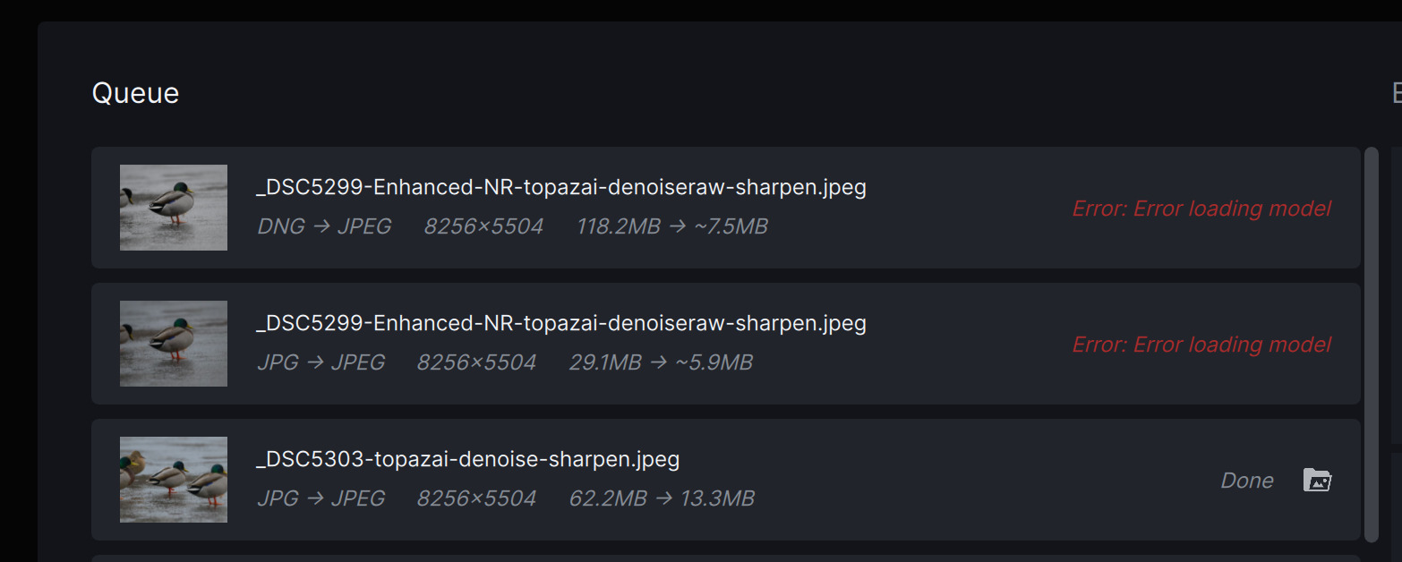

Error loading model - just updated 2.2.1 to 2.2.2 on latest MacOS, M1

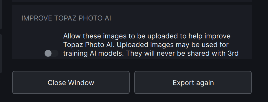

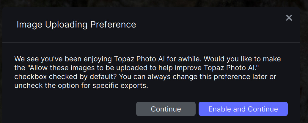

This dialog has a bug - it cannot be scrolled to the bottom to actually read this disturbingly constantly and annoyingly appearing message. It is impossible to determine whether that is toggled on or off -
I expressly DO NOT ALLOW TO EVER UPLOAD MY IMAGES ! Please remove this “feature” - you can park it into settings without constantly nagging for this. Why, why this world is getting so entitled to use images wherever they can be gabbed. This is NOT OK.
Please STOP!
This is a commercial project not open source. Topaz Labs should hire photographers and shoot the photos away. Stop nagging for to get free photos from users who are beta testing this paid software for years.

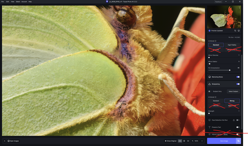

If it were up to me, many models would not exist in the software.
I use prime lenses that have few aberrations, a camera that has little noise even in the dark and almost always focuses, even when I can no longer see anything.
(The Canon R “L” lenses are really cool, and really expensive.)
I am a professional, everything that is red, in the image below, belongs away in my opinion.
Because I don’t have these problems, but the world is not that simple.

Actually, the dialog box should say that they want to see the pictures because they want to know what the problem is.
Correct, the message is too open ended it does not specify incidental inquiry for the image to troubleshoot a specific user issue.
I see it as a broad request for input on training data.
Again - this is a commercial project - TopazLabs is supposed to pay for this.

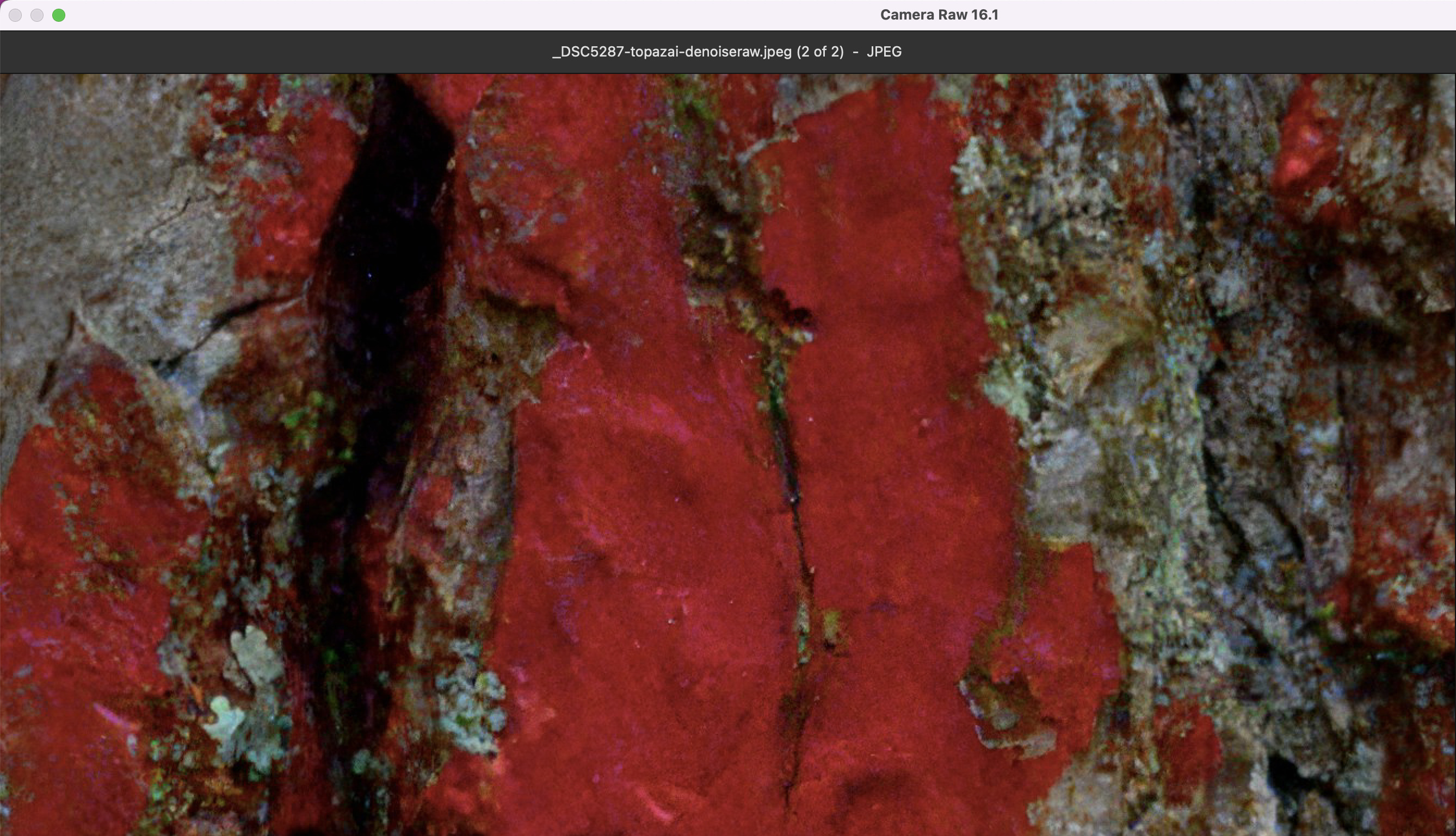

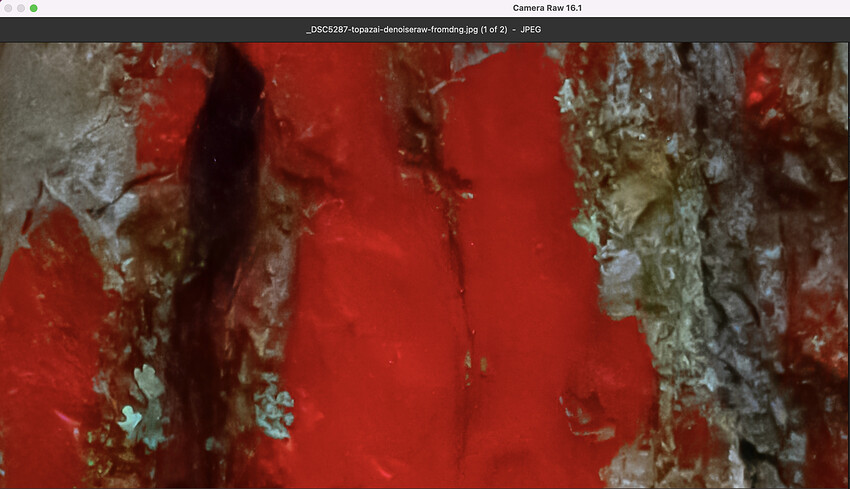

When input image is a raw file, and the only enabled adjustment is Raw Normal (e.g. strength 77, minor deblur 38) there is a discrepancy in the amount of denoising and sharpening, depending on the output:
  1. When saving as JPG, output matches the preview in TPAI.
  2. When saving as DNG: excessive blurring - both luminosity and color. deblurring is not applied
Original NEF raw file:
NEF->TPAI->JPG:
This is a good quality result
NEF->TPAI->DNG->Camera Raw->JPG:
this is significantly inferior to the above
Here is a feature request:
When processing RAW images in TAPI, allow user to adjust white and back levels to retain the full dynamic range of the image.

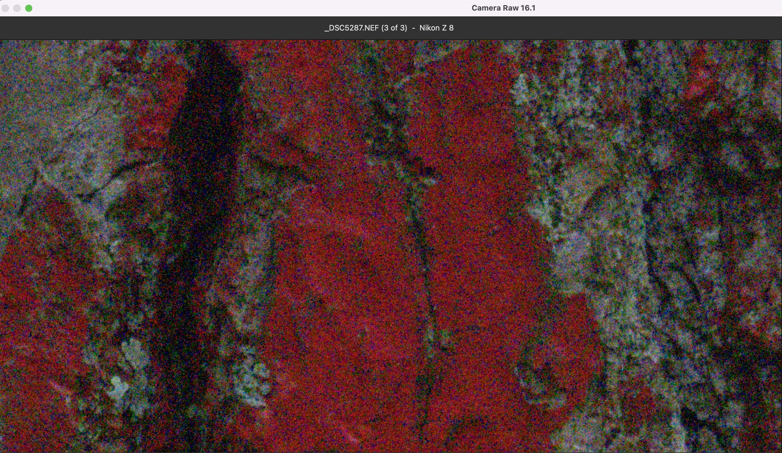

I think the blurring is the standard setting of camera raw.
Check the denoising setting of camera raw (color and luma).
I mostly agree with your red X’d out models.
But I have a mix of lenses. Some “pro” some not. And, mostly zoom (for what I shoot). And, I often make composites & use a mix of my own & others’ stock images. They need normalizing to work together…
Every once in a rare while the Low Res model helps an image I’m working with better than the other models. Even less frequently, the Motion Blur model helps (it mostly ruins what I work with). The Hi Def models do nothing beneficial or detrimental in my tests of them. They take up settings panel real-estate but provide no discernible value add to me (I’d expect photo realistic sharpening that is observable & I mostly don’t see any additional controlled sharpening with or b/wn those 2 models).
Thank you for pointing that, it actually is correct.
This is not an issue, a user error.

I really like using the Hifi model because it enlarges the images but otherwise doesn’t affect them very much.
Ah, that makes sense. But still would be nice if there’d be some controllable sharpening that maintains a photographic appearance.

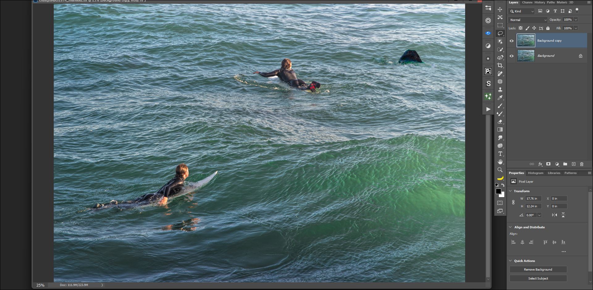

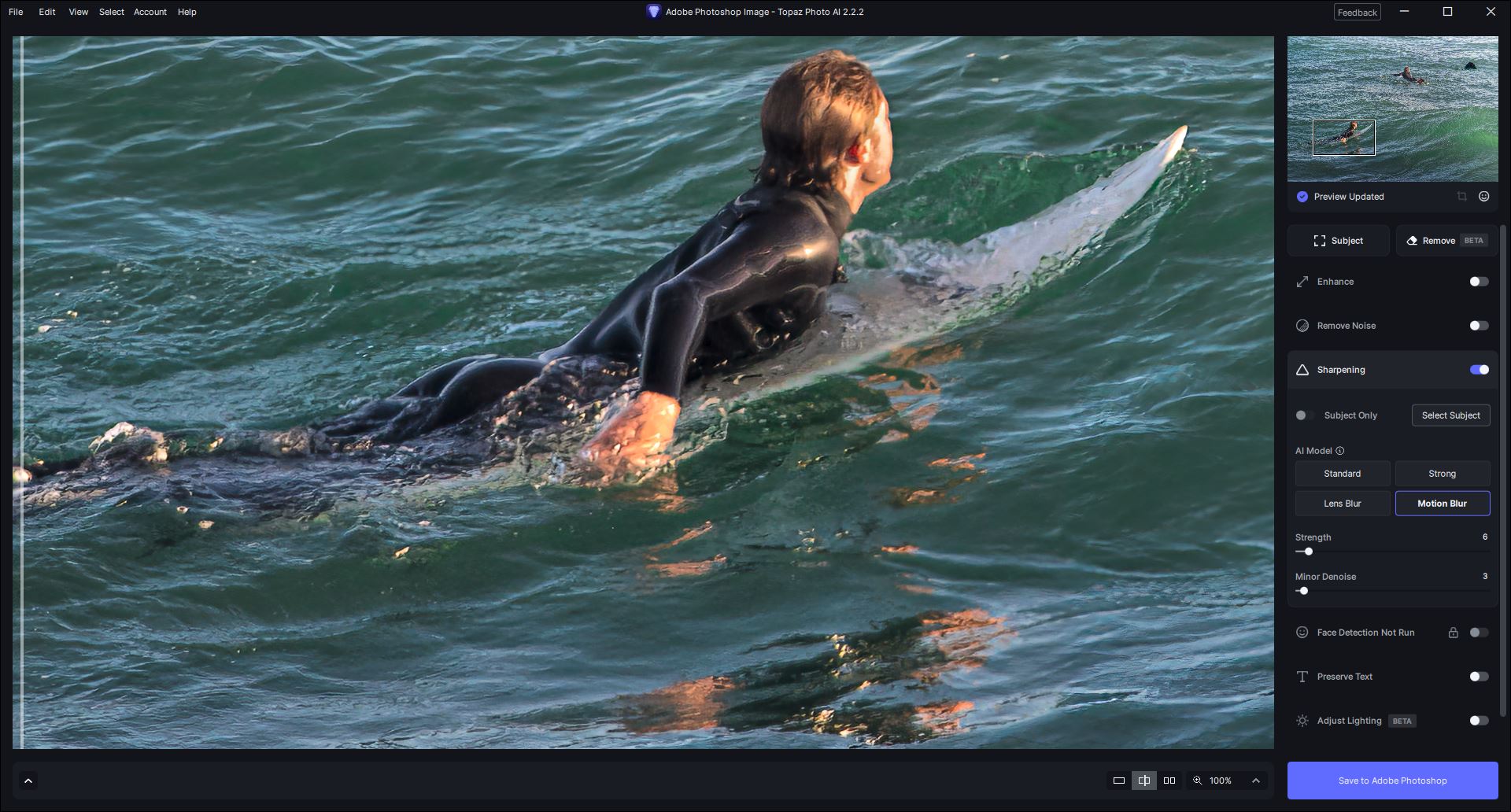

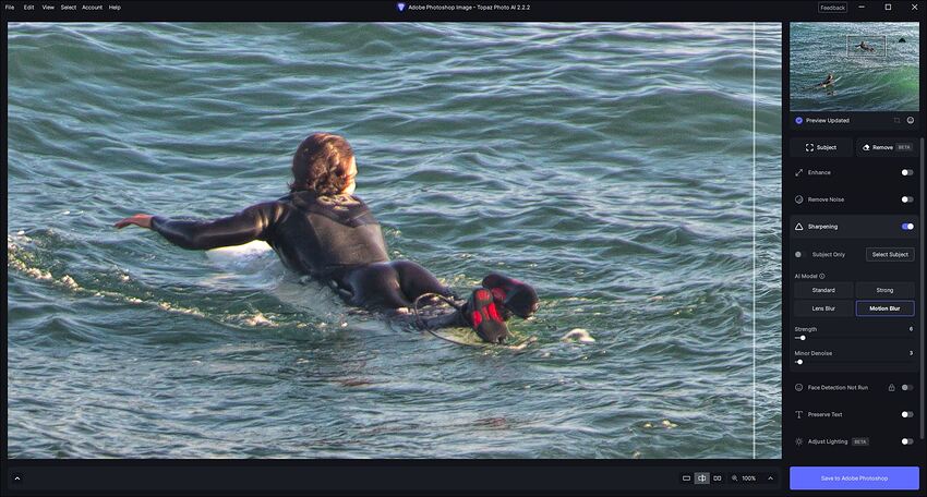

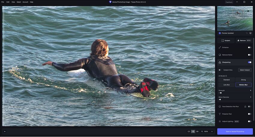

Of all things, I just tried a surfing shot of mine from Santa Cruz, CA, and the best result (to my taste…) was the Motion Blur model (as I said, it comes in handy when it comes in handy! Though not a model that I need/use regularly).
It’s a shot with a lot of water (gentle waving), 2 surfers (going out, so on their bellies vs standing) - there’s water droplets splashing around them and you can see their hair and a “critter” at upper right.
Motion Blur model sharpening crisped the surfers (including their hair) up nicely/positively, crisped the splashes in the waves (again in a way that looked like a faster shutter speed and positively) and (I looked over the whole image zoomed in) I didn’t see [A] Water that looked more like painted strokes than fluid water, [B] Blurred patches - things I most definitely would have seen in older iterations of the product. This is observable progress in the result for this type of subject matter. Back on the Ps 2024 layer (where I launched from and saved back to) the color renditions were the same when I turned the eye icon off/on and I didn’t see any notable pixel hops (but could see the subtle (still photographic) sharpening impacts.

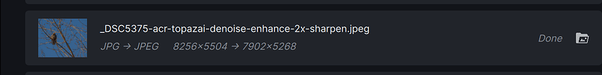

The output file size is reported incorrectly on the Save dialog:
2x enlargement is larger than the original size, here it is shown as smaller.
