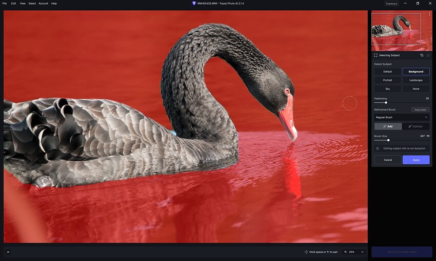

No idea why one would want to mask the sky for sharpening but its not good at it anyway
Background is better if the subject is clear, but again why? Without layers we can’t use different levels of sharpening for subject and background. Seems I’d have to run it twice, once for the subject and once for the background then blend layers in Affinity Photo? I still want a version of landscape that doesn’t select water.

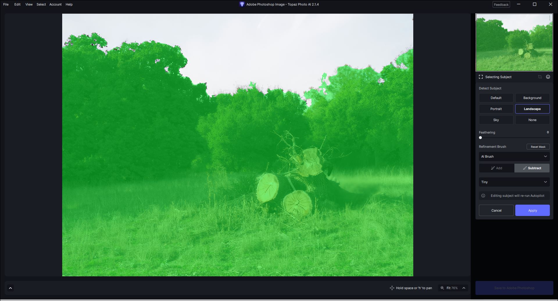

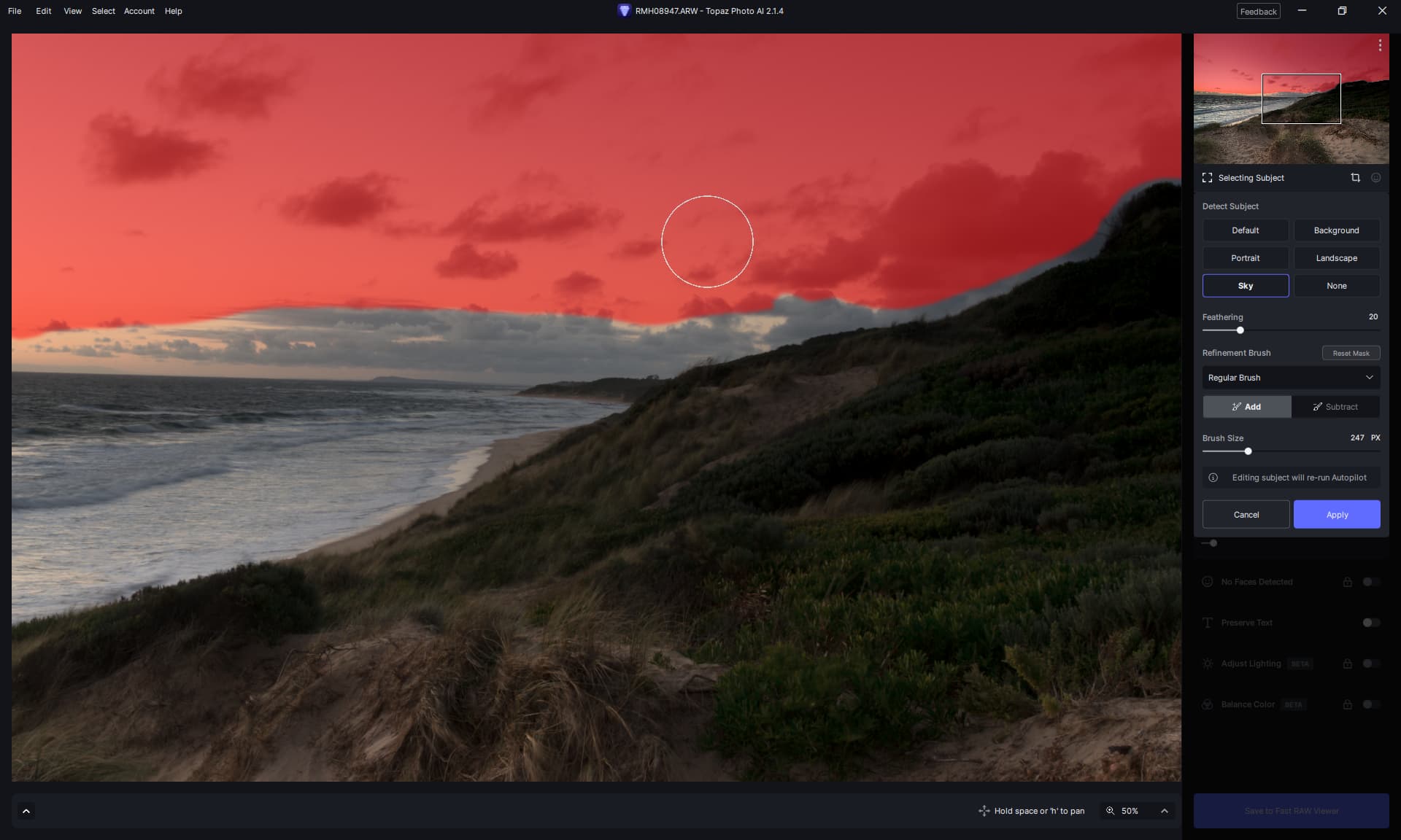

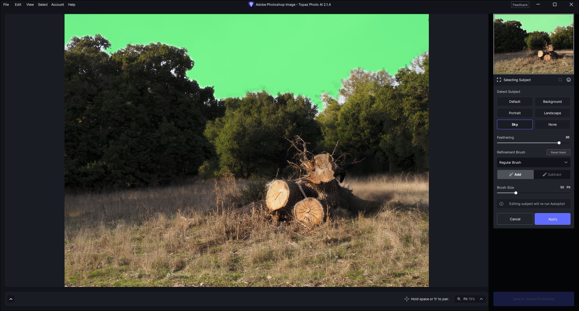

  • I switched to the Filters Menu PAI. It launched. Using the same image I tried the Detect Sky option. Again, I’m really puzzled re: it’s function. Plus, it doesn’t select accurately. And (if it did) there’s no way to invert it to get a clean landscape selection. Snip below. So, I tried the inverse to see how selecting the Landscape would work. Same issues as with selecting the sky. It misses any areas of sky embedded within the foliage. And there is no masking brush that allows me to cleanly segregate the sky and the foliage - the AI Brush misses edges of branches and treetops (just like others have reported happens with hair and fur). Snip below. I hate to be redundant in my questions, but what is the purpose of the sky selection option? I could see something like that (if it masked/selected accurately) in the Topaz Studio and prior days for making selective artistic effects. How does it play in PAI?

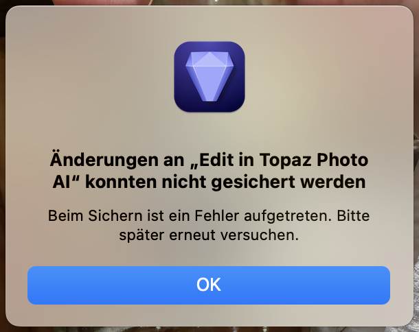

But the issue with saving images in portrait orientation back to Apple Photos is still there.
Bildschirmfoto 2023-12-08 um 09.38.53
Any update about when this will finally be fixed?

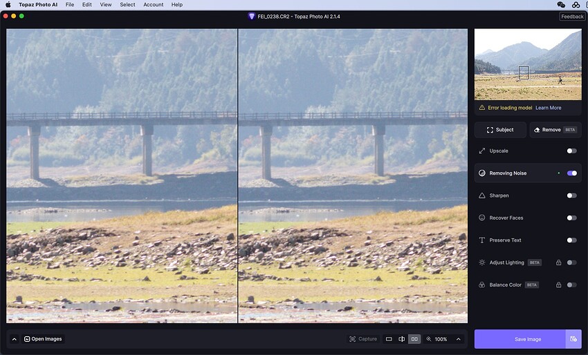

I updated successfully. When I tried to process the photo, the missing models were downloaded. then the program froze. I closed it forcibly. Now it does not even start. Mac Intel, Sonoma 14.1.2. There were the same problems with the previous version, I reinstalled it with completely uninstalling, but it didn’t help, then by some miracle everything worked next day. But what should I do now? Now it does not even start again.

Since I did the latest lot of updates to my Topaz photo AI, it seems that there is no difference between the ‘before’ and ‘after’ preview images, particularly when it selects to do ‘sharpen’. So I am not sure if it is still actually working.
It was not doing this before the updates, when I could see a clear difference between the original image and the update preview image.
Can you please advise what is happening?
thanks
Roland
Every once in a while that happens for me too.
It usually fixes itself (knock on wood) if I reboot my PC when that happens after an install.
If that fails, the backup plan is I reinstall.
:crossed_fingers:t3:
Thanks. I’ll try rebooting and see how I go.
So neither rebooting my PC nor reinstalling Topaz seems to have made any difference. Not sure what to do next but will keep trying. Funny that I have been using it without any issues for almost a year now, but just had this experience with the latest update…
You could uninstall it and reinstall an earlier version.
You beat me to it.
That may be the only option for this release on your system is to roll back.
But, contact support via the main website too (vs just in this user forum ) & provide them with your system specs so the tech team knows to diagnose possible issues in that serup.
