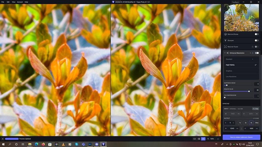

I love the final rendering quality with the scaling on plant pictures
The rendering is very pretty
