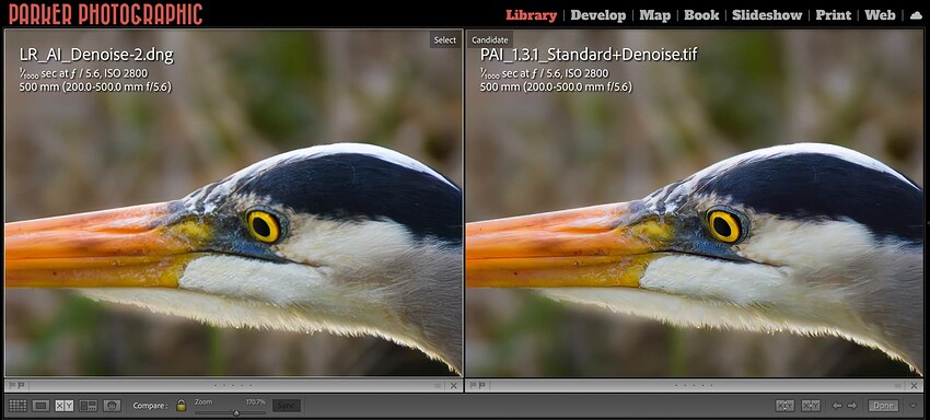

Autopilot seems to be hit or miss. This image was shot at ISO 2800 and definitely needs to be denoised. Autopilot did not “auto” activate noise reduction.
The image on the left was rendered with LR AI Denoise for comparison. I prefer PAI at this time due to its superior sharpening. However, I suspect LR will get an AI sharpener in a future release.
How is Autopilot trained to “see” noise? Is it possible for Autopilot to read the Metadata of a file and then apply the appropriate amount of Denoise?
Or, as a new feature, it would be nice to set up PAI to reduce “x” amount of noise for ISO “X.” I have Lightroom set up to do this with the Legacy noise reduction. If built into PAI, it would make batch processing a breeze.
honestly, I prefer your left image. There is more detail nothing is lost with Lightroom’s Ai denoise. On the other hand, I like the sharpness of the one on the right.

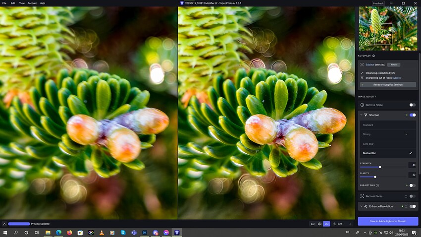

The strong model is really interesting on this picture. I also compared it with the motion blur which doesn’t look as good. But can do better on other type of image.
Strong
motion blur
Personally, for this image, I will keep strong

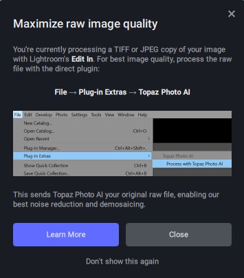

Thanks for your post, harald. Until I find a better solution, I will indeed right-click on the image and select Edit in>Topaz Photo AI. I prefer to use the File>Plug-In Extras>Process with Topaz Photo AI technique, though, because this is what Topaz recommends, as per this message:

The strange thing is that the File>Plug-In Extras>Process with Topaz Photo AI technique was working just fine for me up until a few days ago.

Of course, I adjusted the slider according to the effect I wanted. There are images where the motion blur works well and on others it is the strong. That’s why it’s good to have both :wink:.
You’re welcome, but although there is this message, the bug in question is known. And in the update logs, the Topaz team recommends right-clicking on the image and sending it to AI photo following the image extension formats in the dialog box that appears.
