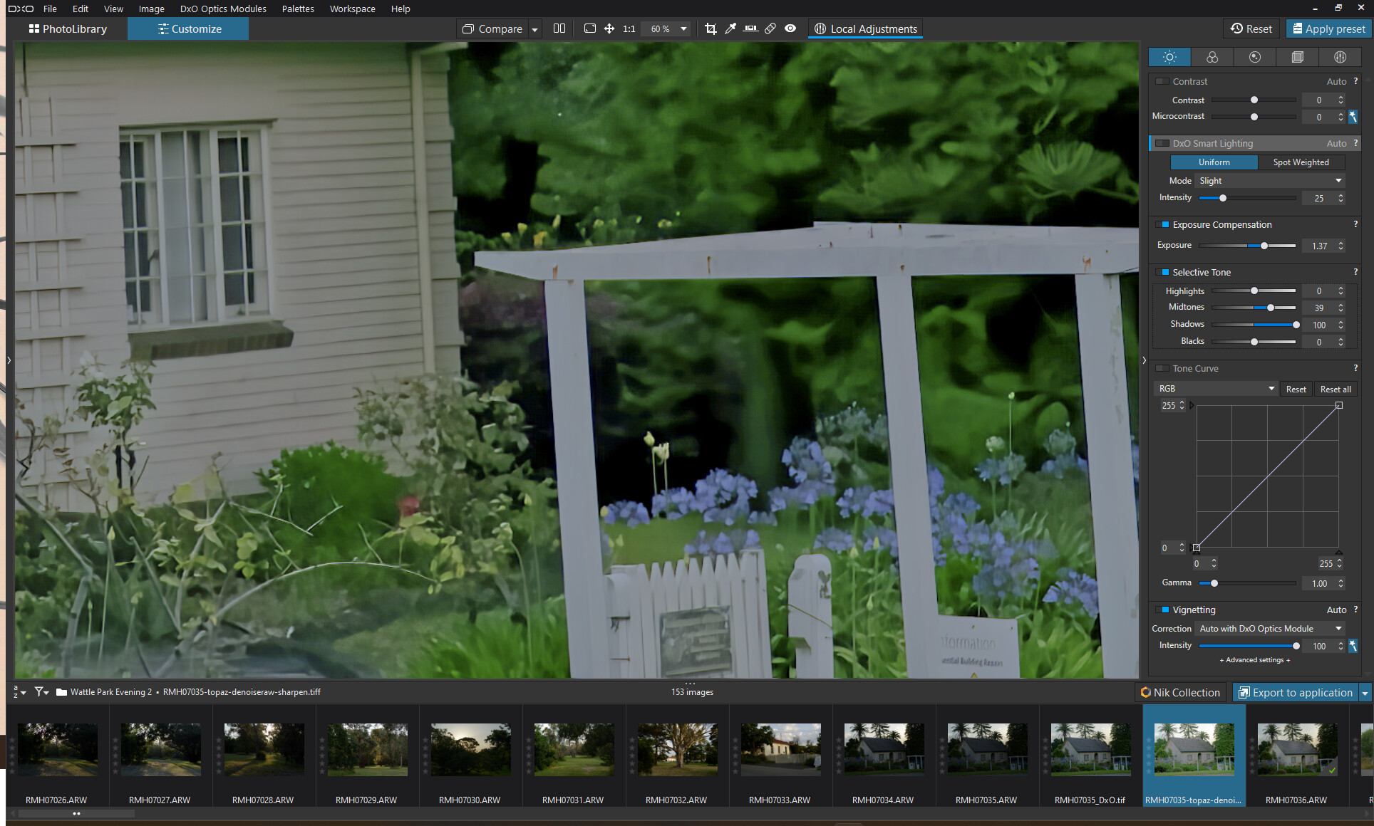

DxO PureRaw, which uses it’s own AI algos, handles deep shadows better. Not as well as LR, but leagues above PAI.
I’ve just started using Deep Prime in PhotoLab and it does this very well. Not exactly transparent as to how it does it but it does. You guys have a problem.
