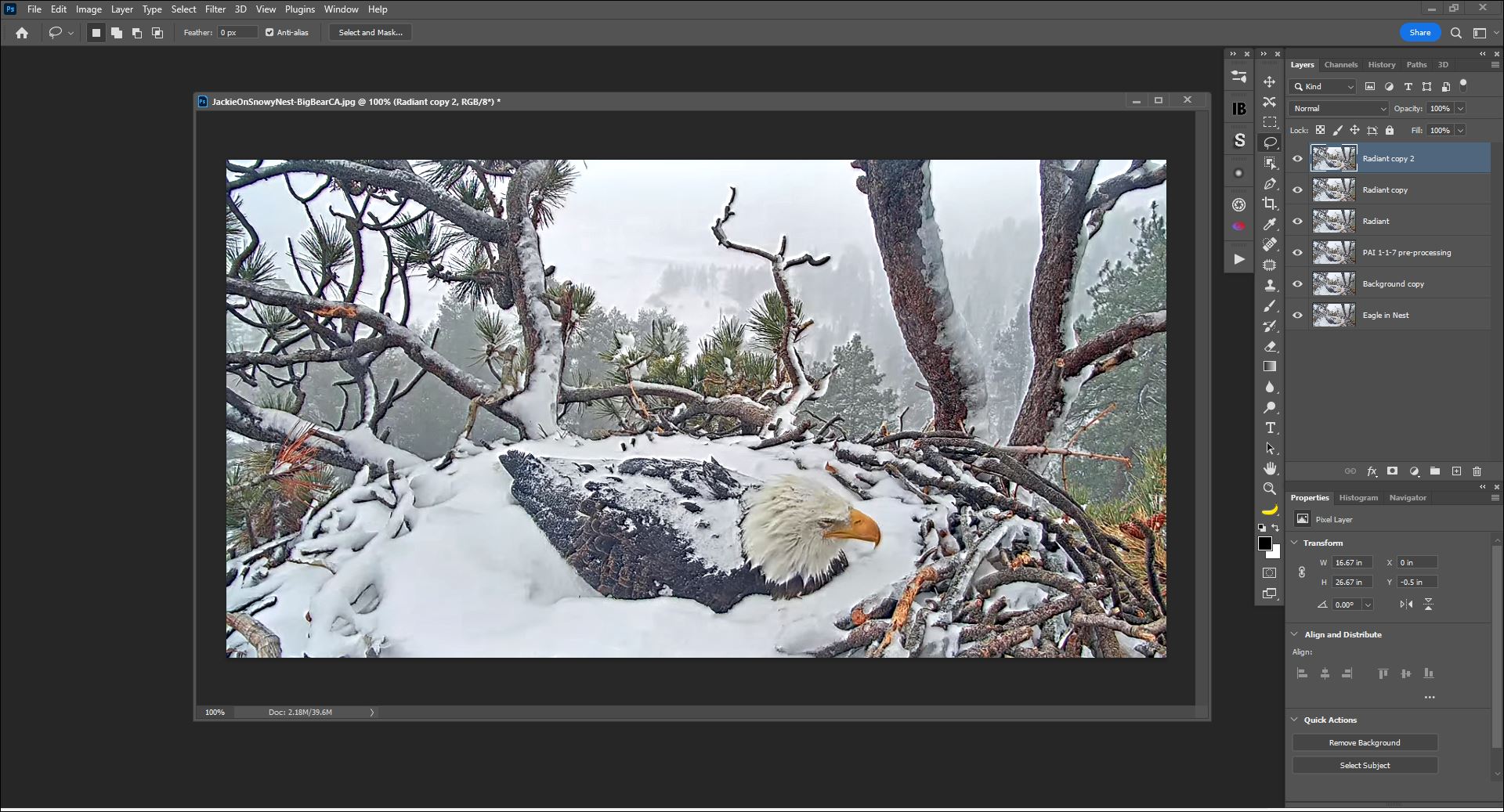

Just ran this (.jpg) image - using PAI Plugin as pre-processor in Ps 2023.
Unlike previous few images this one exhibited a significant (enough) pixel hop back on the Ps layer after I applied from the PAI plugin.
Interestingly, I did more manual sharpening in the PAI UI with this image.
