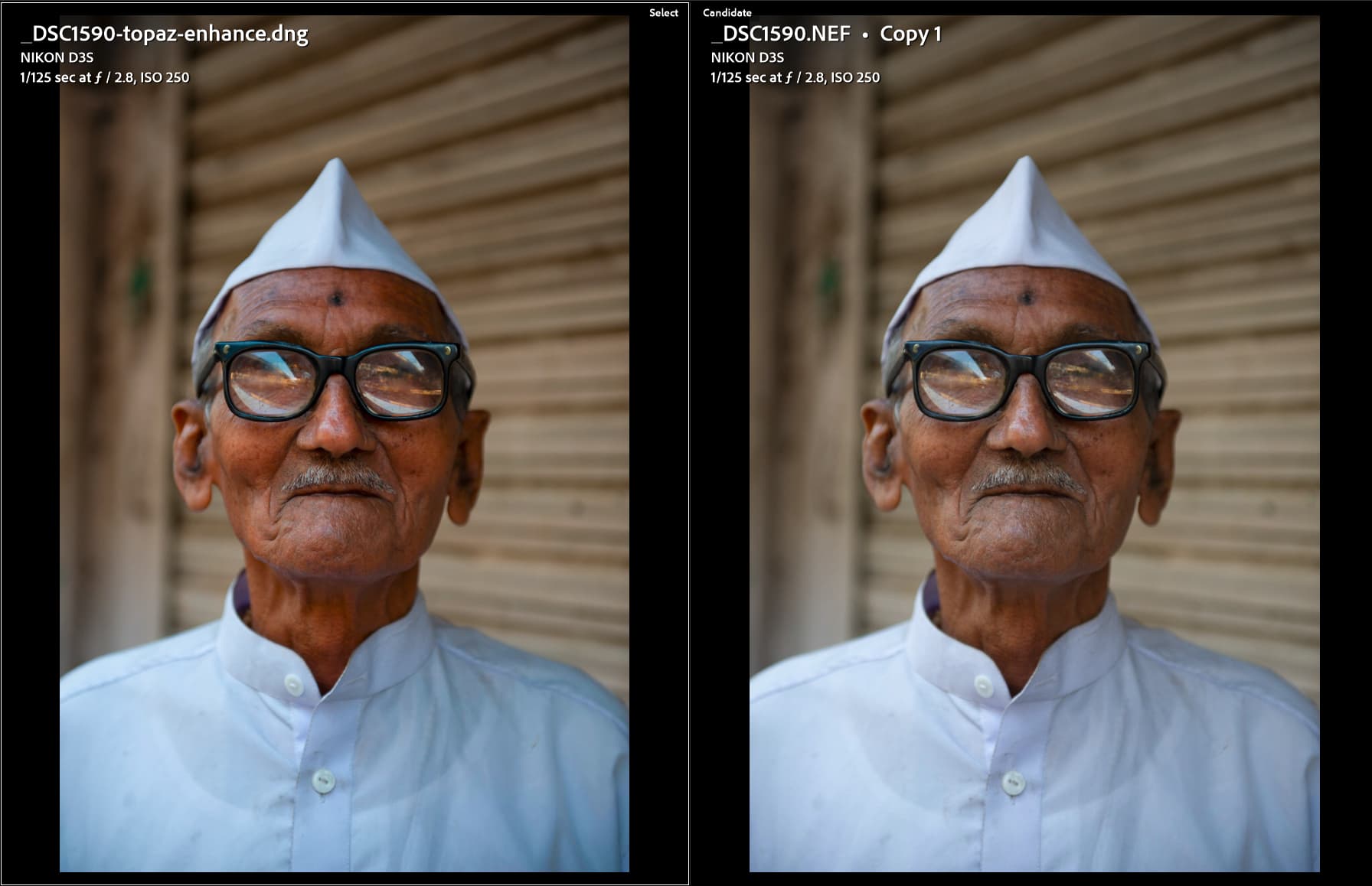

With older camera models like a Nikon D3s, if processing raw directly colors still come out wrong, too saturated:

First version to give me crashes !
Easy to fix in Lightroom, PS or any software.
But that’s not the point, for example DXO software gives perfect colors. Obviously I know I can fix the color or even the tonal curve, but the software should be able to output a file with proper color fidelity like it does with other cameras.
same problem here ![]()

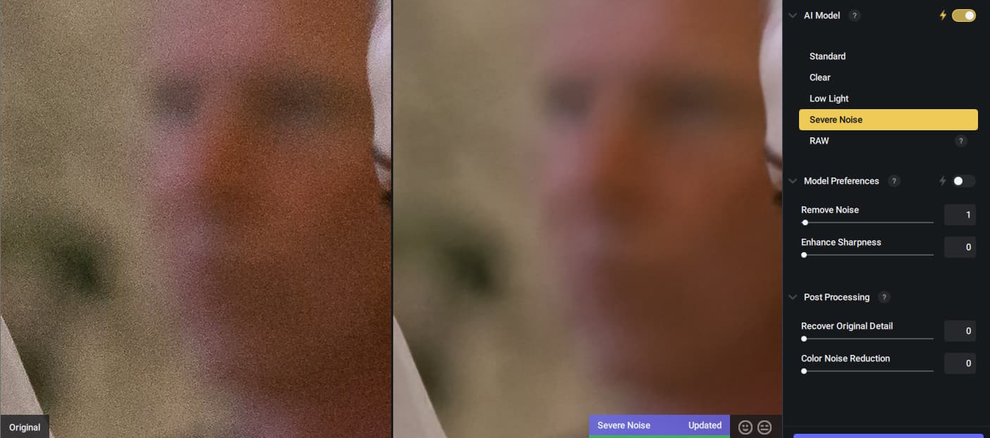

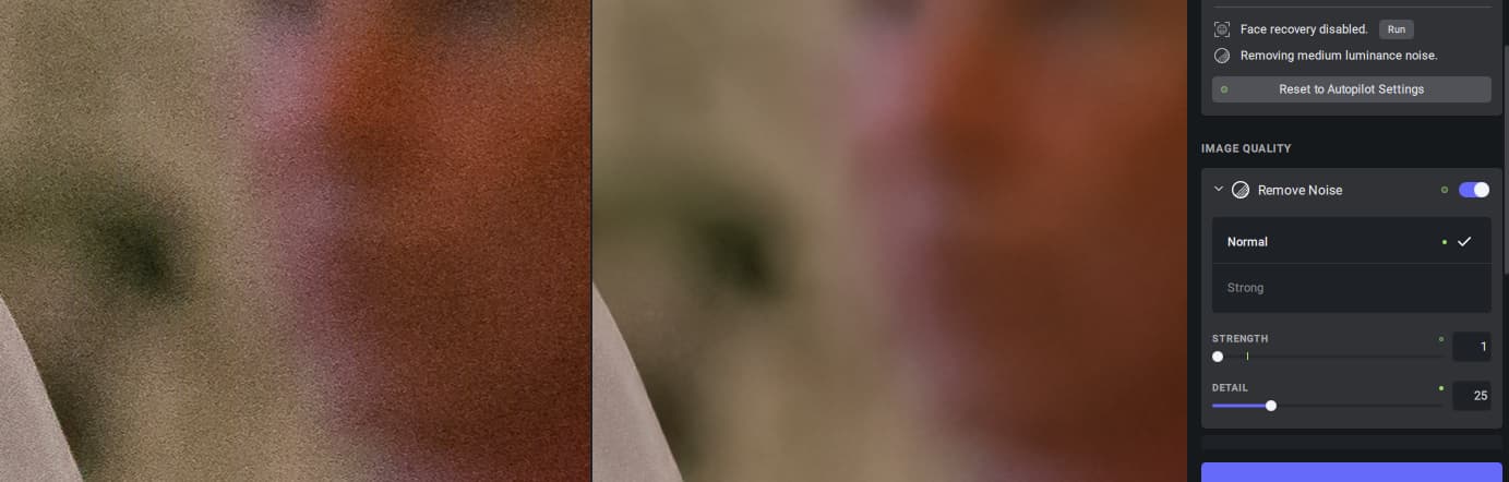

Nice to have more sliders on Remove Noise, however, we still cannot (pre-)select the AI model for remove noise filter.
So, for my test picture, Autopilot chooses “medium luminance noise” and still the slider “Strength” does not have any visual effect. The noise is just heavily removed, no matter if Strength is 1 or 100.
In DeNoise AI I get the same result for AI model “Severe Noise”, also the Slider “Remove Noise” has no visible difference between 1 and 100.
However, in DeNoise AI there is an additional slider “Recover Original Detail”, which allows me to give the picture back some original “crispiness”.
Please give us all the sliders from DeNoise AI etc. into Photo AI for better control of the picture output.

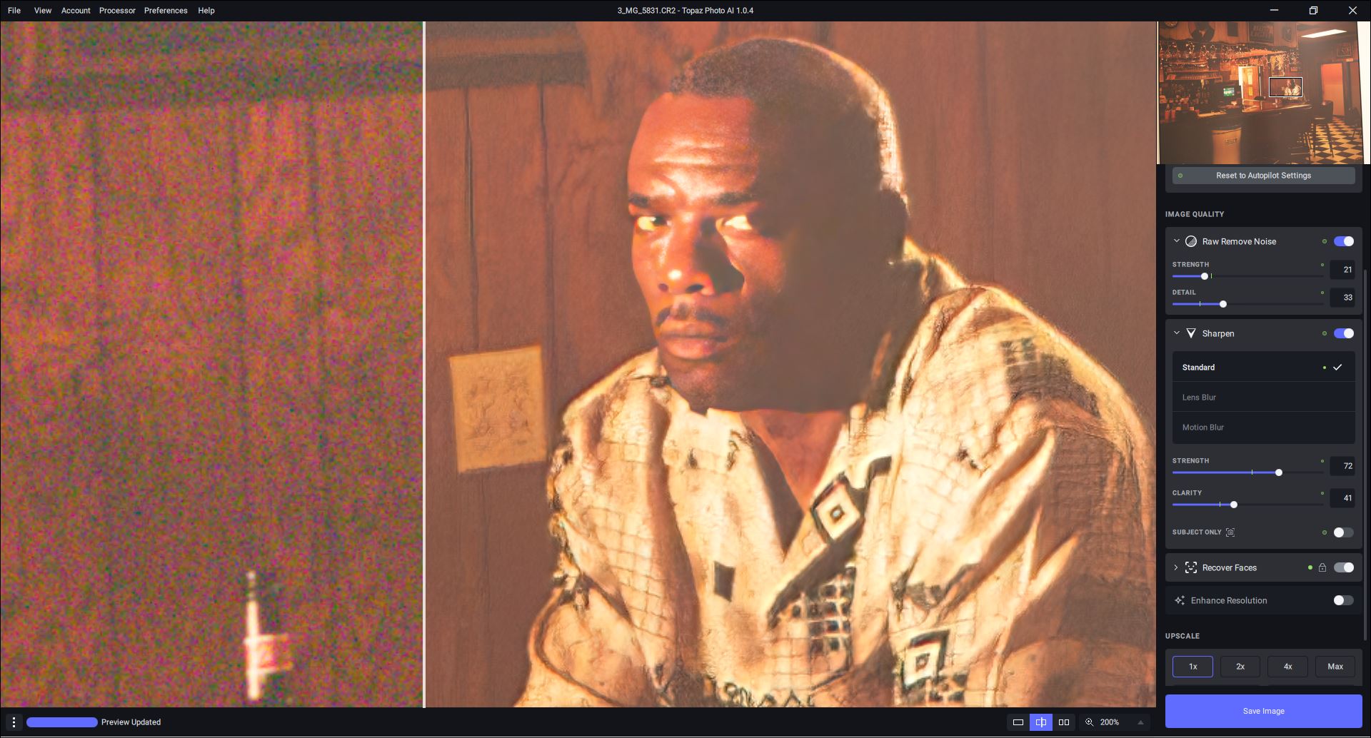

Win 11 Pro desktop PC. Processor = Auto. Standalone vers.
Able to launch Canon CR2 raw image into the 1.0.4 UI and process.
Subject Detected = the man and most (but not all) of the bar area he’s sitting at. Would be nice to just be able to select him or only parts of the bar area.
Face Detected (after I manually activated it b/c I rarely capture faces) = for the man
Denoising - removed significant color noise. I’ll have to take pre-processed image into Ps to try to refine the sharpening & contrast on him. Will do later to see how the PAI-processed image behaves in Ps.
Bug/Issue Remains (I don’t see it addressed as a fix in .4 Changelog - assume crashes were crit. priority): After closing a processed image (Close Image in File Menu), when I open the next image to process it the already closed image appears again in the workspace temporarily …
Snip attached below. Denoise & Sharpen panel settings expanded to show where my sliders were positioned. Enhance Resolution didn’t help. I turned it on then off again.

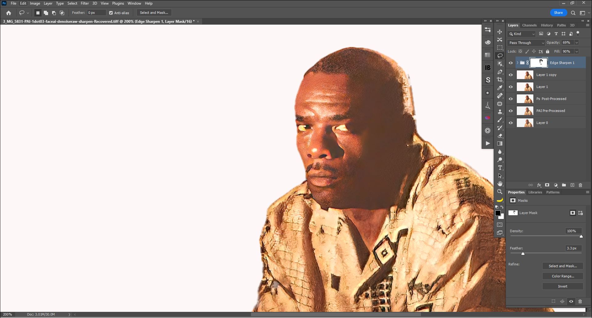

** B/wn 1.0.3 & 1.0.4 I’ve now tried various ORF, ARW, CR2 and DNG images. All launched and were processable/saveable singly. I don’t typically batch process. So I leave the testing of that to ppl who have ‘real-life’ needs they can articulate vs me doing a pseudo batch.
** Was able to Select part of PAI-processed image & do more processing okay on it in Ps 2022 (image is stable for other host processing - color noise doesn’t return - has enough good shadow noise to look like photograph …). I might try to crop in Ps and then try PAI upsizing as another test:
