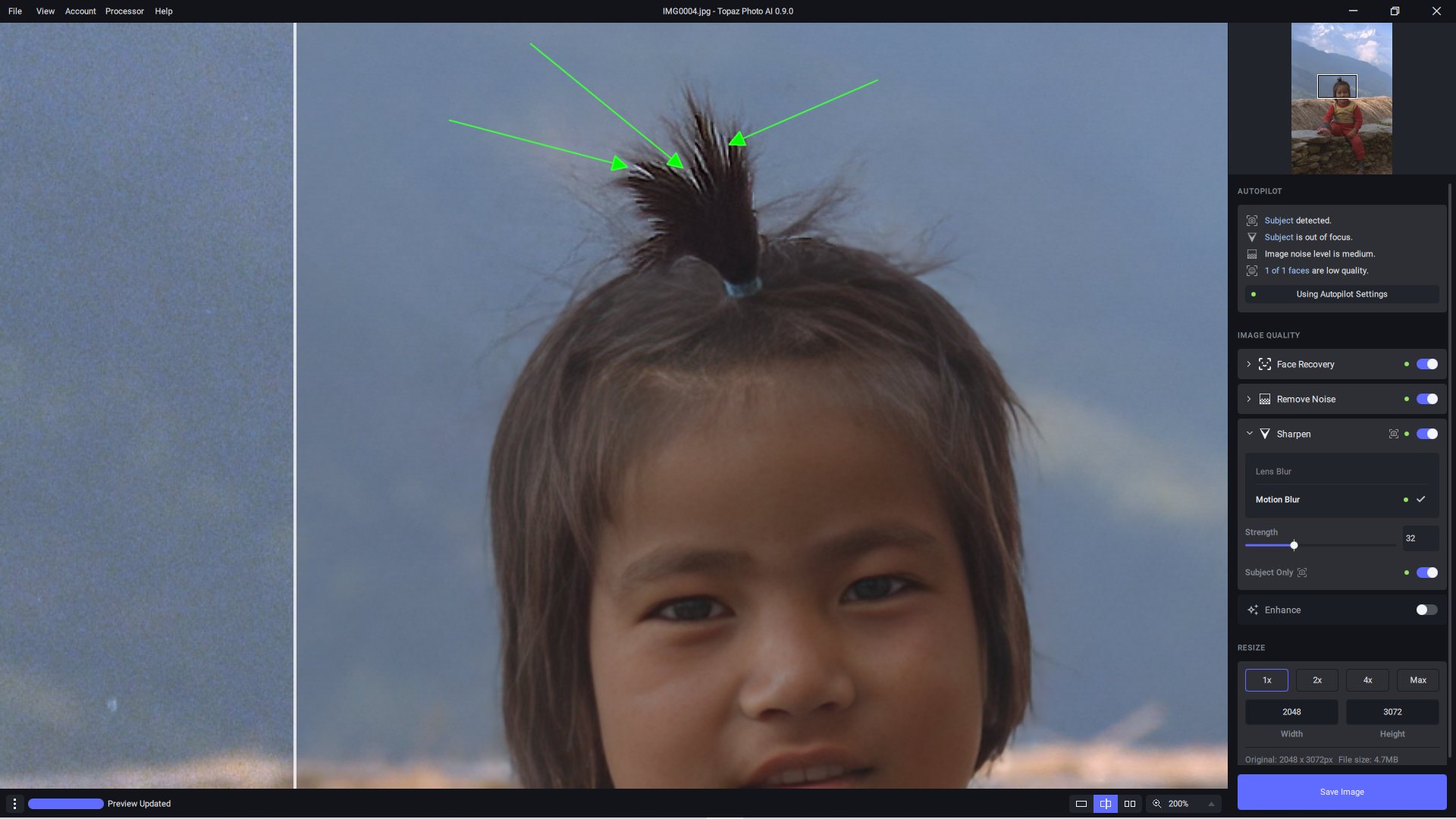

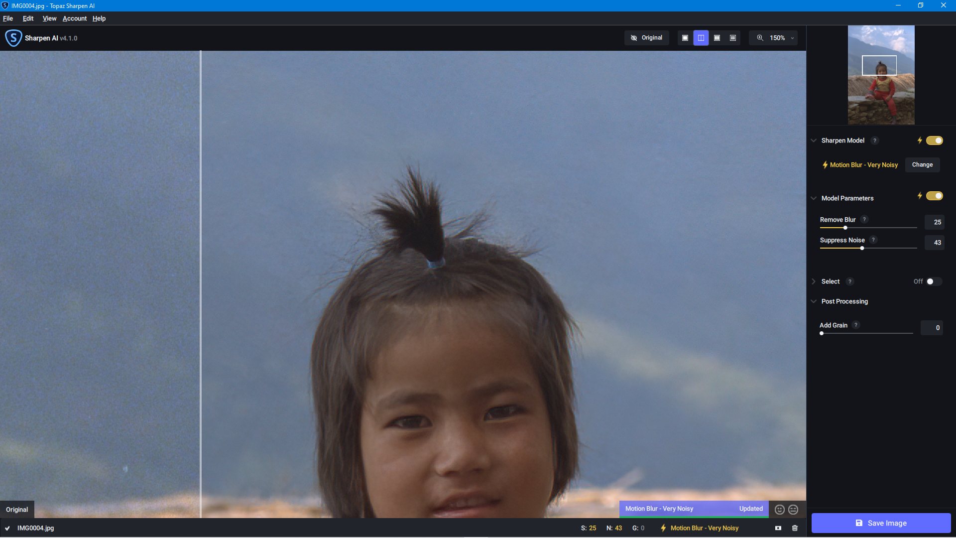

Still don’t understand why sharpening is so bad in PAI while you proved to do it right in SAI? Why don’t you use the same engines as the standalone programs and melt them into 1 single program?
Here you can compare what autopilot did, what sharpening alone did over the whole picture without noise reduction and what SAI made of it. I prefer SAI!

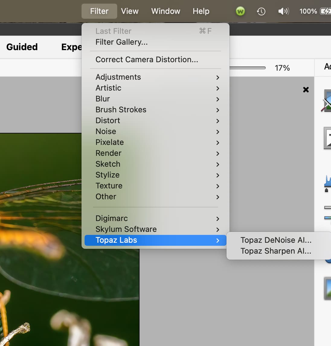

I am still unable to find a plug-in for Photo AI in Photoshop Elements for Mac. I only see plug-ins for Sharpen and Denoise. The menu bar does not give me an option to install the plug-ins and I can find no way to do so manually. Wasn’t this something “corrected” in version 0.7.2??
See screenshot.

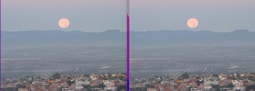

Note how the result with remove noise applied (on the left) creates a halo around the moon and the horizon. The version without is much better in my view. I note too that there are more detailed suffixes than there were. But shouldn’t “enhance” be “resize”?
